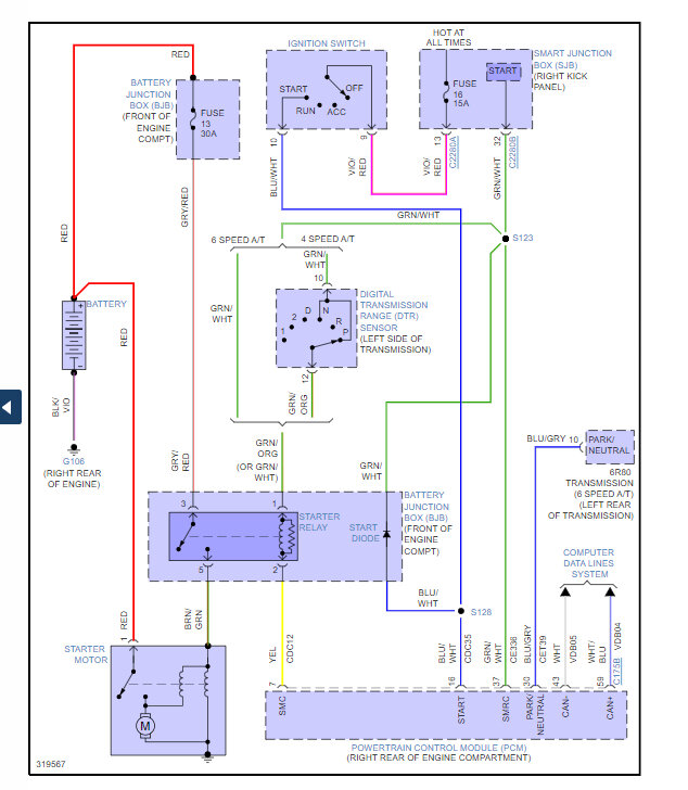

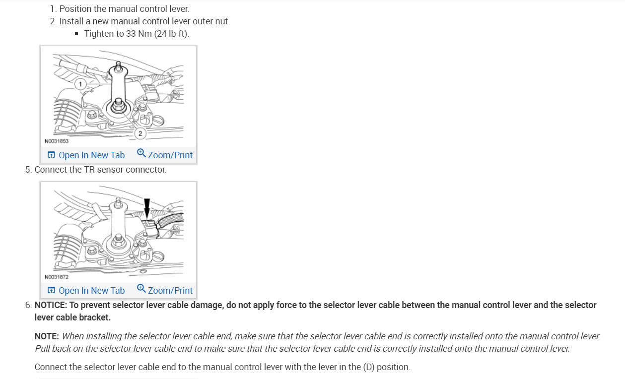

The truck listed above is a Lariat. I bought a used transmission (VIN matching according to supplier) and had it installed by a family friend.
Once I insert the key, I get power throughout the truck and the dash moves, but it will not turn over. Nor will the floor shifter move out of park.
I am able to manually shift the linkage from underneath the vehicle, and even bump start the truck from down there as well.
Oct 4, 2022 at 1:58 AM
  • 55,859 POSTS

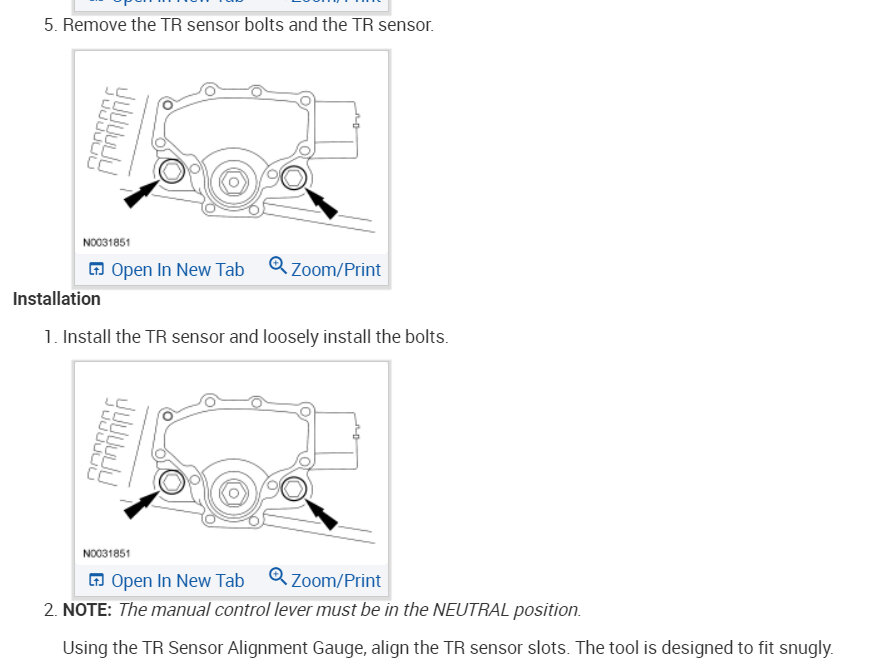

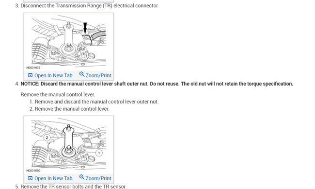

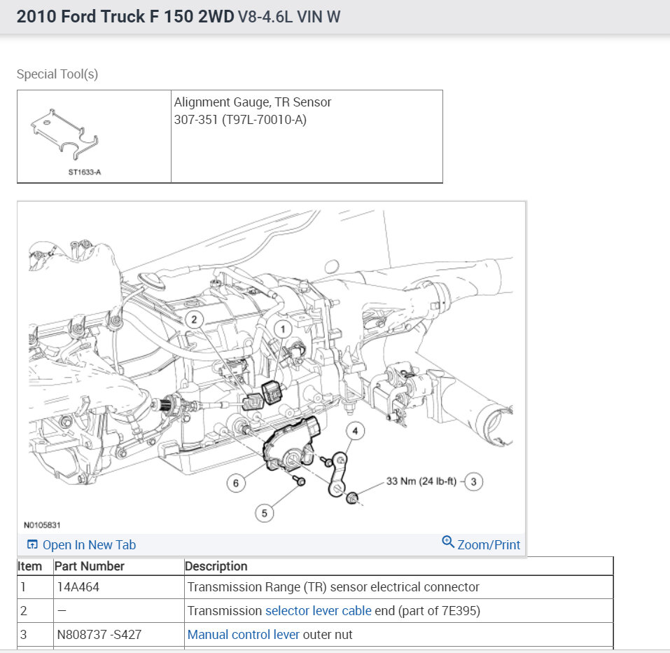

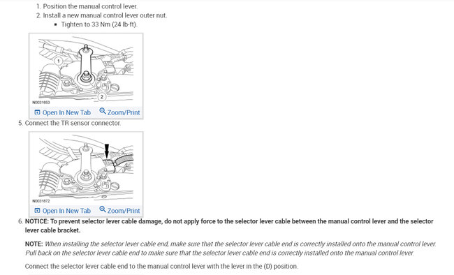

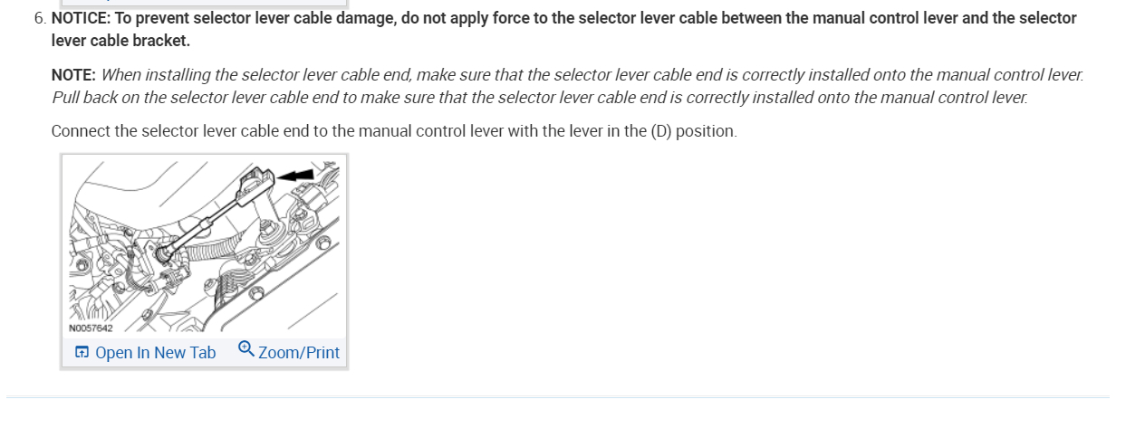

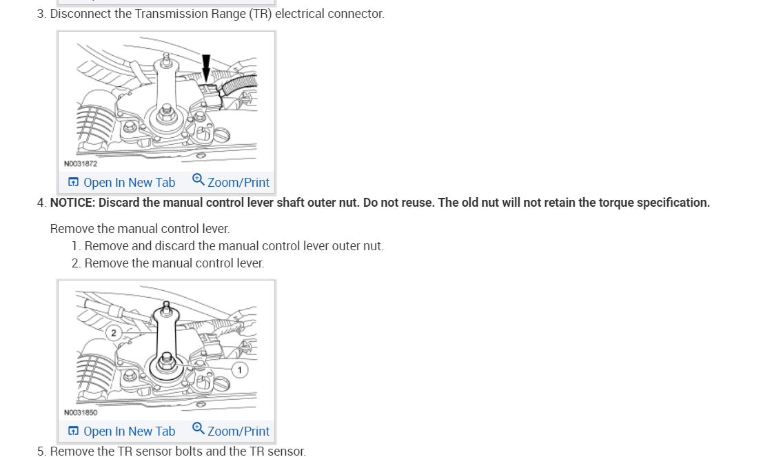

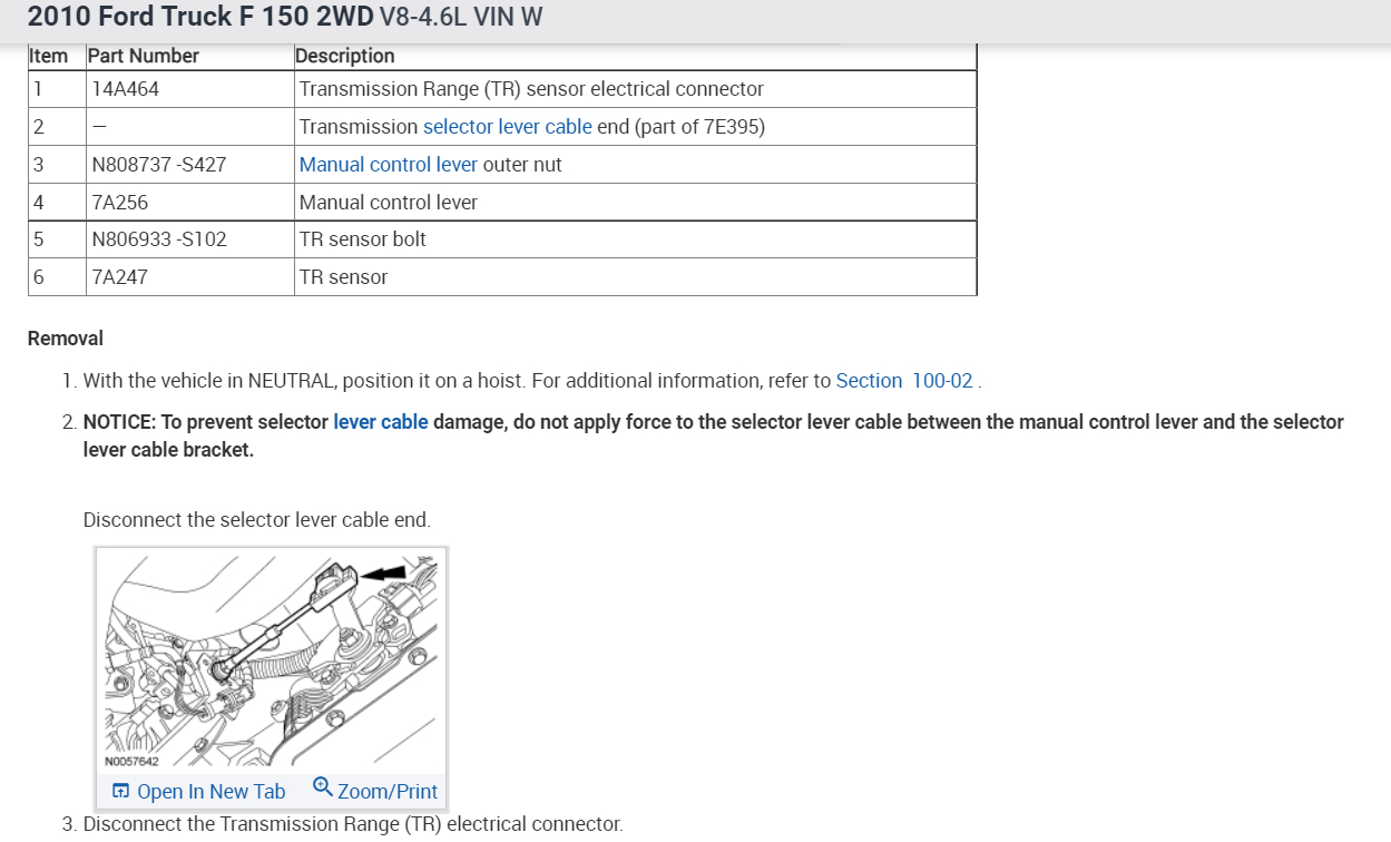

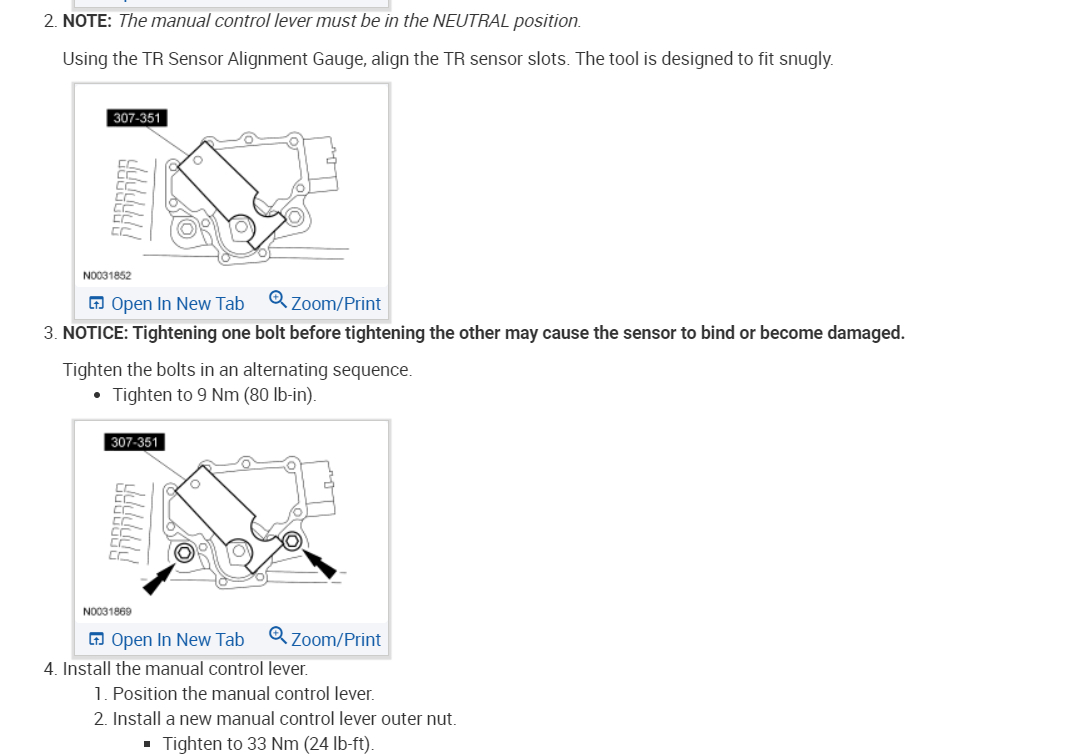

It sounds like the gear range sensor is not plugged in completely or the sensor is bad. here is the location of the sensor so you can check it out also I have included the starter wiring diagrams so you can see how the system works. Make sure you check all fuses as well.
Check out the images (below). Let us know what happens and please upload pictures or videos of the problem.

The shop diagnosis came back as a faulty range sensor. It is constantly reading the truck is in third gear, causing the no start. From my understanding it is internal. The vehicle is being taken to a transmission shop.
Oct 4, 2022 at 8:07 AM
  • 55,859 POSTS
Yep, it the gear range sensor is not internal. Check out the first image on the post above it shows the sensor.
