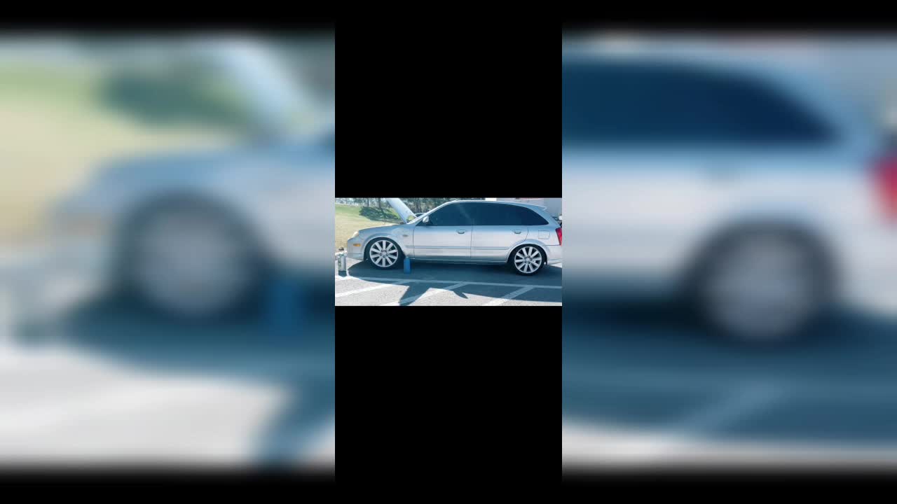

I've been having multiple issues with the car. The door actuators to all doors work when they want to, they just make a buzzing sound. depending if the cars ignition is on the start or off position some will work. The A/C stopped working and appears to have a leak and when i had recharged it the car overheats. I'm assuming because the fans are not turning on either...the car belts squeal loud when i start the engine at times not all the time but then as I drive, I push on the gas, and it gets louder and then just stops squealing.
the car gives a rotten egg smell and a rattling sound at times The overheating happens randomly and sometimes the temperature gauge will read half way but when i turn off the car and get out I'll hear a bubbling sound which i found comes from the air bubble being pushed into the reservoir when i connect my scan tool to the ob2 port will connect and turn on but then when i move the scanner it turns off not all the time, but i do get it to read the codes by holding it still while it read but if i move it turns off but I'm not sure if it's giving me the right codes all the time. Because it sometimes goes away and then later comes back. now it says it reads no codes but maybe because i think my kid erased the codes by mistake. the codes before were p0660 something about a turbine speed sensor and the other. I'm not sure but it said lean mixture on bank one or something like that. i want to say p0170 would have to double check but i know it was something about the fuel air mixture any. It started when i was driving one day and the car just began to overheat out of nowhere, I let it cool down topped off with water later bought coolant. While driving it began to overheat and then turn off on me i found that it was a tensioner that fell. Off and when I replaced.it everything began to function properly but later i started noticing coolant on the ground but couldn't find the leak it started leaking inside the passenger floor thinking it was the heater core but the heater was still giving hot air, i reverse flushed the core but only clean water came out the other side no broken up dirt nothing Soni but everything back but I'm afraid i may have clogged the core because it began to overheat and when i turned the heater on to help. The engine it was fresh not cold but a low temp air coming out later it started working again because it would not over heat confused about the water on the passenger floor, it had an also been raining a lot thinking maybe the drains are plugged I found what appeared to be the drain for when it rains and when i stick a pipe cleaner in there nothing either came out or any dirt or debris on the pipe it stopped leaking in the floor and it stopped leaking outside when i bought a coolant sealer. Still confused about what cause the water on the floor. i was told it could have been my A/C that leaked water to my floor and since my A/C stopped working i gave up on that everything was fine until i tried finding the leak on the A/C and the car overheated. i stopped left it alone let it cool down and continued to use the car normally. several days later on my way to work the car starts making that rattling sound halfway to my job the car seems to lose power. i look at the gauges everything seems fine but i make my way to the shoulder because once I let off the gas and attempted to accelerate again it would lag big time and the rattle sound would get louder. i looked at the gauge and then the car temperature move up quickly, so i began to pull over and turn on the heater at the same time. i pulled over no hot air came out so i turned it off thinking that would make it work harder, I opened the hood to allow it to vent and i figured to turn on the heaters anyway so i did. it cooled down to about halfway when i attempted to start but it wouldn't it just made a sound that remind me of toy cars the ones. That you have to with your hand and arm rev up first for. a little then just out it down let go and watch it take off that's how it sounds when i start it. i was told maybe it's the head gasket. So, to check i removed the ignition coils struggled on C1 the rubber boot seemed a bit worm out but i found no water in the well on C2. i struggled to remove the coil pack and unfortunately pulled to hard i broke half in there but i was able to pull the rest out and the bottom was melted the ceramic or plastic part. i took off the spark plug found no water on the plug either but i stopped there because i didn't want to break the other coil pack on c4 which also I'm struggling to get out. i know it's a lot, but I'm hoping you help.

There are many different things I am questioning after reading your post. The idea that you saw air bubbles from the overflow, lost heat, and the sound you described sounds like a few different possibilities.
The idea you saw and heard the bubbles when the engine wasn't overheating leads me to believe you do in fact have a bad head gasket. It sounds as though compressed air was entering the cooling system. Next, the loss of heat could be low coolant or air in the system.
Next, the way you described the rattle and smell could indicate the catalytic converter internally is loose. That could result in partial plugging at times causing internal damage to the valves. Here is a link that explains common symptoms related to a faulty catalytic converter:
What I really need you to do is record it cranking and running so I can hear it. Also, I do recommend testing for a head gasket issue. Here is a link showing how to check. Remember, a bad head gasket doesn't always cause coolant to enter the combustion chamber.
The idea that it sounds the way you described sounds like a compression issue, that's why I'm asking you to record it for me. If you want, here is a link that explains how to test compression:
Let me know. Also, the code P0170 doesn't exist for this vehicle. Interestingly, there is a P0171 and P0172, both of which deal with fuel mixture. If you could confirm which one it is, that may help.

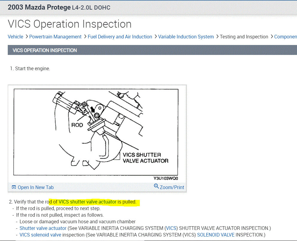

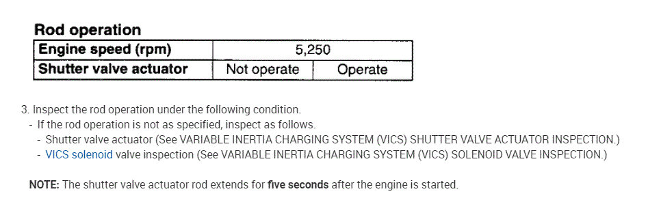

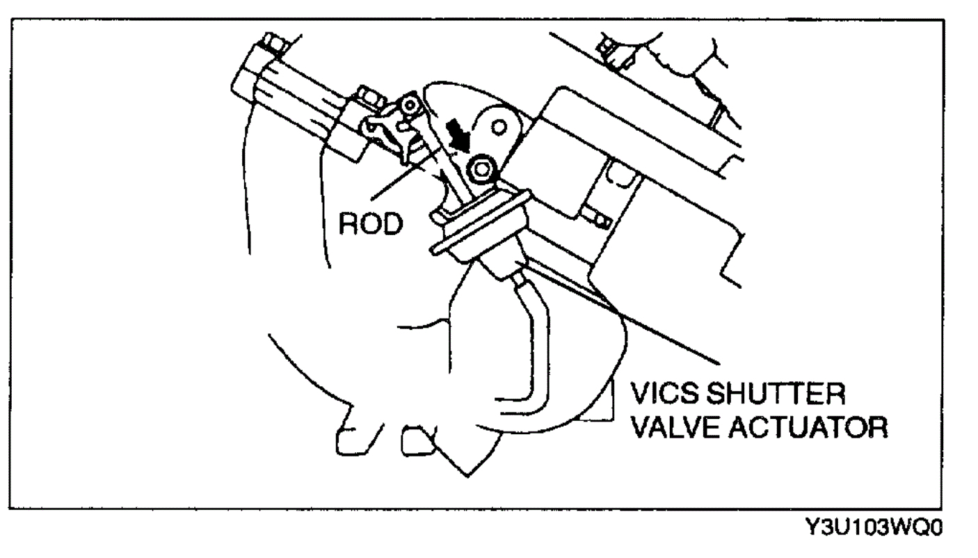

The P660 isn't a turbine sensor. It's related to the Variable Inertia Charging System (VICS), a variant of the variable-length intake manifold. There is a shutter valve that controls the VICS via engine vacuum. See pic below.

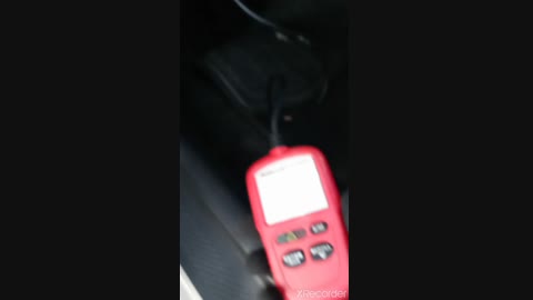

Hello, thank you for helping me i really do appreciate any and all. okay, so, I'm sorry for the late reply and i verified the codes they are p0660 and p0171 and i apologize beforehand for the quality and length of the video i was trying to get everything. I hope it helps.

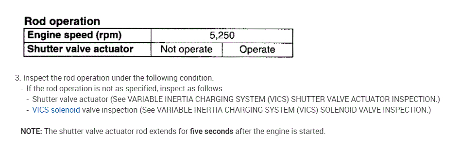

The 660 is specific to the VICS which I mentioned above. The 171 indicates a lean fuel mixture. The first thing to check is the vacuum supply to the VICS. If the hose is good and provides an engine vacuum when the engine is running, get a vacuum tester (most parts stores will lend you one) and place a vacuum on the VICS shutter valve as pictured above. It should hold a vacuum.
If you have a vacuum issue with that component, it will cause a lean fuel mixture and set both codes.
I attached the diagnostics for testing below.

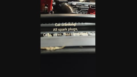

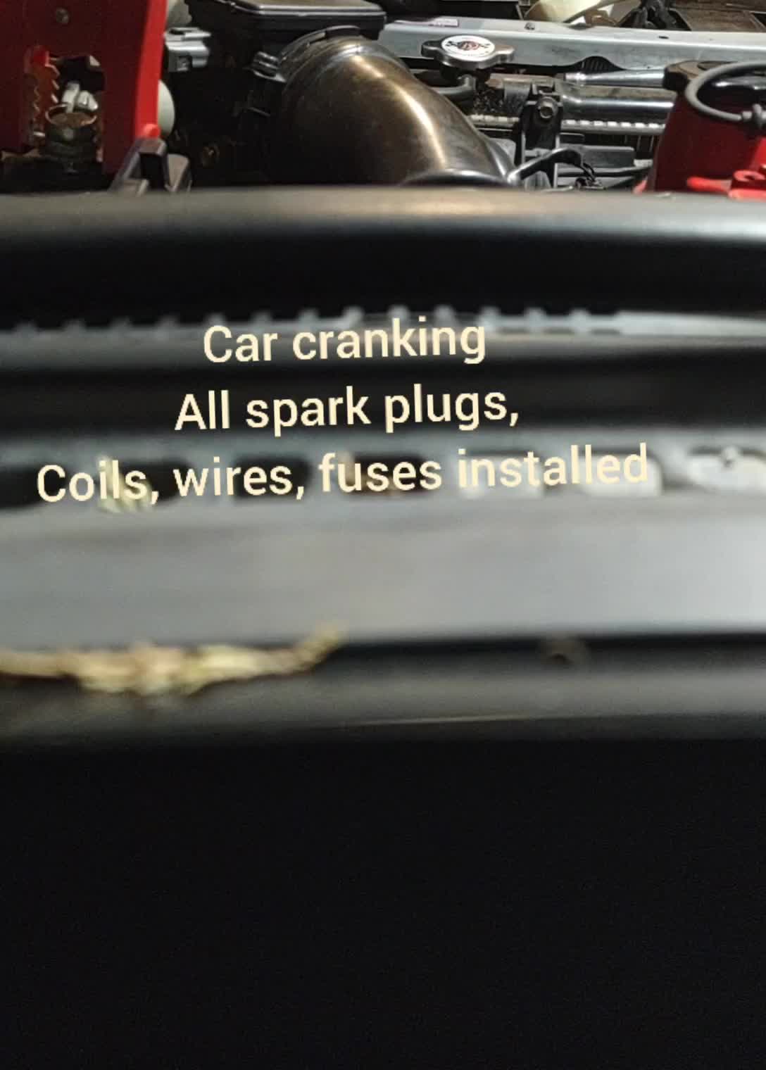

No sir. When the car first overheated, I pulled over to allow it to cool down after it did about halfway, I attempted to start the car and it made the exact same noise you hear in the video... as far at that exact of that exact sound meaning at the time of the video yes, the spark plugs were in but remember the one of the ignition coils is broken. Could it just be that it need new spark plugs and coils to turn over? When you say the cylinder head what exactly do you mean? The head gasket?
Nov 18, 2021 at 9:55 AM
  • 110,244 POSTS
I listened to the video again. It sounds like the engine is either out of time or a timing belt broke. When it turns, it sounds like there is no compression. Coils or plugs won't cause that. Is it possible for you to record it cranking longer so I can confirm for you? Or perform a compression test and see if it's low. Here is a link showing how it's done:
https://www.2carpros.com/questions/occasionally-wont-start#last
Let me know. If I could just hear it cranking a little longer and louder, I should be able to tell.

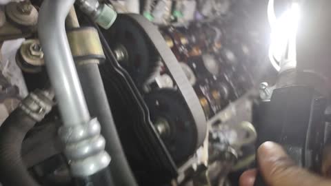

So, I did the compression test and I'm not sure if I did it right, but all cylinders were zero pressure. Below is the video of the car cranking.

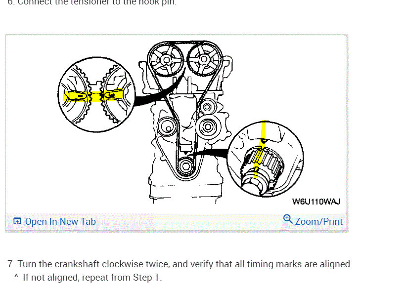

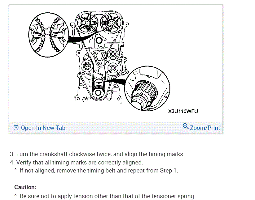

The video didn't upload. However, if you are getting 0 psi, timing is likely off when the compression stroke is happening with a valve open. The good news is the 2.0L isn't an interference engine.
If you can, upload the video so I can reconfirm. Also, if I'm correct, you will need to check the timing belt to see if it has broken or has jumped time.

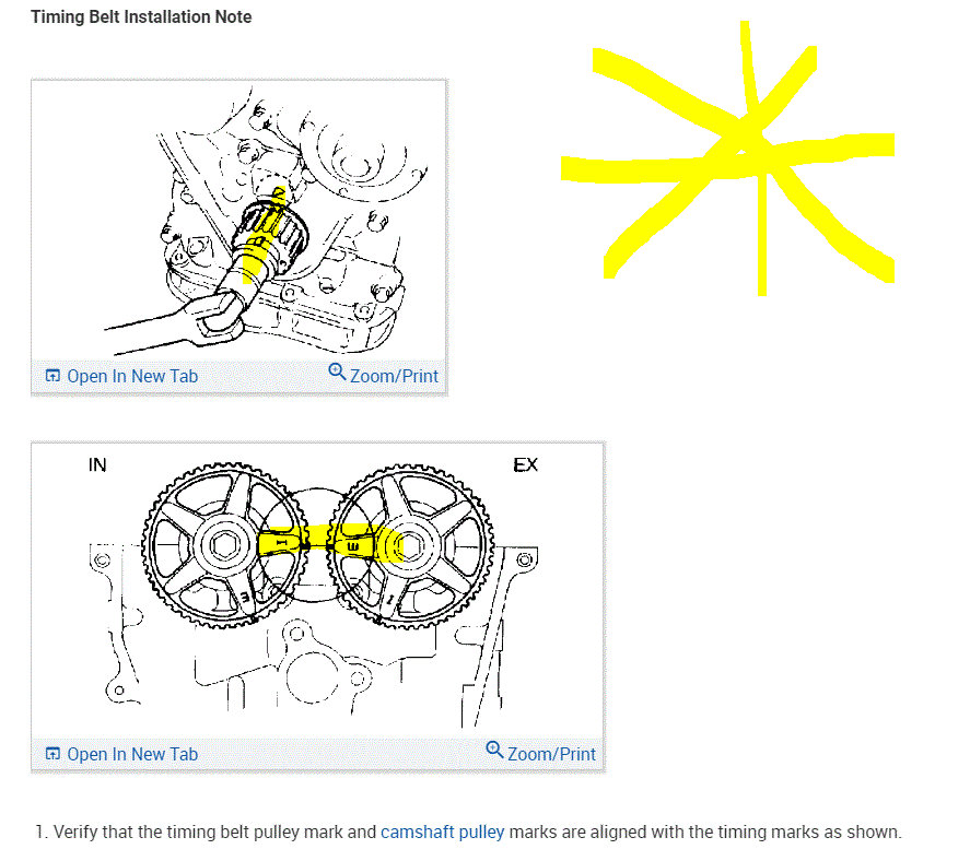

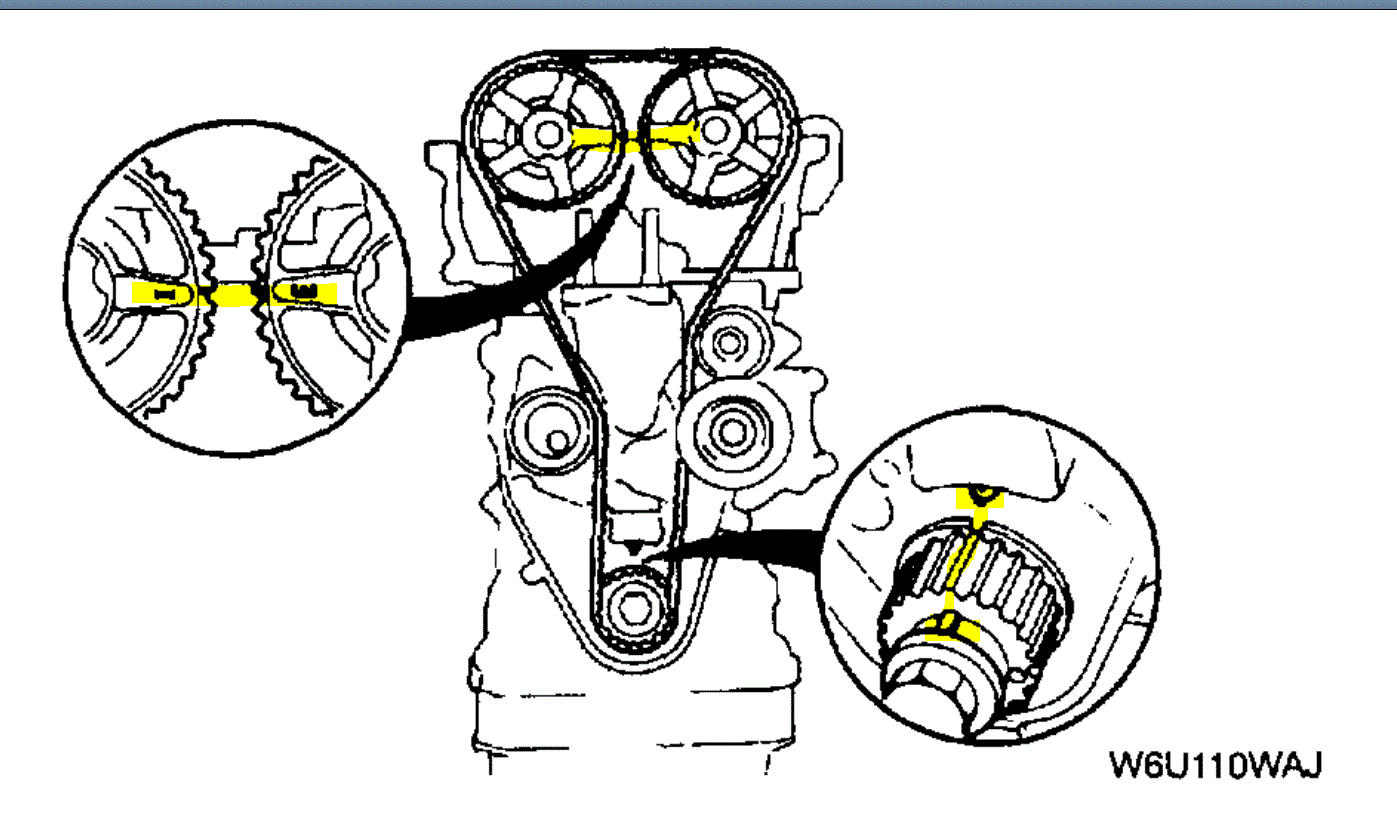

I attached a pic below showing where all the timing marks should be. Also, here is a link I need you to look through. Let me know if this is what you did.

Good evening, Joe. The first video of just the car cranking does have the plugs installed. in fact, everything is installed as if it were ready to go for a drive. The results using the compression tool all came out with zero compression. I thought maybe it would be the tool So i tested the tool with an air compressor and it read right away. So, it's not the tool..

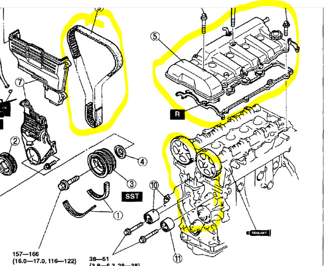

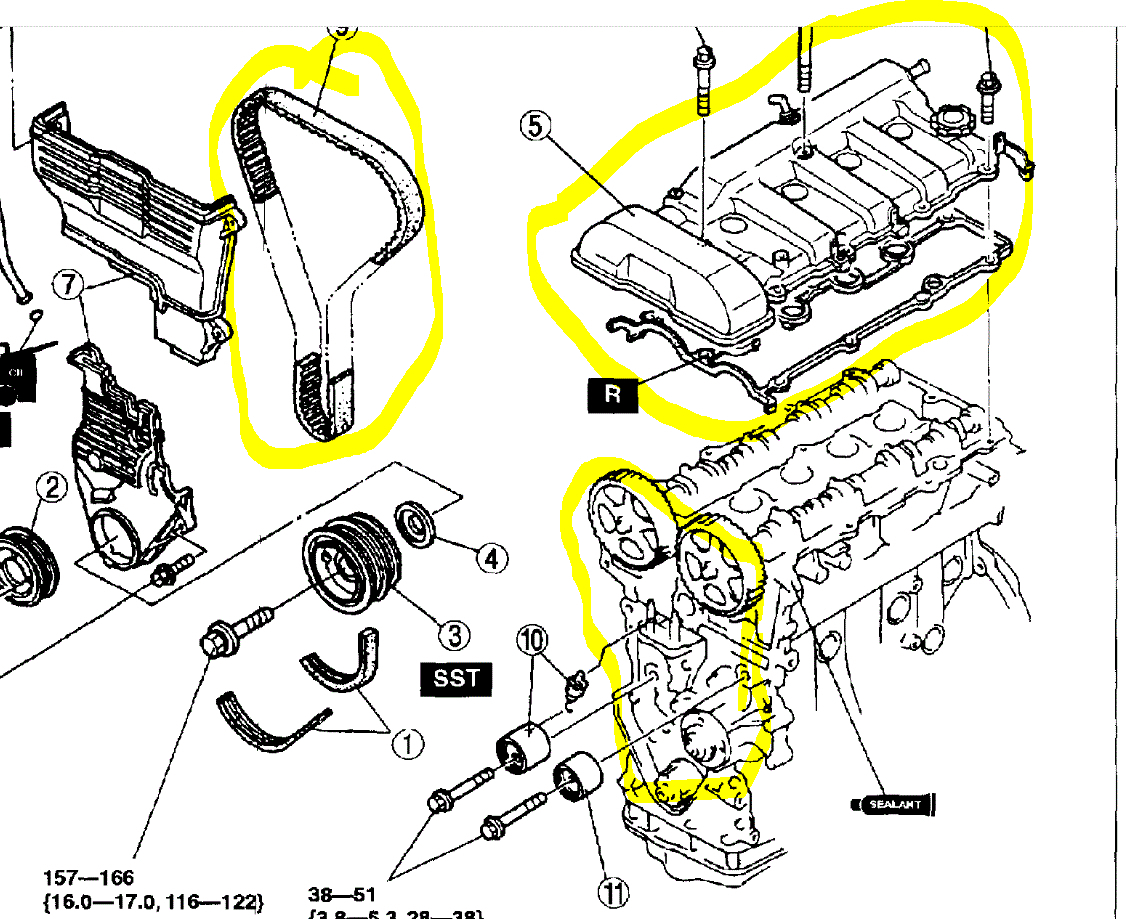

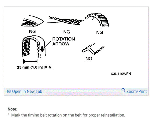

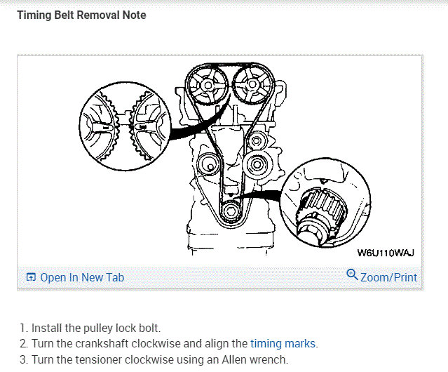

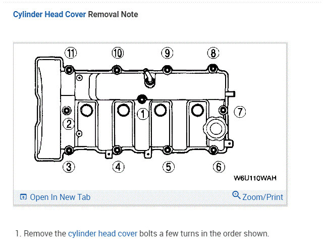

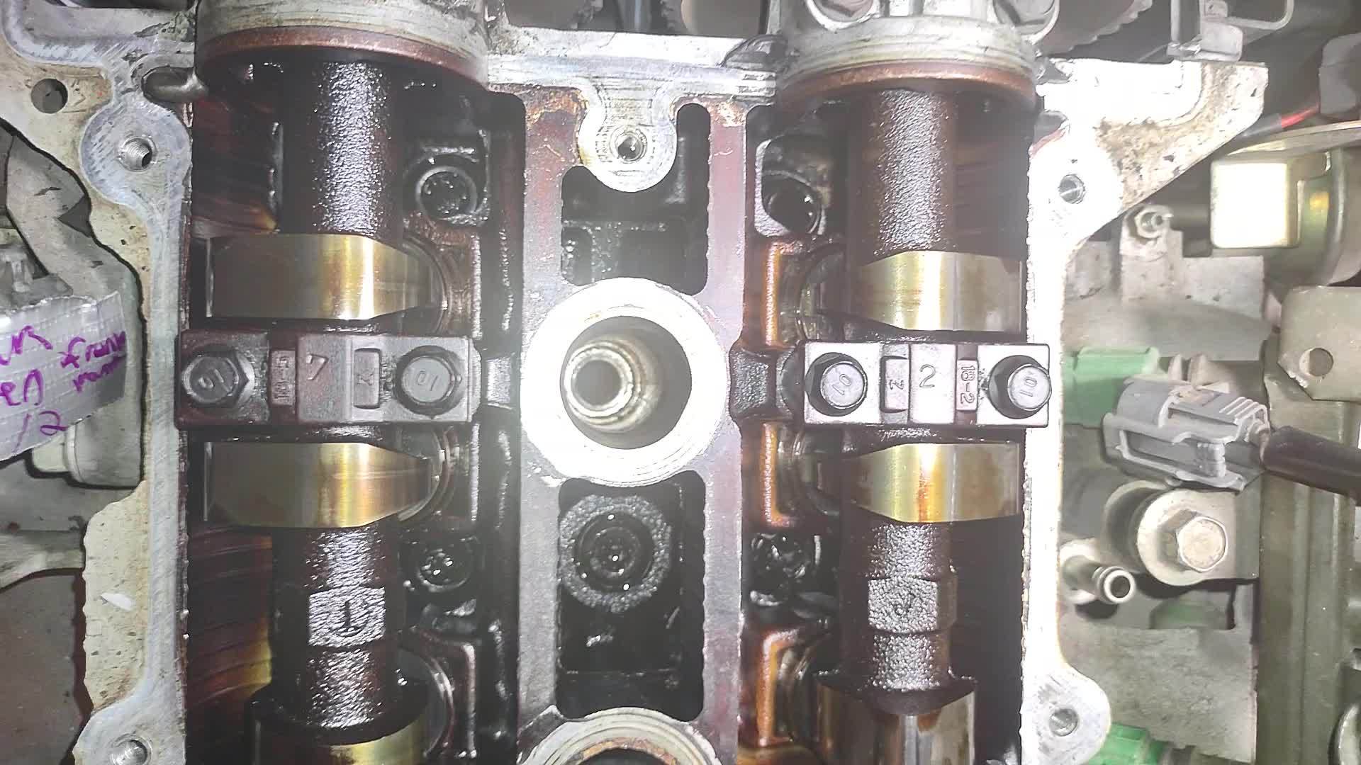

If you have 0 psi compression, it sounds like the timing is off and possibly bent valves. Did you upload a video of it cranking? It's not here.

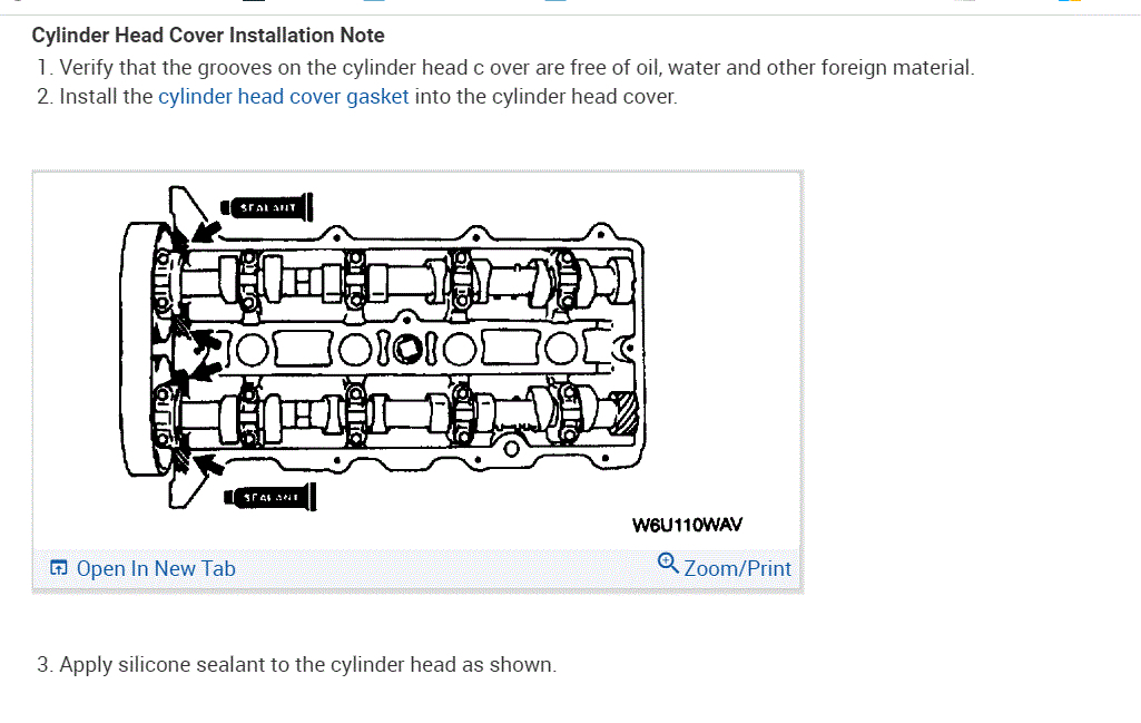

If I recall, the 2.0 DOHC on this isn't an interference engine, so that is a good thing. What I suggest is to remove the valve cover so you can inspect the belt and if there are any issues with the cams.

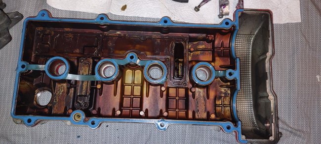

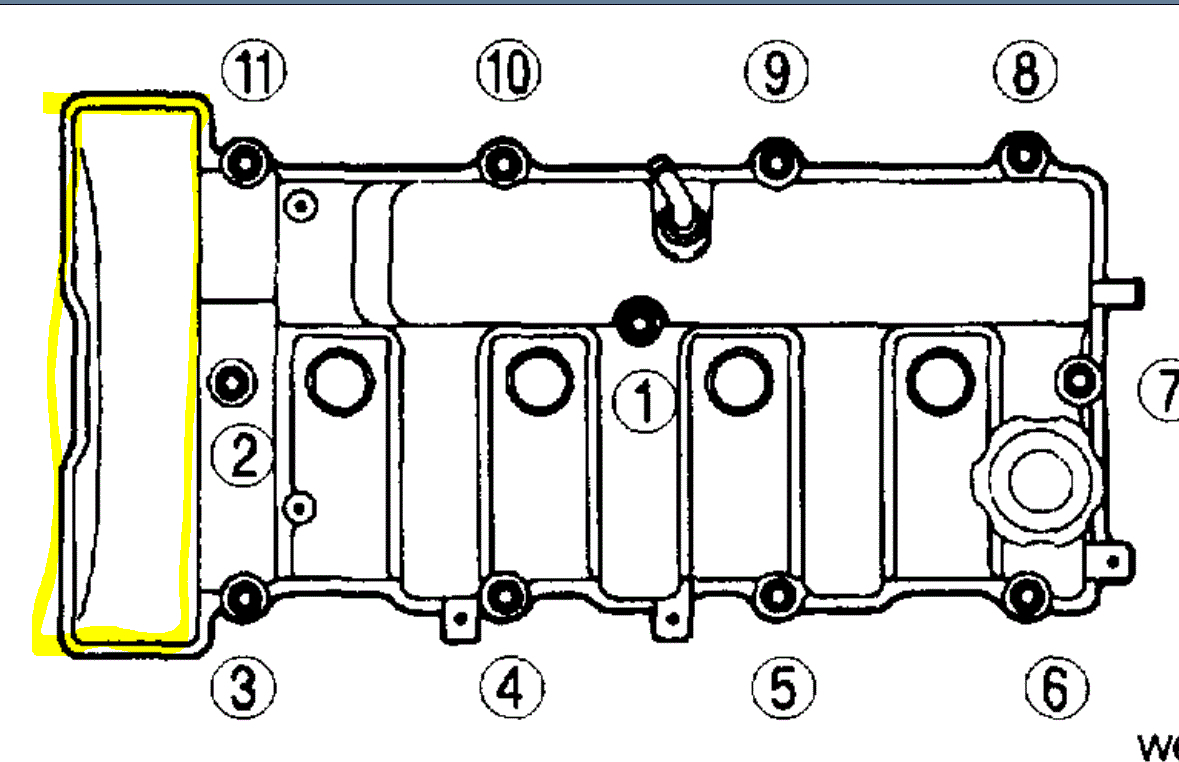

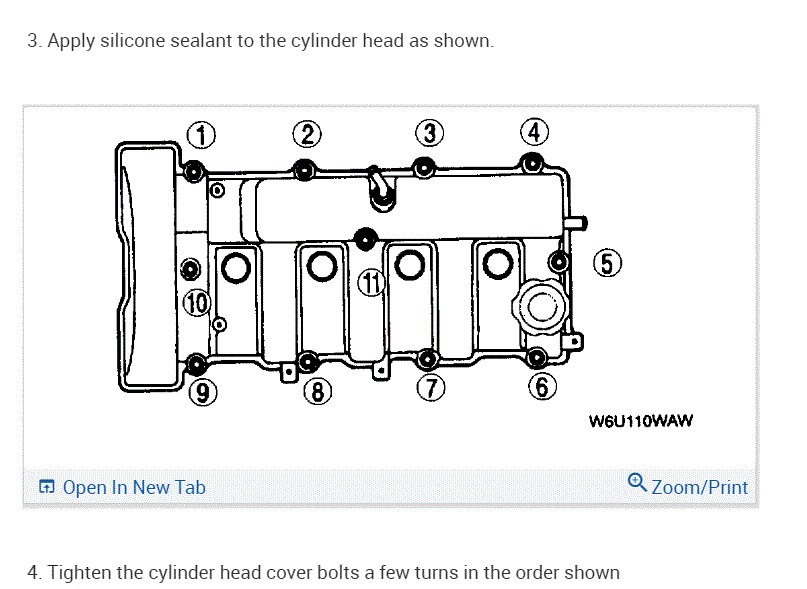

Let me know. Pic 1 shows what I'm referring to and pic 2 shows the tightening sequence.

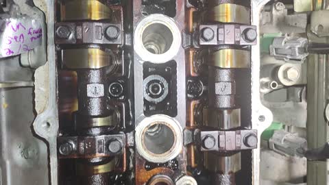

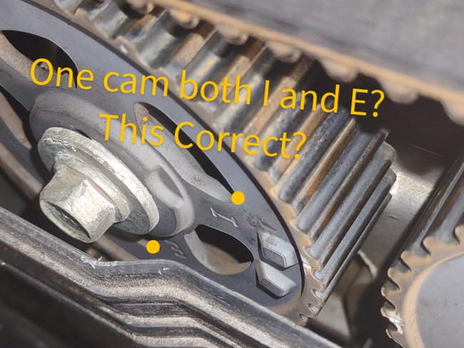

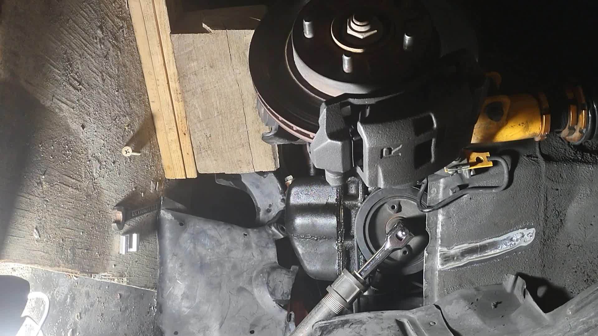

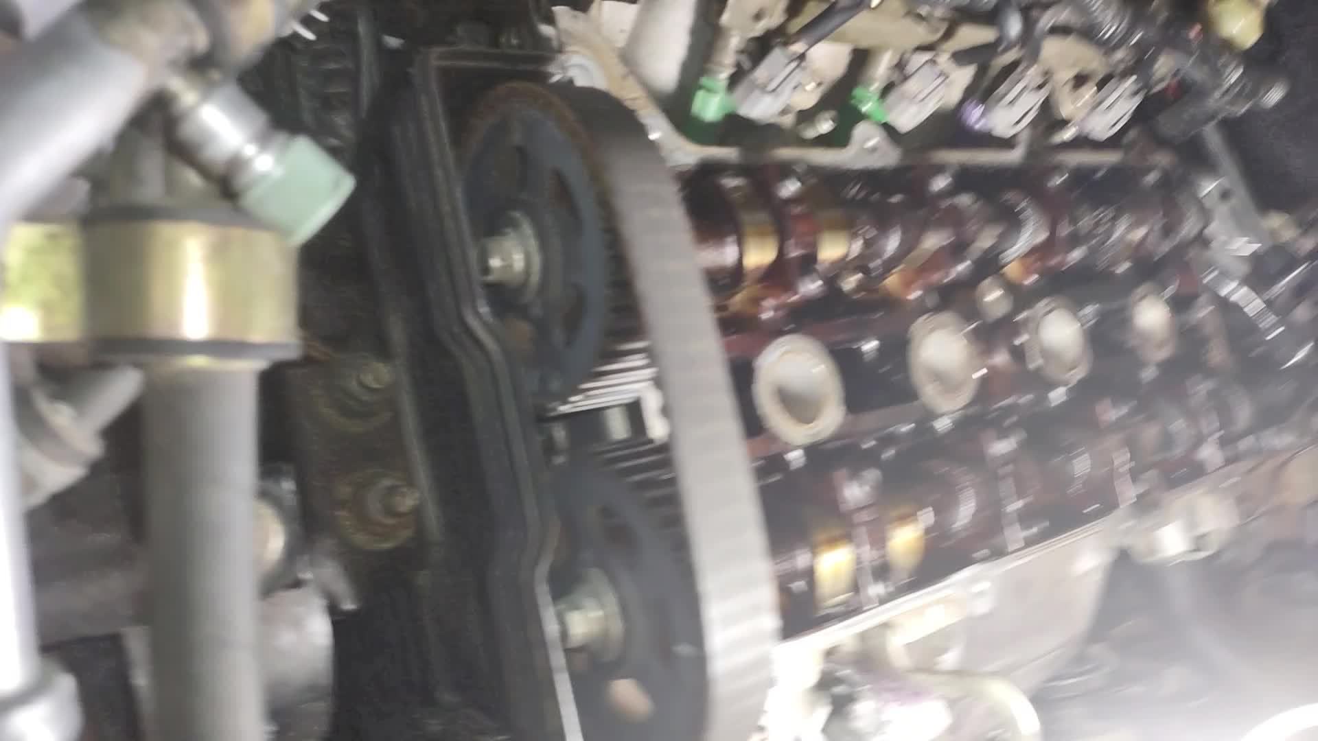

Hi Joe, happy 4th of July, long time no speak. I hope you're still with me. lol anyways since the last time I have worked on my car I do have some questions but first let me fill you in I took the spark plugs off and all that good stuff took the valve cover off I'm not sure what I'm supposed to be looking for on the cams to see if they are in good shape. I'll send a picture. I am confused maybe you can clarify on both cams there is a letter i and e on them both cams have both I and E on them is that suppose to be there. Sorry, I'm not too sure about that also I noticed a lot of oil sludge around the alternator and back of the oil pan and I noticed that the alternator bolt is half on half off. can that also play a part and why it wasn't starting? I'll send pictures of that too. I tried doing the bump start method to loosen the crank bolt however, it doesn't work. I'll send a video of that. I did notice the motor mount is broken, maybe that is the reason why the bump start method isn't working. Hopefully you can give me some pointers. Lastly, I did notice that the I and the e on the cams are very close so I try to move the crank a little to see if the I and the E would flush up together but before I did that, I noticed a lot of slack on top of the timing belt, is that a sign of something or is that normal? maybe you can elaborate on that. Anyway, I hope you're enjoying your 4th of July. I appreciate your help I really do thank you for your patience and your time and I hope to hear from you soon.

One last thing, while i have the car like this, do you have any suggestions on what i should be looking and or replacing other than what's been said? Does the crank have a gasket? Do i have to replace the crank bolt as well? I'm just making notes on the extra things that need to be replaced. Also, I'm curious and would like to know not just for what I'm currently working on, but anything related to this car so are there bolts, pulleys, gaskets tensioners etc. That can only be used once. Meaning since i removed things from its original place be a bolt, gasket, harmonic balancer, etc., does it have to be replaced if yes what are they? So, i can start familiarizing myself with them and i just don't want to have to take everything apart again. Lol
Jul 4, 2022 at 2:01 AM

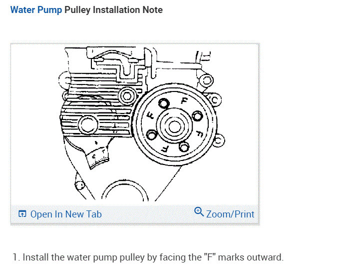

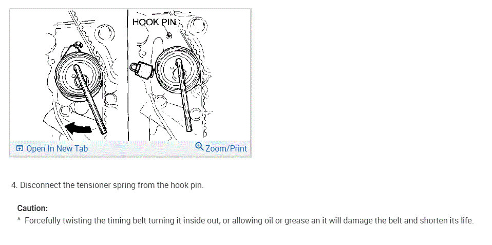

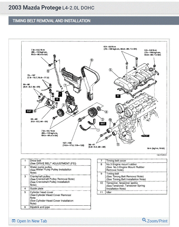

  • 110,244 POSTS

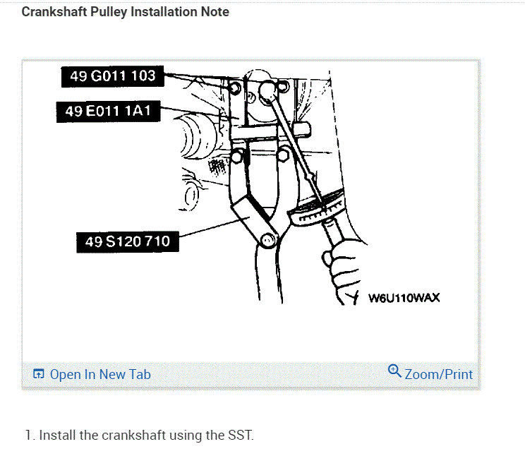

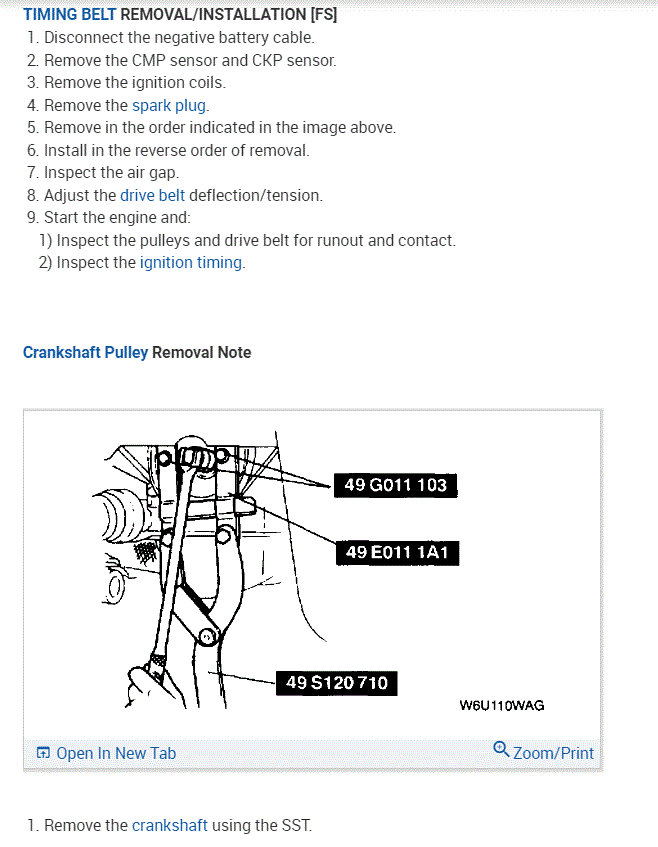

The crankshaft bolt is tight!!! Do this. Since you have a breaker bar on it, take a heavy hammer and smack the breaker bar a couple of times and the bolt should come loose. If you have an air impact, that will take it right off.
Now, the I and the E stand for intake and exhaust. It's identifying what each camshaft is for.

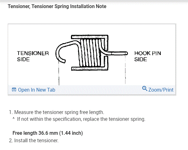

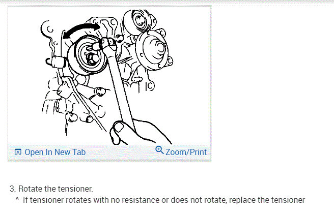

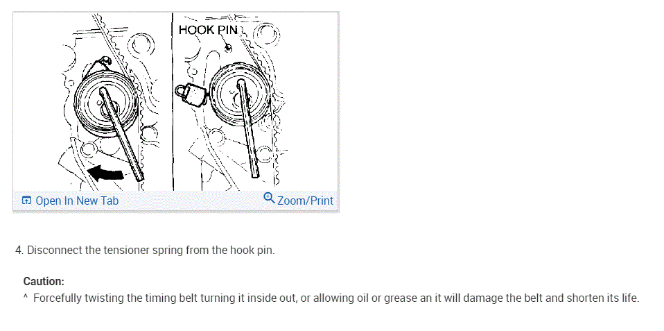

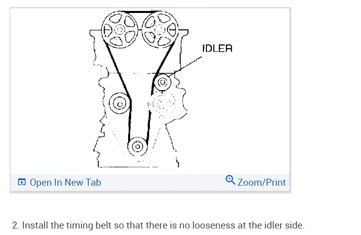

If you have a leak, then consider replacing the front crankshaft seal. If it isn't leaking, just make sure to lubricate the seal with motor oil before putting things back together.

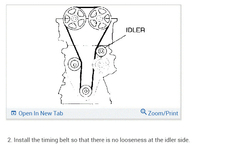

Also, the timing belt does appear to have a good bit of play, but that can be because of the positioning of the cams.

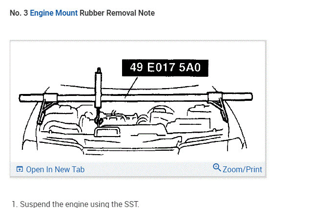

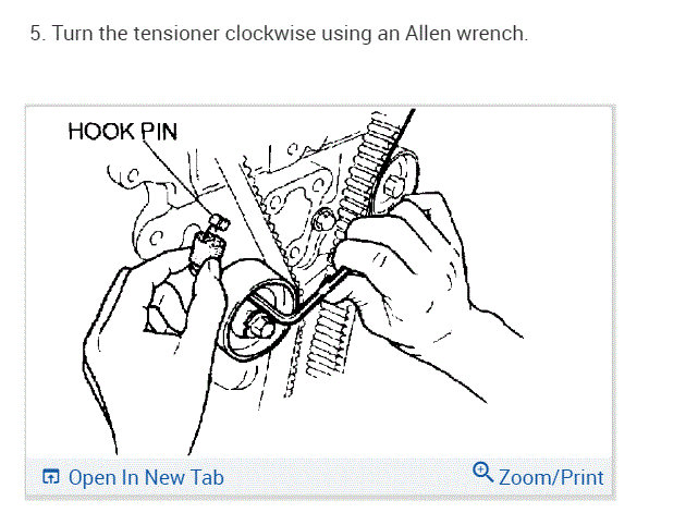

I attached the directions below for replacing the belt. Take a look through them and let me know if you have questions.

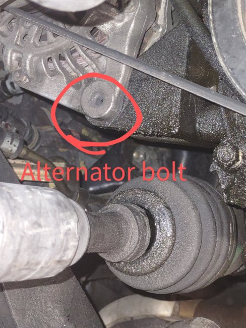

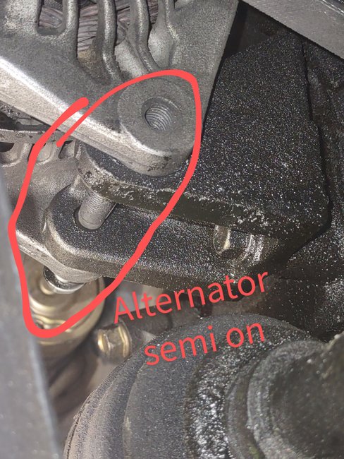

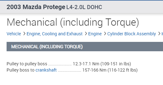

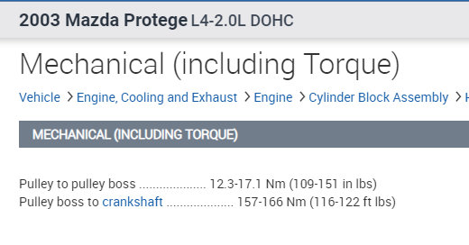

So, I'm really struggling with this crank bolt. i tried the bump start but that isn't working. i put a weaker end impact gun pushing 120 ft/lbs of torque to nothing. I tried putting an extension to reach outside the wheel hub and added a cheater bar to it and it won't budge. I'm turning counterclockwise while this homemade pulley lock thing i made that screws into the whole of the crank pulley holds onto the control arm as i turn clockwise it hold but nothing gives. is there something else I can do before i get spend bigger money on an impact gun i won't need so much? how much torque should the impact gun have for it to work?
Jul 23, 2022 at 4:58 AM
  • 110,244 POSTS
The bolt torque is listed below. On the high end, it says 122 ft/lbs. I just read through the procedures again and nothing indicates it as being a left-handed thread.
Did you try smacking the breaker bar with a hammer to see if it will break it loose?
See pic below.
