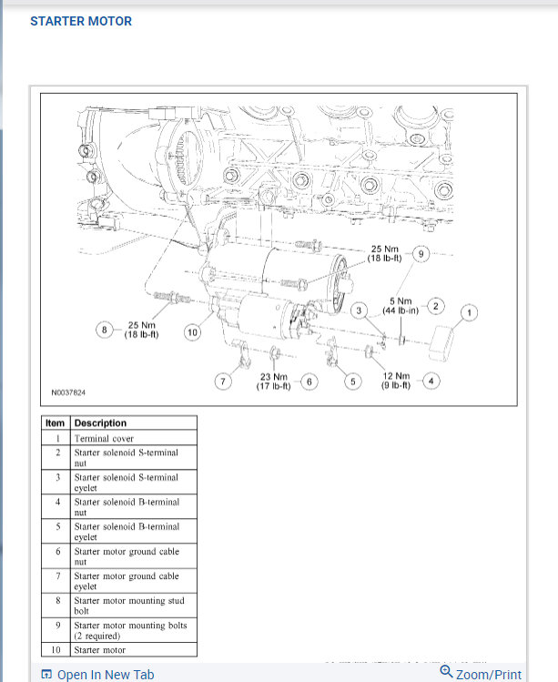

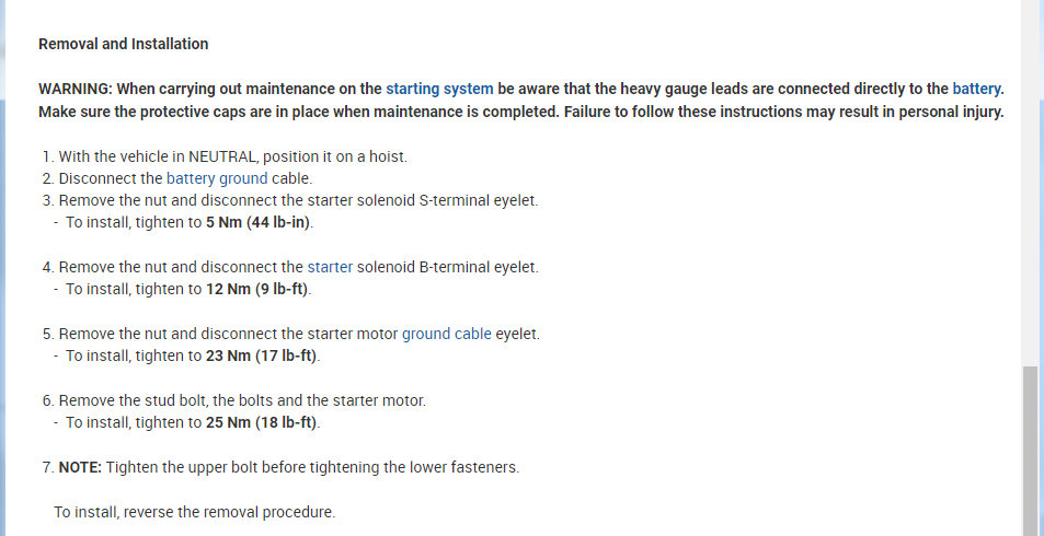

Here is a guide that will help with this. It sounds like you don' t need it but others that visit this page may.
Also, below are the instructions in case you or someone else needs these as well.
