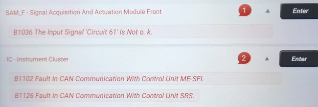

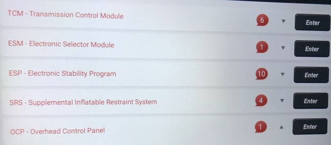

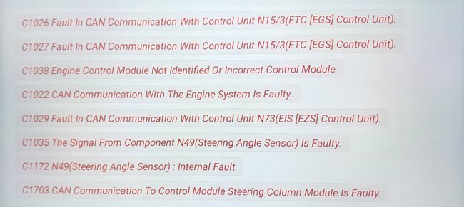

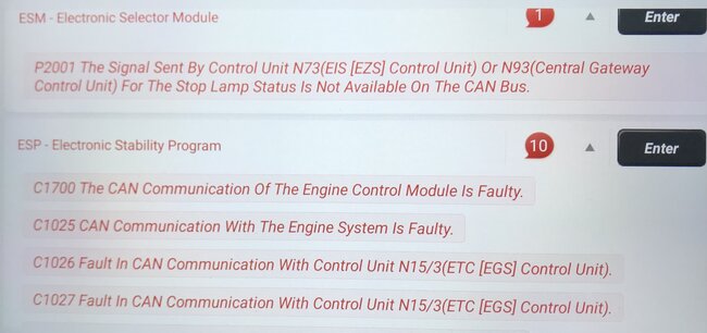

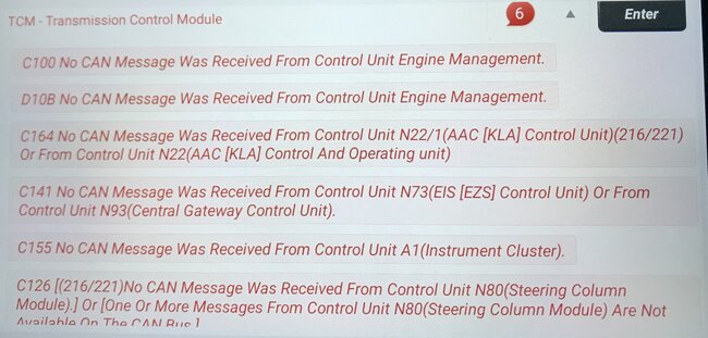

Here are the codes below.

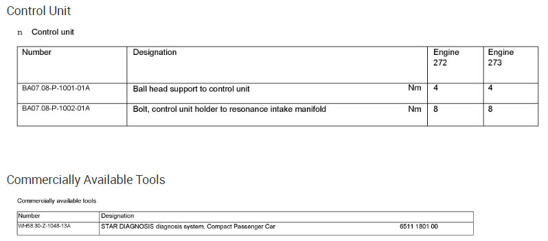

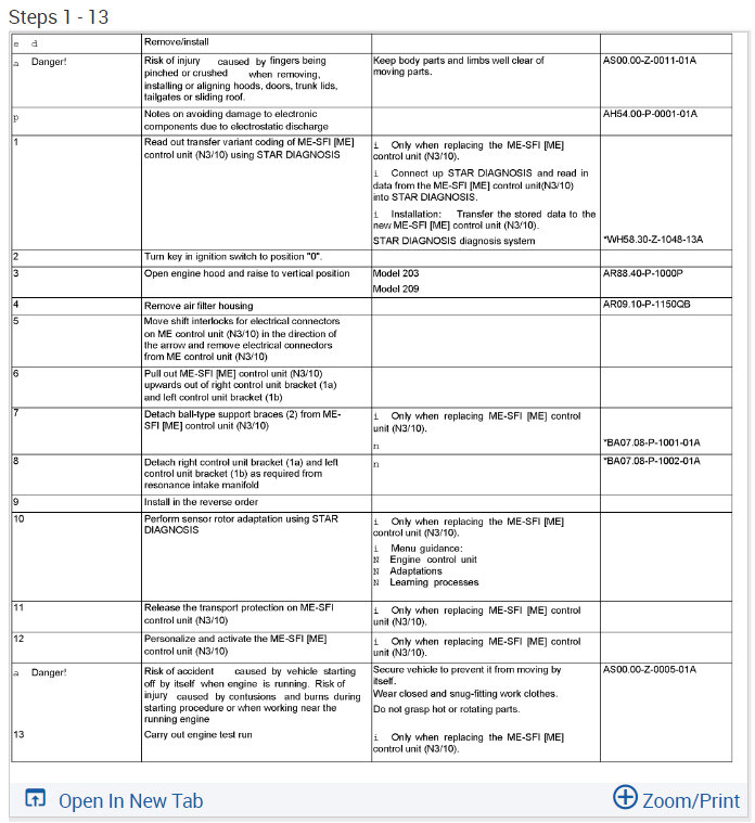

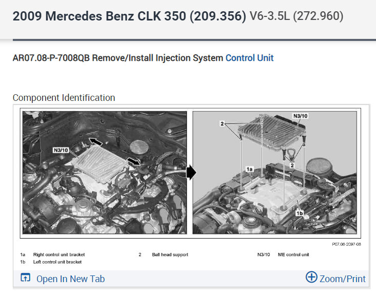

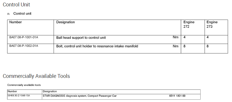

Can I ask if this car was water damaged? Most of these codes are showing the engine control unit not working which can cause the additional codes. Let's get a rebuilt preprogrammed unit by searching google or ebay. Here is how to change the unit out. Check out the images (below). Let us know how it goes.

No the car wasn’t water damage. Do you know why f53 has no volts? But I can still jumper the starter relay and it cranks but doesn’t start? Also which 2 wires on ecm harness can I check for low CAN volts? I want to be sure it’s not a CAN problem before I spend $600 on rebuild ecm. Also do you have a diagram for the Bosch me9.7 ECM circuit board?

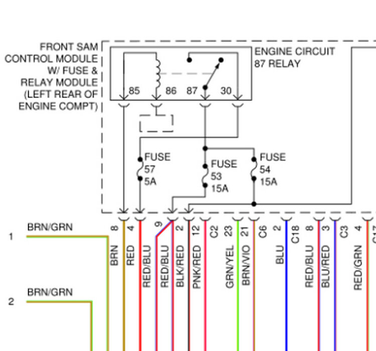

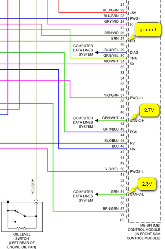

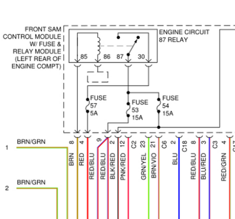

Yes fuse 53. I was wondering how this fuse gets its power. When I jumper starter relay terminals 30/87 it cranks but no start. I tried jumping engine relay 87 at terminals 30/87 (I found no volts at 30) and no crank but engine fan comes on at high speed. Also, I tried adding a ground wire to terminal 85 under the relay and fan comes on high speed and no crank. I checked all fuses and all good. I still need to know what are the 2 CAN wires that go to ECM to check for about 2.5 volts?

As previously discussed, fuse F53, as well as fuse F54, is supplied by Engine circuit 87 relay.
See image 1 below.
This relay is switched by a ground trigger on terminal 85.
This switched ground is supplied at pin 8 of connector C2 at the front SAM on a brown wire
The ECM is supplying the switched ground from pin 27 at connector C2(small 58 pin.

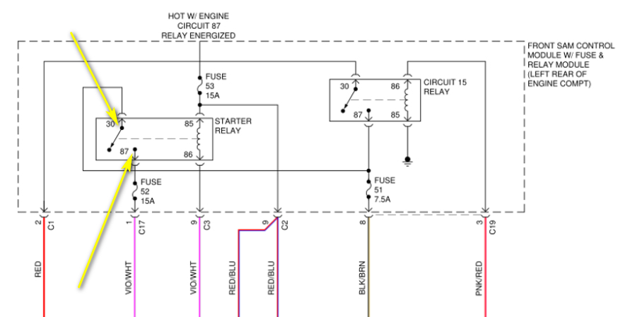

When bridging the starter relay terminals 30+87 are connected.
See image 2 below.
Terminal 30 is supplied by the Ignition circuit 15 relay and not by fuse F53.
The 2 HS CAN lines are connected to pins 41+54 at ECM connector C2.
The HS CAN lines usually carry 5V combined, with the high side usually on about 2.7V and the low side on about 2.3V.
Pin 41, green/white wire HS CAN high, about 2.7V
Pin 54, green wire HS CAN low, about 2.3V
See image 3 below.

With key in on position and ECM removed I checked pin 41on harness it read about 3.14 volts. Pin 54 about 2.00. I tried a different front SAM with same part number and still no ground at terminal 85. I tried with key in on position and start position and still no ground. Looks like the front SAM is good so it has to be the ECM? IC chip 50554 next to capacitor that I changed is the one that provides the ground to relay after receiving volts to pin 15 from ignition. Am I correct?

I was notified that the ECM cannot be cloned due to not communicating. I need to send in the EIS module for cloning to rebuild ECM. Can you send me information on how to remove EIS module? Thanks.

I figured out how to remove EIS myself since I wasn’t getting a reply. The rebuild ECM fixed my problem of no crank no start. Everything is working properly now.
