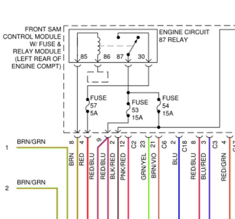

Engine ECM is not communicating with scanner. All other modules show on scanner. No voltage at starter relay. ECM was sent out and found software failure and corrected and reinstalled. Front sam check good on scanner. New battery installed. All fuses and relays check good. Need wire diagram for ECM connectors and what pins to check voltage. Thinking ECM is not getting voltage input.

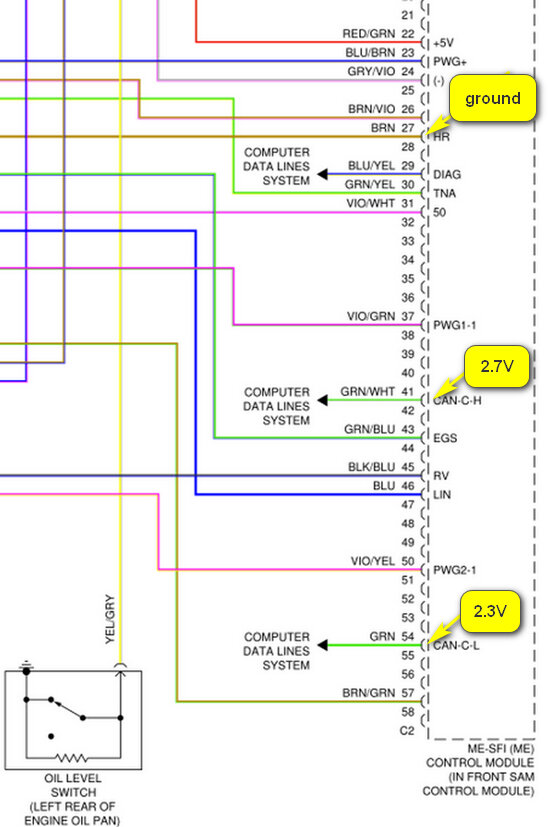

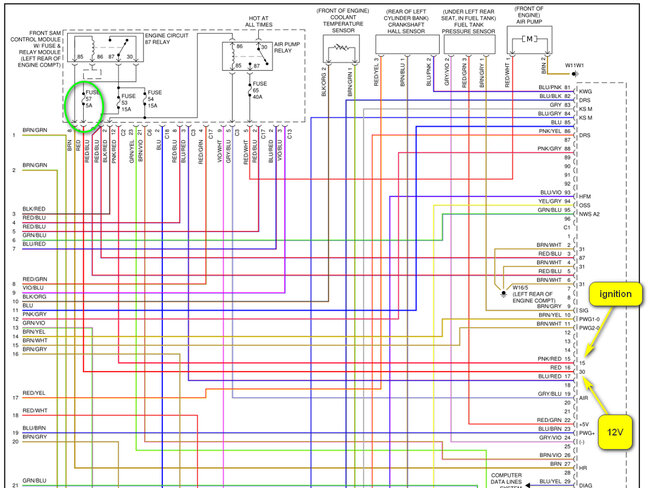

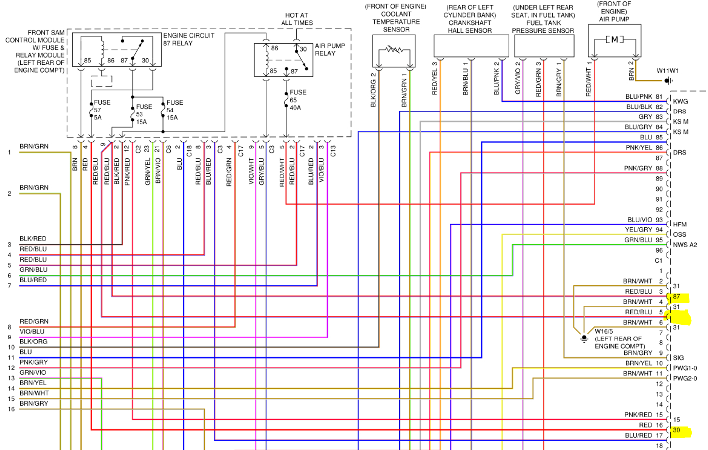

On the ECM you have 2 connectors.
C1 - 96 pin
C2 - 58 pin
Pin out at connector C2.
Pin 3, red/blue wire ignition 12V from fuse F53(15A) in front SAM
Pin 5, red/blue wire ignition 12V from fuse F53(15A) in front SAM
Pin 16, red wire constant 12V from fuse F57(5A) in front SAM
Also check your grounds at pins 2, 4, 6, brown/white wires.
Diagnostic wire, blue/yellow, comes from pin 29 to OBD connector pin 7.
See image below for 12V and ground wires.
Cheers, Boris

BORIS K
  • 836 POSTS

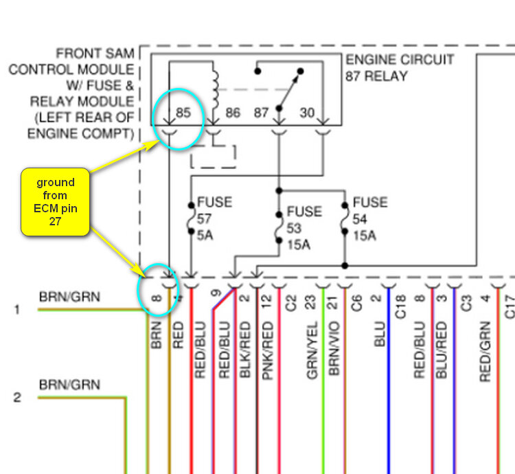

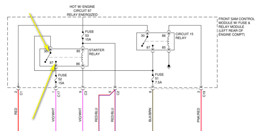

The ECM needs to be plugged in to activate the engine circuit relay 87, if ECM unplugged fuse F53 will not be energized.
ECM on connector C2 pin 27 outputs a ground on brown wire to front SAM pin 8, connector C2. This in turn will switch relay to output 12V to fuse F53.
Also fuse F53 needs to be live to energize the starter relay, see image below.
I had to separate wiring diagram for display purposes.
Cheers, Boris
Mar 14, 2024 at 12:08 AM

BORIS K
  • 836 POSTS
As fuse F53 is supplied by relay 87 you will only require the ignition to be on.
Suggest checking that the ECM switches a ground out at pin 27 to the front SAM at pin 8, connector C2.
See image below.
Cheers, Boris
Mar 14, 2024 at 3:20 AM

BORIS K
  • 836 POSTS
You are checking engine87 relay in front SAM.
You could back probe pin 27 to check if ECM is switching ground out, better still check that ECM is switching ground out at the relay socket, terminal 85.
Cheers, Boris
Mar 14, 2024 at 9:10 PM

BORIS K
  • 836 POSTS
It will as the ECM pulls a ground through terminal 85 via brown wire to ECM pin 27.
As you are not getting a ground you either have a connection issue inside the front SAM from terminal 85 to pin 8, a possible broken brown wire to ECM or an issue inside the ECM.
Suggest checking each circuit separately, front SAM and brown wire back to ECM.
Cheers, Boris

BORIS K
  • 836 POSTS
The relay needs to switch to supply fuse F53. You could try and supply a separate ground to the relay and see if it will switch.
Keep in mind that if the ECM does not switch a ground out this could point to an issue inside the ECM.
Cheers, Boris

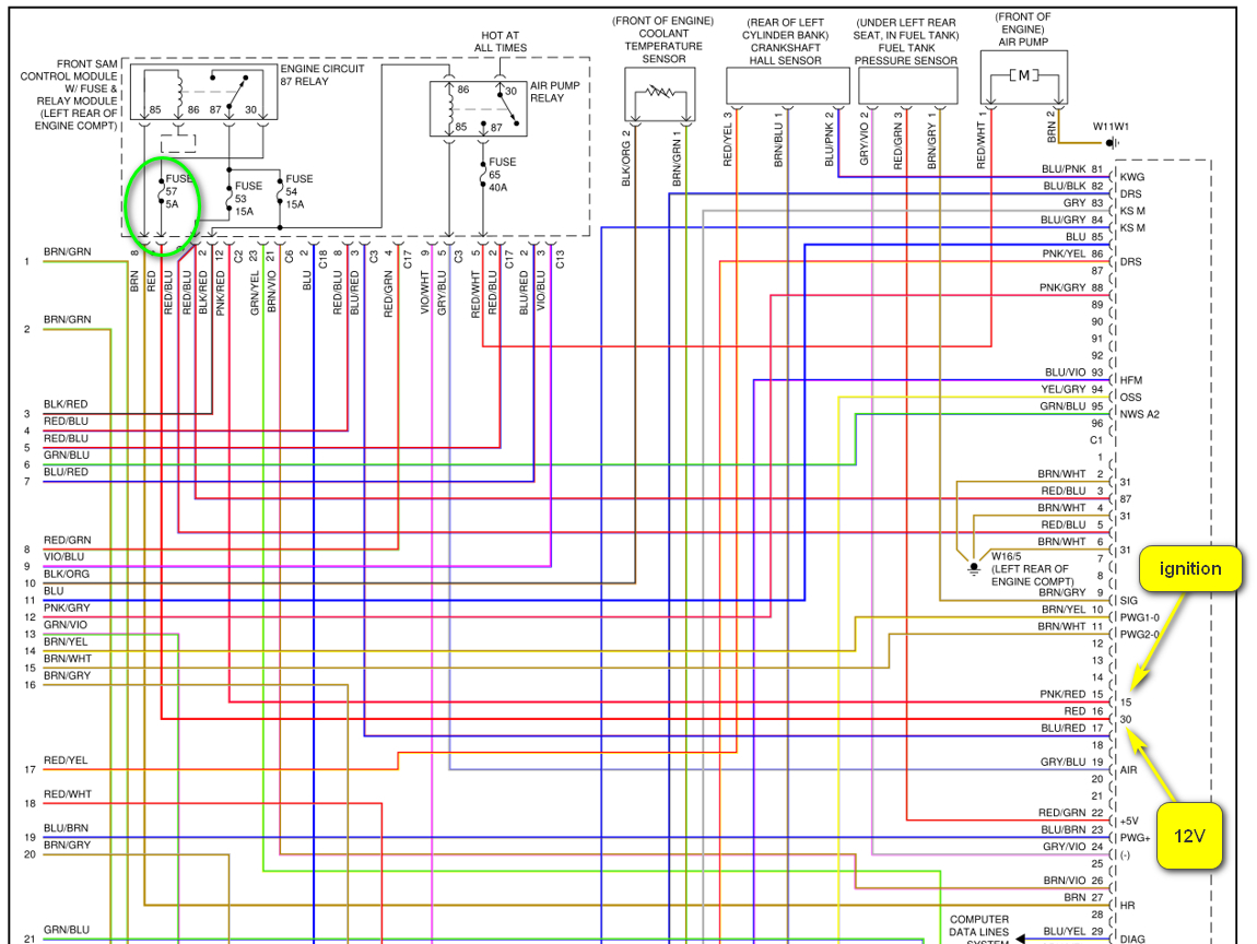

BORIS K
  • 836 POSTS
On ECM connector C2.
Pin 15, pink/red wire 12V ignition from front SAM pin 12, connector C2.
Pin 16, red wire constant 12V from front SAM pin 4, connector C2, fuse F57(5A).
On diagram terminal 15 is ignition, 30 is constant 12V, 31 is ground.
See image below.
Cheers, Boris

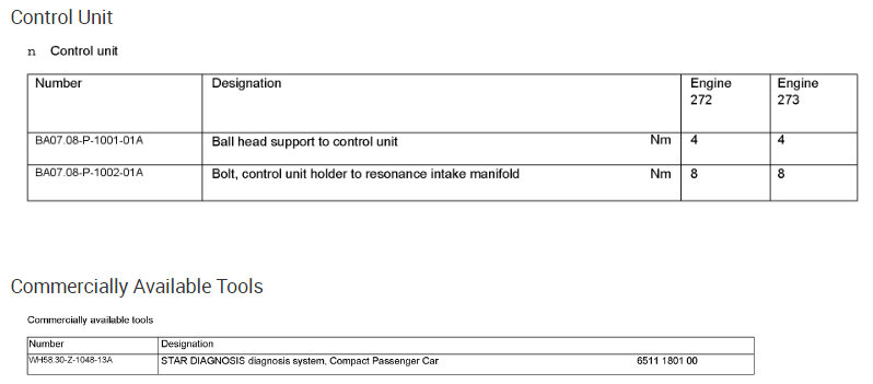

BORIS K
  • 836 POSTS

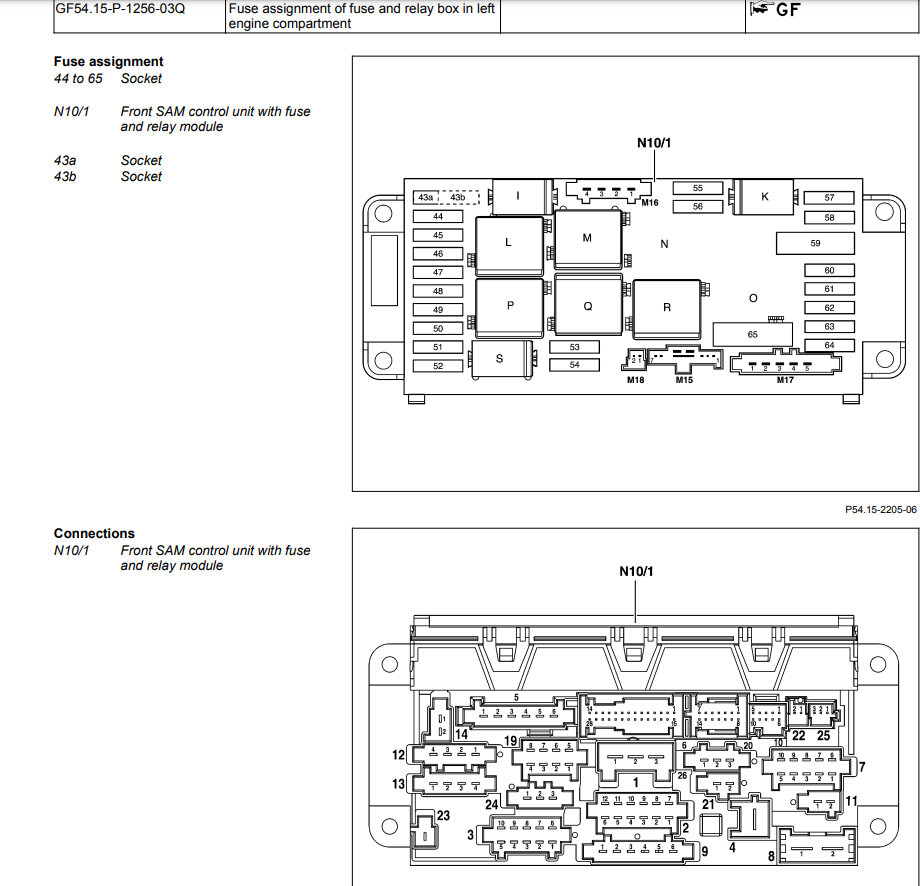

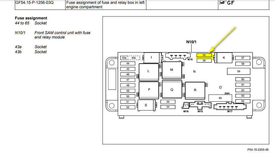

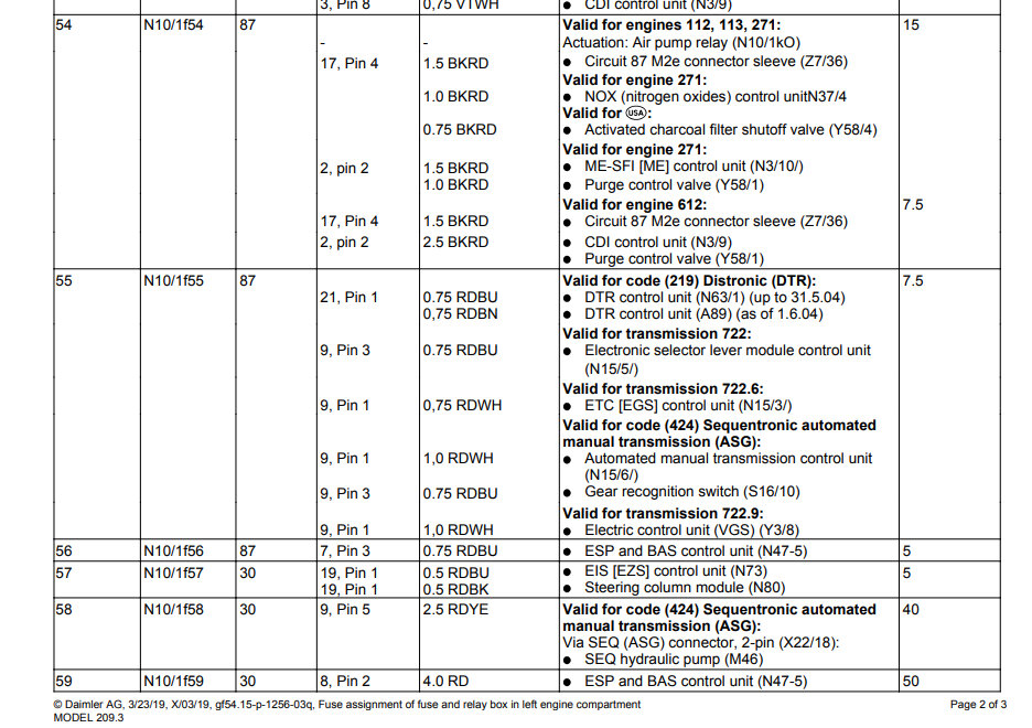

Fuse 55 in front SAM controls several different outputs.
See illustrations below.
Picture 3 shows description and front SAM connector and pin description.
Connector 21 and 9, as illustrated in image 1.
Cheers, Boris

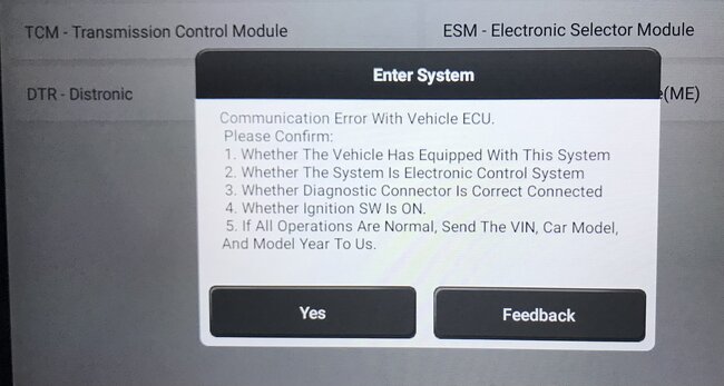

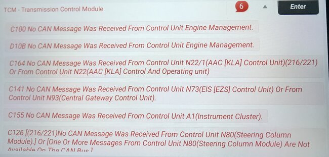

When i jumper starter relay the engine cranks, but no start and security light does not flash. Immobilizer is ok. With key in on position fuse 53 has no volts so how come engine cranks with jumper if no power at f53? I thought f53 needs power to crank? Also, I cleared codes and still has no communication with ECM and dtr and has a lot of codes for ESP and TCM. Also front SAM showing code B1036. Enclosed codes below.
Apr 6, 2024 at 12:54 AM
HAL1958
  • 89 POSTS
ECM.
Apr 6, 2024 at 12:55 AM
HAL1958
  • 89 POSTS

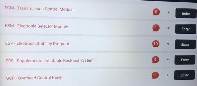

Tcm/Esp/F sam
Apr 6, 2024 at 12:58 AM
  • 55,758 POSTS

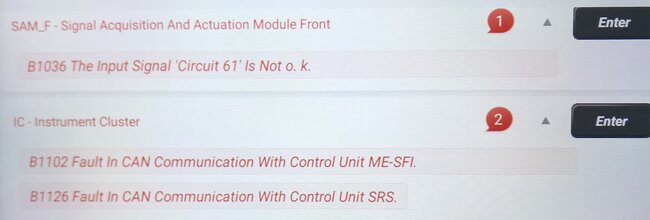

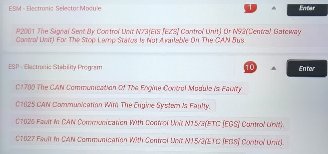

Can you post all of the codes please?
Apr 6, 2024 at 4:05 AM
HAL1958
  • 89 POSTS

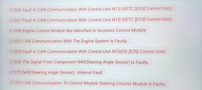

Here are the codes below.
Apr 8, 2024 at 3:42 AM
  • 55,758 POSTS
Can I ask if this car was water damaged? Most of these codes are showing the engine control unit not working which can cause the additional codes. Let's get a rebuilt preprogrammed unit by searching google or ebay. Here is how to change the unit out. Check out the images (below). Let us know how it goes.

No the car wasn’t water damage. Do you know why f53 has no volts ? but i can still jumper the starter relay and it cranks but doesn’t start ? Also which 2 wires on ecm harness can i check for low CAN volts ? I want to be sure it’s not a CAN problem before I spend $600 on rebuild ecm. Also do you have a diagram for the Bosch me9.7 ECM circuit board?
Apr 9, 2024 at 2:09 AM
  • 55,758 POSTS
We do not have the circuit board diagrams; also, can you please clarify what you mean by f53? fuse 53? The reason I asked about the water damage is because of so many communication errors. Like large parts of the system are down all at once. It could be the front SAM unit is out, can you please double check all maxi fuses please?

BORIS K
  • 836 POSTS

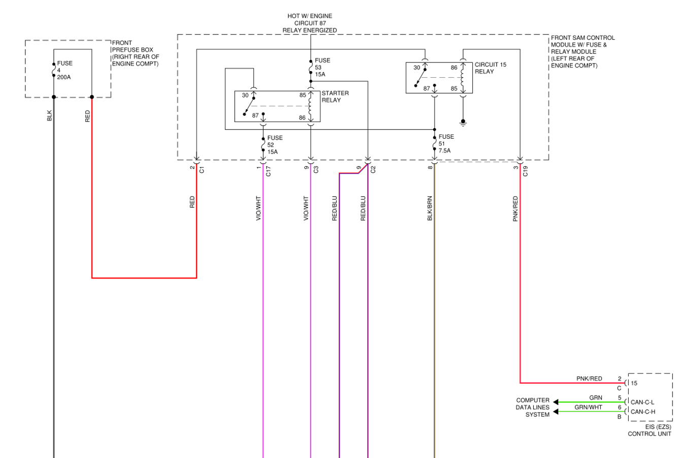

As previously discussed, fuse F53, as well as fuse F54, is supplied by Engine circuit 87 relay.
See image 1 below.
This relay is switched by a ground trigger on terminal 85.
This switched ground is supplied at pin 8 of connector C2 at the front SAM on a brown wire
The ECM is supplying the switched ground from pin 27 at connector C2(small 58 pin.
When bridging the starter relay terminals 30+87 are connected.
See image 2 below.
Terminal 30 is supplied by the Ignition circuit 15 relay and not by fuse F53.

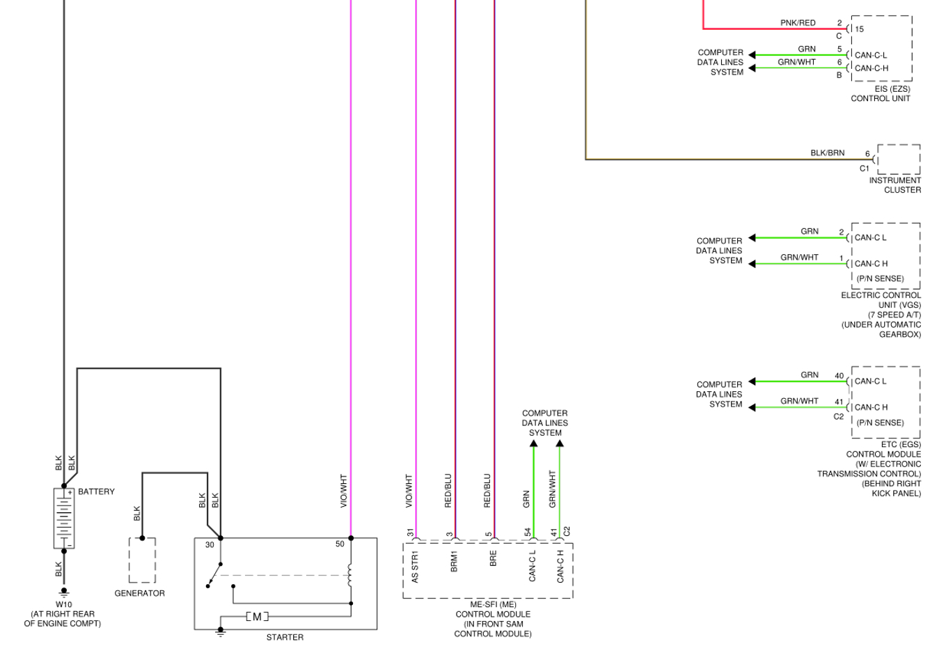

The 2 HS CAN lines are connected to pins 41+54 at ECM connector C2.
The HS CAN lines usually carry 5V combined, with the high side usually on about 2.7V and the low side on about 2.3V.
Pin 41, green/white wire HS CAN high, about 2.7V
Pin 54, green wire HS CAN low, about 2.3V
See image 3 below.

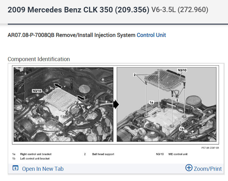

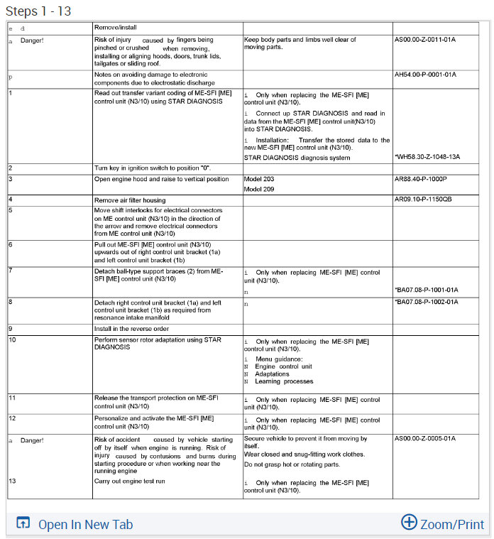

I was notified that the ECM cannot be cloned due to not communicating. I need to send in the EIS module for cloning to rebuild ECM. Can you send me information on how to remove EIS module? Thanks.
Apr 14, 2024 at 6:05 AM
HAL1958
  • 89 POSTS
Can you send me information on how to remove EIS module ? Thanks.
Apr 17, 2024 at 9:08 AM
HAL1958
  • 89 POSTS
I figured out how to remove EIS myself since I wasn’t getting a reply. The rebuild ECM fixed my problem of no crank no start. Everything is working properly now.
