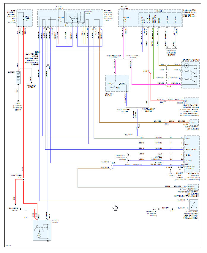

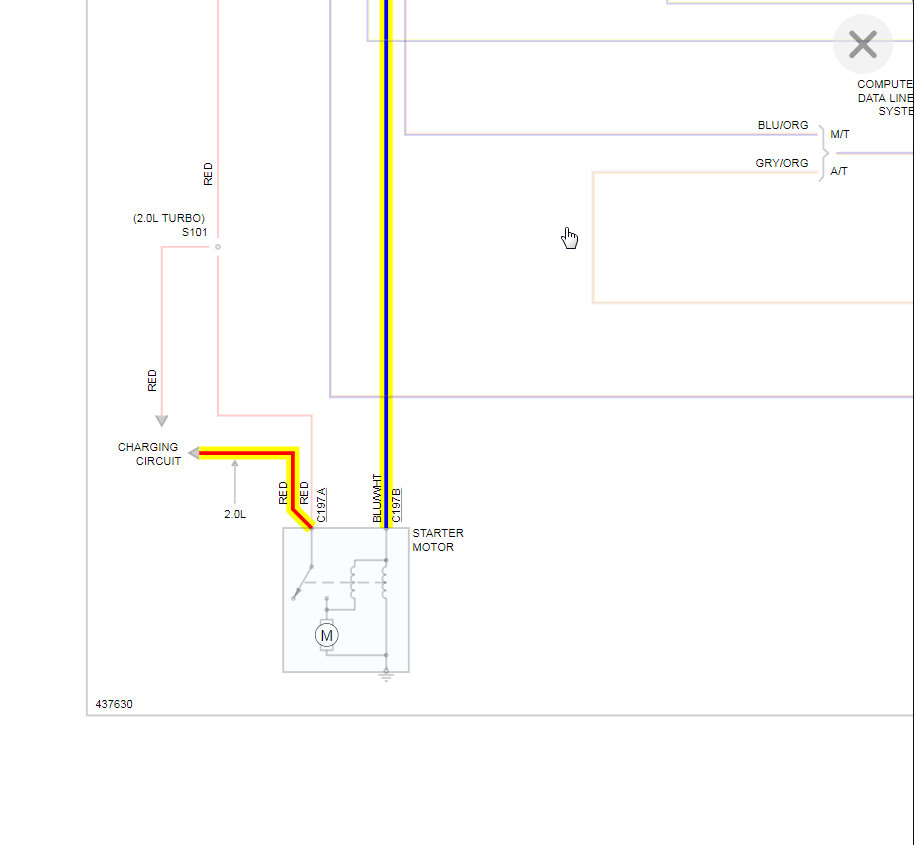

Good battery, all fuses and relays check good. getting 3.4 volts to control side of starter solenoid, 12 v to battery side. i am wondering if this is something that is common as i see that Focus seems all model years have some electrical problems, but have not found any with exact problem and it be solved. i have tested starter and circuit to starter as i have been a mechanic for 30 plus years i have went through all steps that lead to common no crank issue. i am getting ready to drop driver's airbag and test ignition switch and circuit to solenoid. any color coded wiring diagrams and experienced insight would be greatly appreciated.
Jun 4, 2020 at 10:54 AM
Just so we are clear, you have 3.4 volts on the blue and white wire at the starter?
If this is true then that is not enough to energize the solenoid in the starter to close the switch and supply 12 volts to the motor. What I would suggest is doing a voltage drop from the starter relay to the starter motor. You do this by putting your red meter lead at the terminal 41 of the relay with it installed and the other lead at the control wire on the starter. Then crank the engine. You may will most likely need to use jumper wires because I doubt your meter leads are long enough.
You should have minimal voltage on this wire. If you have significant voltage then you have high resistance in the wire that is "stealing" the voltage from the starter which is why you are only getting 3.4 volts there.
If you look there is an inline connector that I would inspect for water intrusion.
Another way to test this is just run a new wire directly from the relay to the starter control wire and see if the starter operates when you crank it. if it does then your wire is the issue.
Even if this is not the issue, the 3.4 volts is your problem so we just need to find where you are losing voltage.
Let me know what you find and we can go from there. Thanks

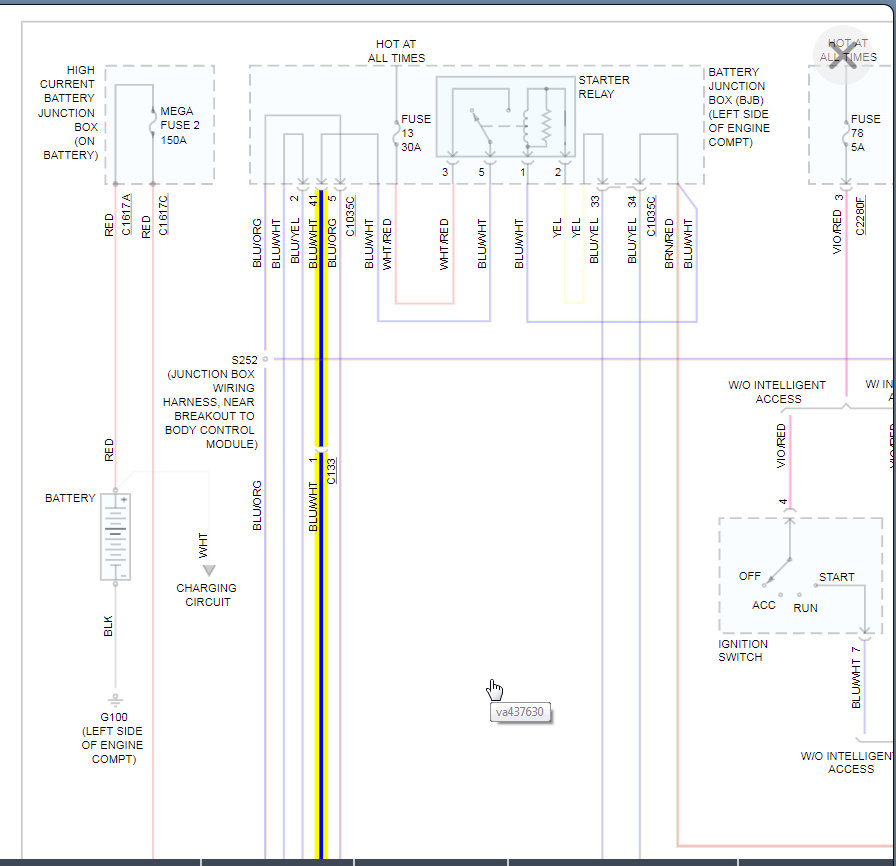

The starter relay circuit shows 3.4 volt on pin 1 and 1.4 volt on pin 2 I believe I am not at shop at moment I have a funeral to attend this AM but will clarify when I get back to shop. The relay should show 12 v on one and ground to the other if I am correct when ignition is in start position. There is no change on these readings in run or start they stay 3.4 and 1.7 no continuity to ground when trying to start and no voltage to opposite side of relay. I can start car with ignition on and power probe to start sol fires right up?

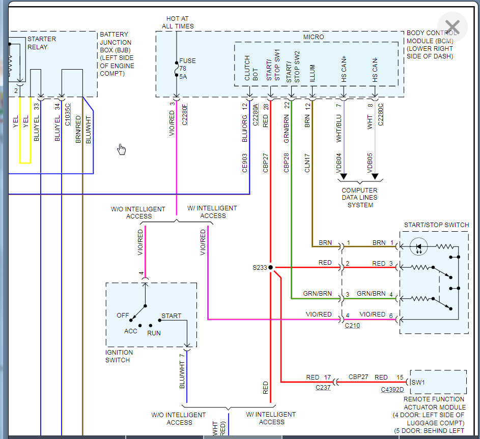

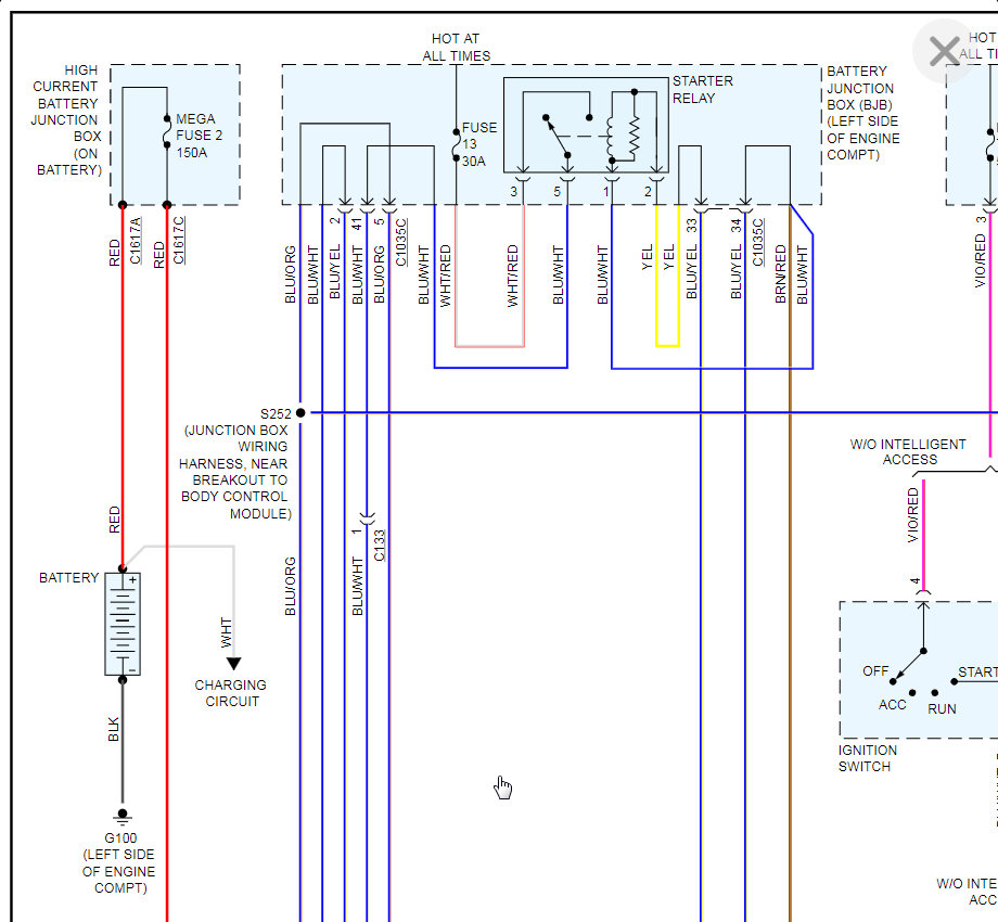

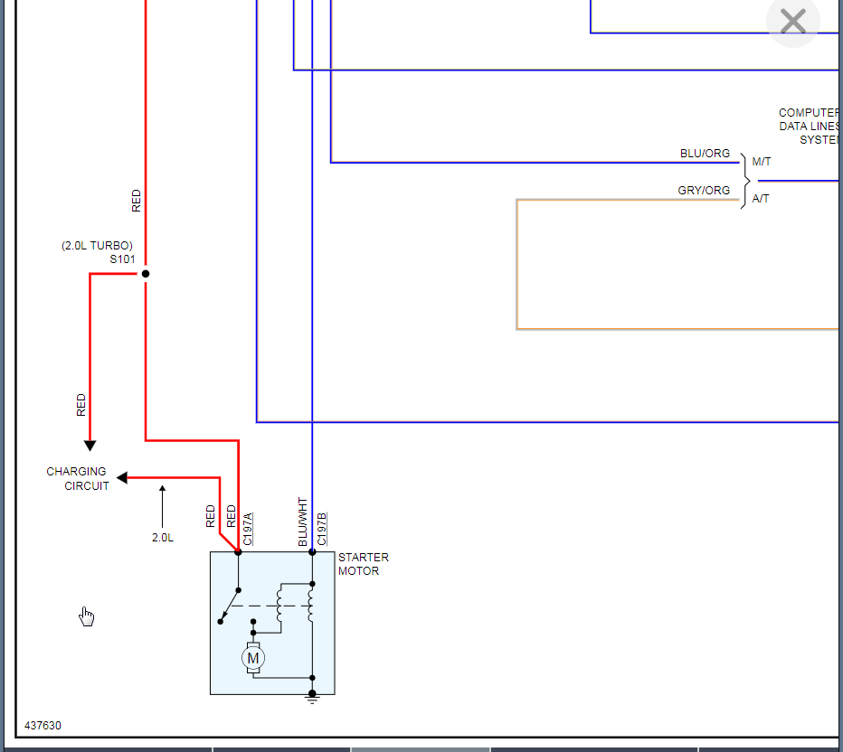

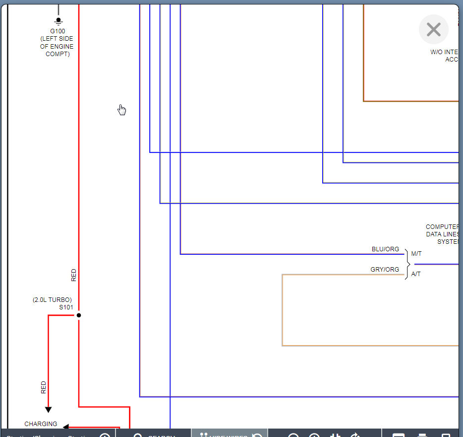

KaseKenny1, bud don't know if you are still getting my messages. I was wondering if you could possibly send a complete wiring diagram of start circuit? I appreciate what you have sent but the circuit is incomplete in both photos and I don't believe that they line up to show termination of all circuits do they?
Jun 5, 2020 at 6:29 AM
I am getting them. I am sorry. I have been traveling all day and have not been in front of my computer to send the actual documents. I will have it up first thing in the morning here on East coast time and send the complete diagram. Sorry for the delay.
Jun 5, 2020 at 1:10 PM
TERRY SCHENK
  • 20 POSTS
No worries my friend. I also am on east coast well west coast of Florida but I sure don't want to press anyone it's great that these sites exist. I have looked locally here for service manual and yeah that ain't happening without special order. I really don't have 3 days to wait for manual that more than likely is not going to tell me anything I don't already know other than wiring diagrams and I would imagine if I stayed on it that would not be an issue. It really amazes me the multitude of electrical issues that this particular model has. I mean from its inception the focus seems to be plagued by mysterious electrical problems that elude even the best of us as a fix for one vehicle more than likely is not going to be fix for another with same symptoms. Anyway as I said no rush don't stress it if you can get them to me early great if not I can wait you are doing me a huge favor and I thank you very much. now get some rest my friend and I will chat with you tomorrow.
Jun 5, 2020 at 1:20 PM
Not a problem at all. I had to break the diagram down into 6 screen shots so you could see it and then I put the complete diagram in one page at the end. Let me know if you need more info and we can go from there.

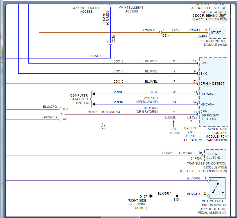

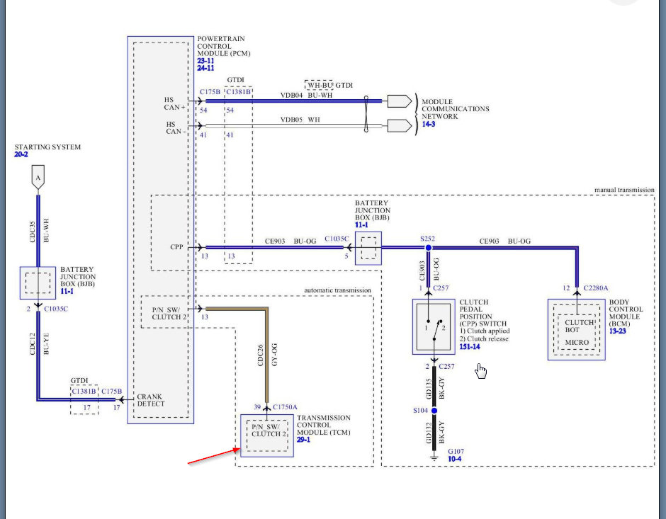

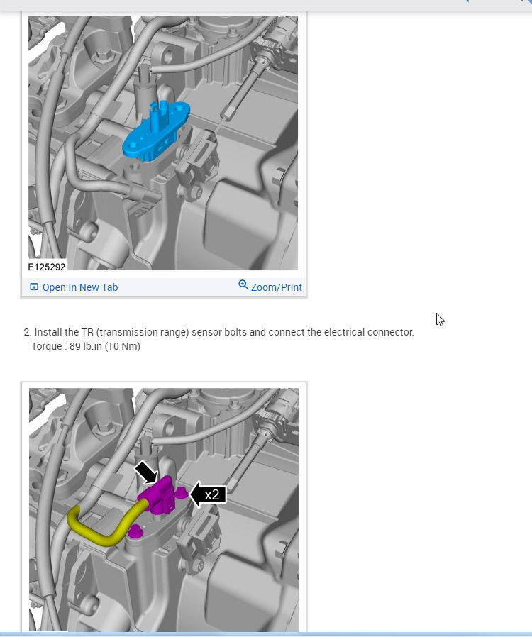

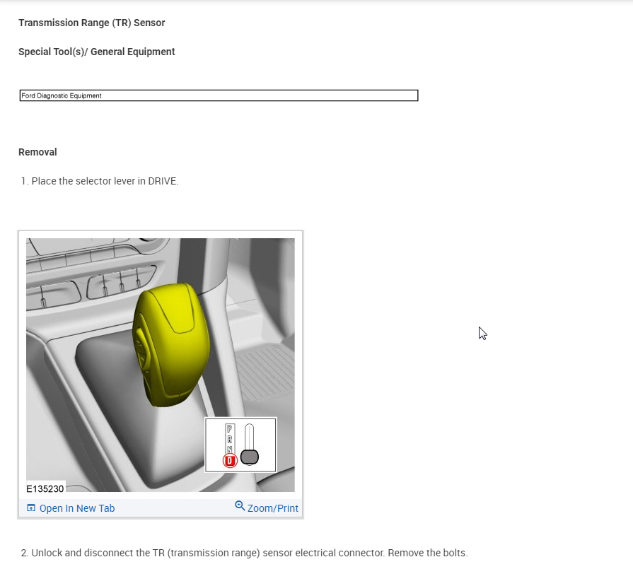

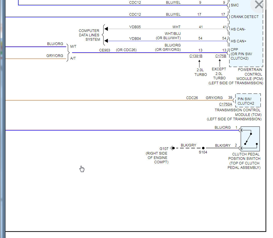

I think I can say it is neutral safety circuit. I can't seem to find a schematic on it and have no idea what the resistance values should be. so I am going to pull a few homegrown tests and see if we can narrow it down to that I mean this circuit is ridiculous the amount of stuff it must go through to actuate a solenoid neutral safety switch. okay, I get that but why the PCM, BCM, TCM, MMM, lol. just kidding but seriously the audio control module really and the ground what is that did we sell every darn thing to China because that looks like some Hyundai kind of stuff there. no wonder they have problems with that awful transmission, no ground.
Jun 8, 2020 at 10:30 AM

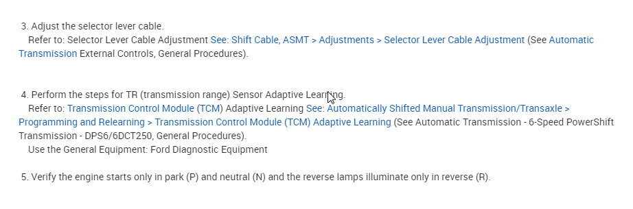

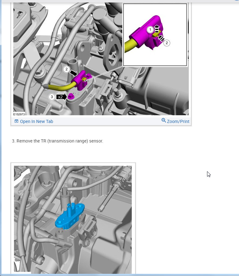

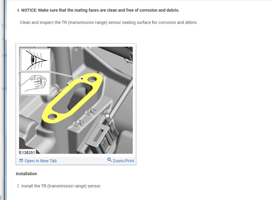

Haha. Yeah they run everything through multiple modules. Hopefully this doesn't complicate it. You don't have a traditional neutral safety switch. The TCM gets the park signal from the transmission range sensor. The TCM then sends the signal to the PCM.
Take a look at this info.

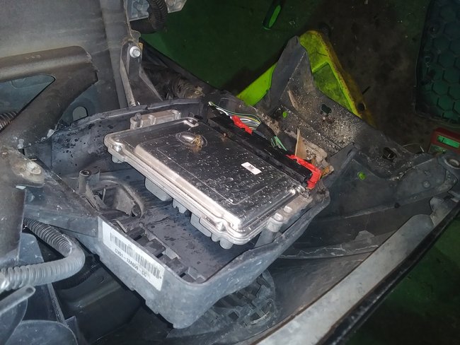

Okay, I'm going to try this reply a 3rd time my phone keeps erasing it if I move even slightly driving me nuts this morning anyway. No it definitely does not complicate things at all I was already checking into the range switch and yes I thought it would function as a neutral start switch but I don't see where it ties into the start circuit this may be my problem but as you can tell for some reason the ingenious minds at ford have found the most ridiculous placement for a control module that they could dream up!! The plastic cover for this was warped and open at top but not bottom and we have had several days of hard rain here as you can see when I pulled cover gravel and sand poured out I am going to go out on a limb and say that water was in box as well. I removed the cover from junction box and checked wiring there and only thing I came up with that was not functioning was return signal from PCM on circuit 33&34 at junction box so does the PCM have total control of power and ground on those two wires or does it rely on a signal from the range switch to allow power and ground to those circuits? I am trying to avoid pulling PCM apart but may be doing that real soon. So if the range switch has a part in allowing the signal from PCM is there any way you could send the schematic for this or literature which ever is easy for you? and let me say your help with this is invaluable and greatly appreciated.
Jun 9, 2020 at 11:16 PM
You are correct the range switch is not a direct part of the starting system. The way that is tied in is through what you are railing against. It is a direct feed to the transmission control module. The TCM then sends a signal to the PCM. The PCM then takes this signal and makes sure the vehicle is in park or neutral when the key is turned. If it is then it allows the voltage to go to the starter and it powers the spark plugs and injectors at the same time.
However, if you are finding the PCM is the issue then I would suggest just replacing it and not take it apart. They are very sensitive and likely not repairable.
Jun 10, 2020 at 11:42 AM

Too late already. disassembled and found a few burnt resistors but have found a way to bypass it for the moment until we can get new PCM. I certainly do appreciate your help with this I am at a loss with Ford decision to install such a delicate piece in front of tire just really dumbfounds me. Although after being in this business for 30 years I have seen a lot of things that those of us who turn wrenches find just ridiculous.
Jun 11, 2020 at 6:58 AM
I should have known you were in the business. You sounded too much like a technician to not be one. Plus if that were the case, I would have agreed to take that thing apart and see what it looked like. Of course they put it in a place just to pick up all the rain and road salt.
