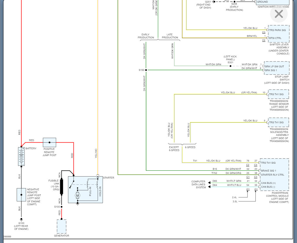

Replaced the head gaskets, spark plugs and wires. The starter worked fine then went to start it the next morning and nothing. No crank no start.

No noise. Doesn't even try to engage.

Yes. Then 2 days after I put them key into ignition then all electrical went haywire.

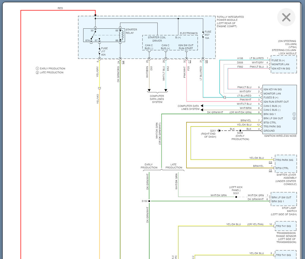

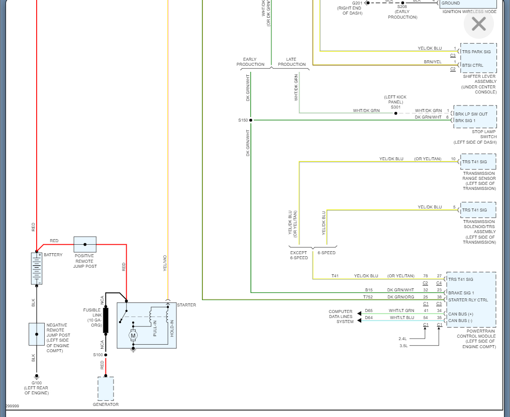

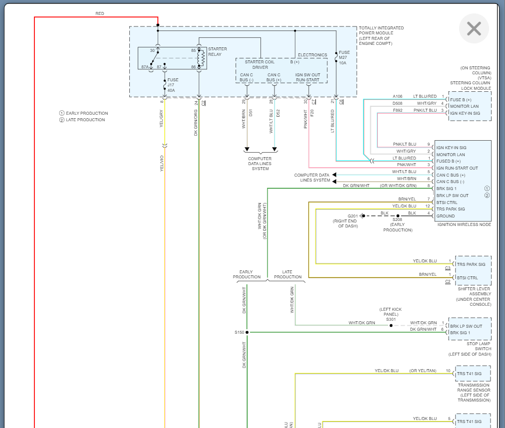

This vehicle is a TIPM based vehicle so if when you turn the key, and the dash comes on, but the starter does not attempt to turn over or click then we need to check the power in two places.
First, we need to check the voltage at the starter, and I suspect you will not have it on the yellow wire.
Here is a guide that will help with this:
Next, we need to go to the relay control wire on the relay and check for ground.
If the PCM is not grounding the relay, then you have an issue with the T41 circuit from the transmission range sensor.
If you don't have the signal to the PCM from this switch, then the PCM will not operate the starter. This is common on these, so I imagine at some point you disturbed this wire and the PCM is not grounding the relay.
Take a look at the wiring diagram below and see if that helps.
