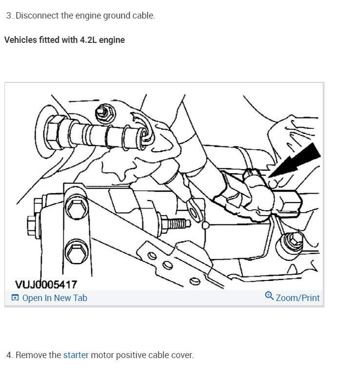

Everything lights up in the car but won't crankover?
Sep 19, 2023 at 2:28 AM
  • 55,433 POSTS

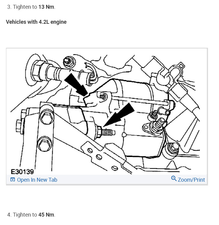

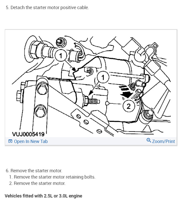

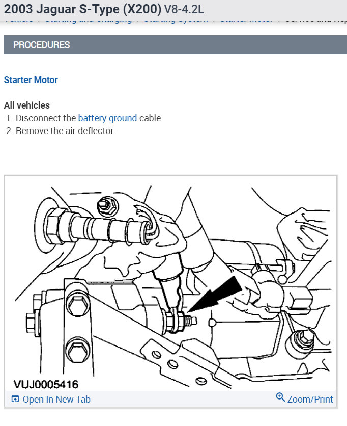

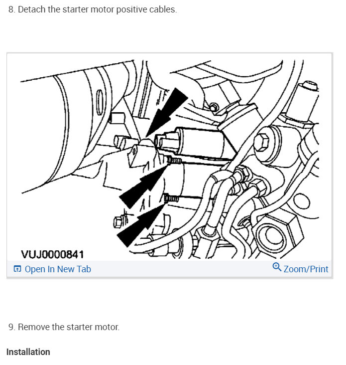

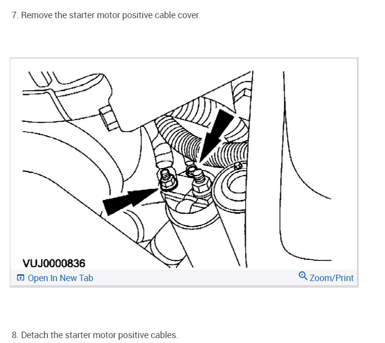

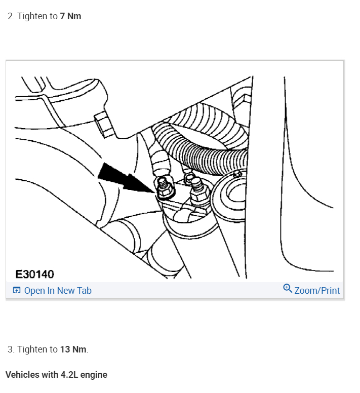

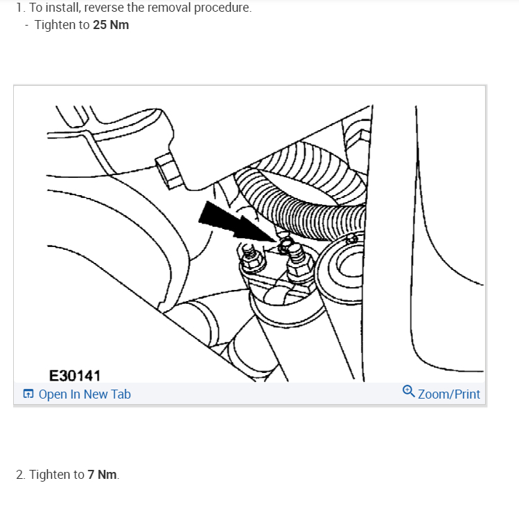

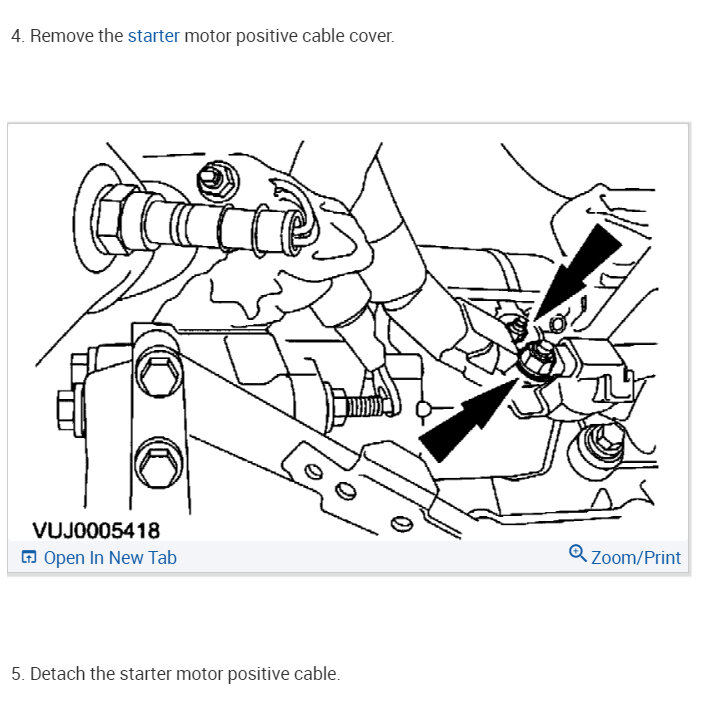

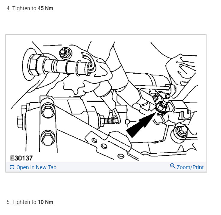

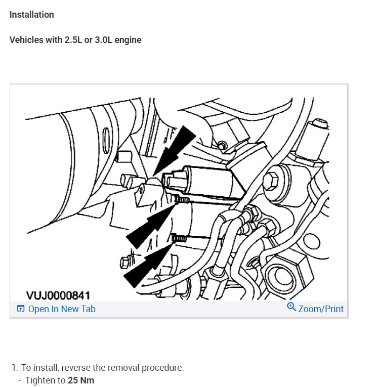

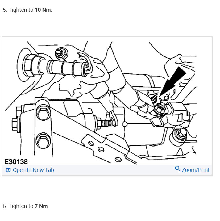

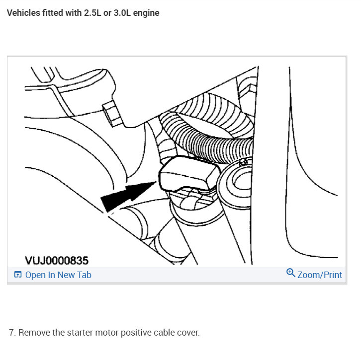

It sounds like the starter has gone bad but to be sure we need to we need to test for power at the starter trigger wire, this guide will help:
Here is how to change the starter motor out. Check out the images (below). Let us know what happens and please upload pictures or videos of the problem so we can see what's going on.
