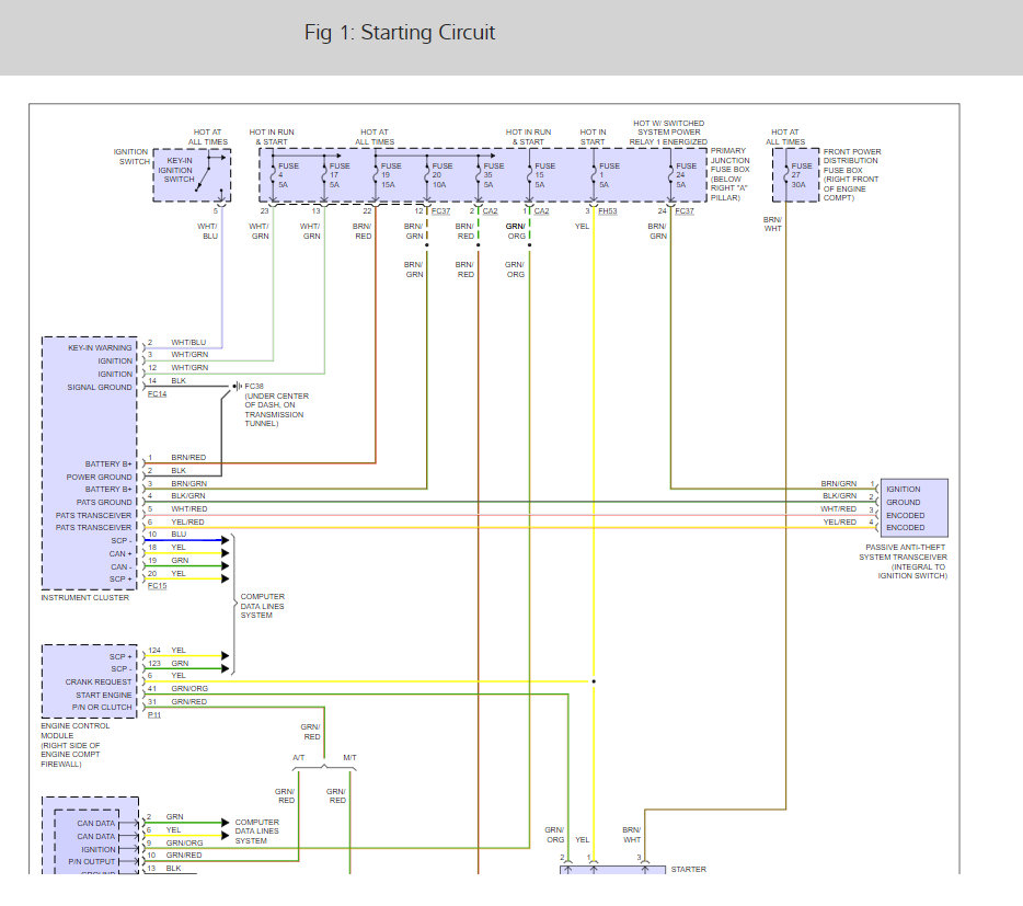

engine no crank, only click new battery and starter
Feb 25, 2009 at 1:51 PM
DAVE H
  • 13,384 POSTS

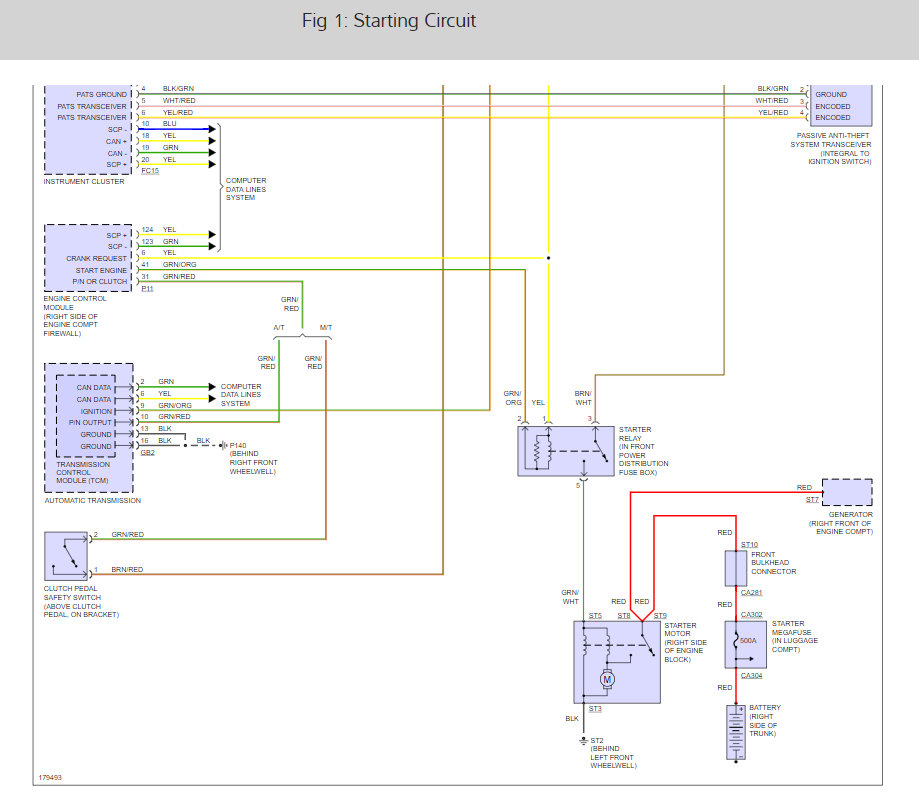

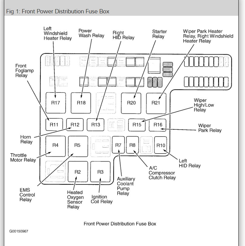

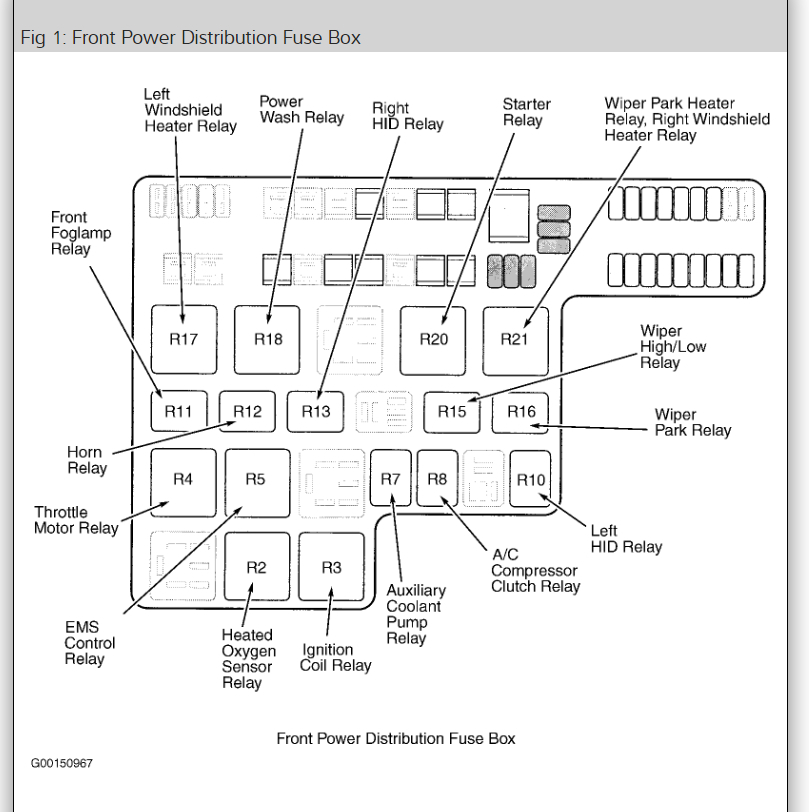

It sounds like the gear range sensor is out but to be sure lets use these guides and the wring diagrams below to help pinpoint the problem. There is a starter relay as well the location is below.
and
If the security light is flashing you can use this guide to help reset the system
https://www.2carpros.com/articles/how-to-reset-a-security-system

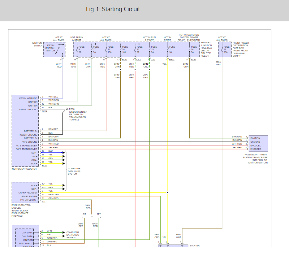

Here are the starter wiring diagrams so you can see how the system works. Check out the diagrams (Below). Please let us know what you find. We are interested to see what it is.

Thanks for this post I had this problem and had to get a new starter relay all fixed! Cost me $34.00
