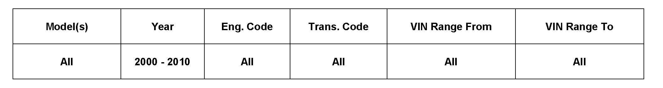

Something is draining my battery. I have no headlights after replacing the switch both headlight assembly’s. Anyways I pulled it in to try and figure out what was draining the battery now it has no power at all.
Dec 15, 2019 at 8:23 AM
  • 110,244 POSTS
First, are you sure the battery is good and the terminals are clean and tight? Have you checked the main grounds from the battery to the engine block and body? Does anything work on the vehicle?
I know there was a technical service bulletin (TSB) put out regarding battery draw issues. Here it is. Take a look through it to see if it helps. Also, the attached pictures correlate with the directions.

2016076, Supersedes Technical Bulletin Group 27 number 07-10 dated September 18, 2007 due to clarification
pic 1
Vehicle Information
Condition
Battery, Discharged, Diagnosis for Excessive Static Current Draw

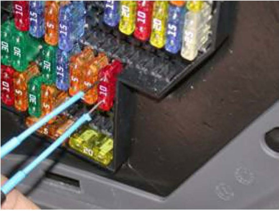

Step 1: Verify Battery Condition
1. Connect Midtronics INC-940 to battery
2. Check and/or charge battery based on applicable Technical Bulletin
3. If INC-940 test fails battery, replace battery before continuing
Step 2: Verify Sleep State Current
1. Connect 50 amp current clamp to VAS 5051A/B
2. Calibrate the current clamp
3. Connect current clamp to negative battery cable with arrow pointing away from battery.
Tip:
Current flows out of the battery to the chassis of the vehicle
4. Close all doors, trunk, or hood latch so vehicle control units detect all doors closed
5. Arm vehicle anti-theft system with remote
Tip:
If vehicle has easy entry handles then it is necessary to keep clear of all handles to avoid bus communication/wakeup message.
^ On vehicles equipped with air suspension, after engine is turned off, the system will stay in standby for up to five minutes

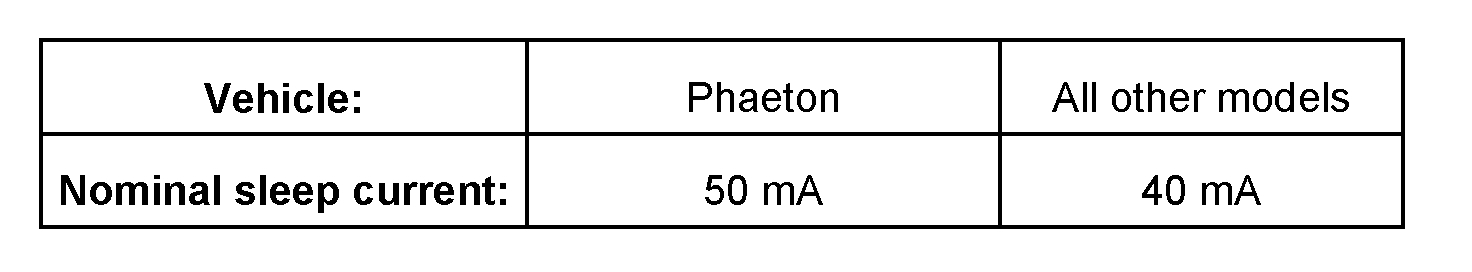

6. Observe sleep state current draw after vehicle is left untouched for TWO HOURS.
7. If after two hours the vehicle exceeds maximum sleep state current draw, proceed to Step 3: Consuming Circuit Isolation. If vehicle does not exceed maximum sleep state current draw, perform a long term (overnight)
measurement test. Record the long term measurement using MIN/MAX setting of scan tool.
^ Excessive current = Measured current > nominal sleep current

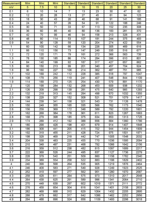

Tip:
Due to the state of the CAN Bus communications in the vehicle, it is no longer acceptable to pull each individual fuse one at a time to try and identify which circuit is consuming current. Removal/ reinsertion of a fuse while vehicle is in a sleep state may wake the bus of the vehicle, and invalidate the test. Identifying "consuming" circuits must be done by measuring a voltage drop across fuse and aligning with the value in matrix located at end of this document.
Starting at interior fuse boxes, perform the following tasks:
Tip:
Use VAS 5051A/B multimeter function, Fluke 83 multimeter, or equivalent.
pic 3

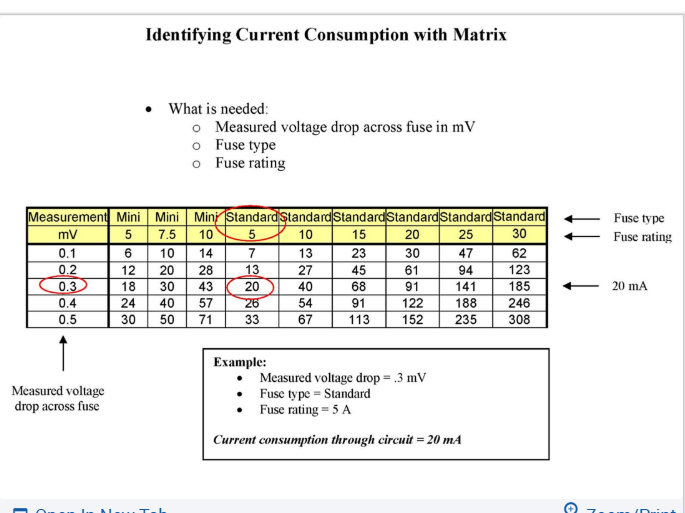

^ Use "mV" scale on meter
^ Measure voltage drop across fuse by placing the positive lead on one side of the fuse and negative lead on other side.

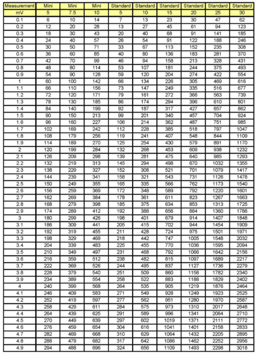

^ Take absolute value of reading of voltage drop (ignore negative signs) and then reference voltage drop chart to determine how much current the circuit is currently consuming. See Identifying Current Consumption
with Matrix attachment.
^ Check all fuses until fuse with approximate excessive current draw is identified
Tip:
Identification of component:
1. Once fused circuit is identified, use service repair and wiring diagram information in ElsaWeb to identify all components on circuit
2. Disconnect components from the circuit one by one and allow sleep current to stabilize after each elimination.
3. Measure vehicle current consumption and voltage drop across fuse once again. If within normal range, as specified in the table (see Current Consumption Matrix attachment), the component with excessive consumption is identified.

Identifying Current Consumption with Matrix

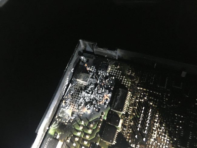

ANTHONY44
Pretty sure I found my problem thanks.
Dec 16, 2019 at 2:14 AM
  • 110,244 POSTS
Wow! I think you did too. Let me know if you need anything other.
