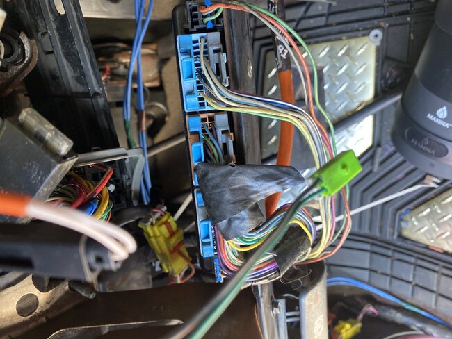

I was waiting for my wife to come out of the store and parked in the shade on a pretty steep incline facing downhill and accidentally fell asleep when she came out and woke me, I panicked and immediately shut the car off. Well, it would not start back and was starting to overheat so from where I tried to start it back, it just went further and further down this incline until I was stuck. Couldn't go anywhere. So, when I tried starting it again. It was only cranking would fire up . I checked the Shrader valve on the fuel rail and nothing was coming out. But I could hear my pump running. So I thought maybe it didn't have enough fuel. Went and got fuel ,I thought maybe it was the ignition switch, but I replaced it and didn't fix it.
put it in, and now it's not even cranking. I tried to just bypass the starter solenoid just to get it home and I could get it to crank that way but will not start up. Oh, and the fuel is gushing out at the rails now so that problem is fixed. Why won't it start up ? I've been stuck here for 5 days now. Maybe the neutral safety switch? I just don't have any experience with those. Please help.
Jun 25, 2024 at 9:14 AM
HAILEEGRACE12
  • 35 POSTS
Also, I cannot figure out where this wire goes under by steering column!!

Okay, sorry for the late reply but I am still stuck on this. I have tried everything I can possibly think of the only logical explanation I can come up with is the security system is keeping it from cranking. I can pull the relay to the starter and jump it with a wire, and it will crank all day but won't start up. But it will not crank at the ignition. It's getting fuel to the rail I've checked every fuse and relay, I've checked that everything is getting voltage it should I've changed the neutral safety switch the ignition switch, the ignition cylinder and key, I've tried to relearn the key with no success, and when I hook a code reader to it, any code reader, it just says error. Please help me here I'm going insane!!

I did it and it stopped flashing but now it's just on continuously without the flashing. Everything else is just the same. Resetting the alarm didn't do anything either. Whoever had the truck before me took out the entire center console and I remember when I first got it, it would stall out if I hit those wires wrong and wouldn't start back. I have checked every one of them already to make sure no bare wire showing, and all are getting the voltage there are supposed to get and they all check out. Don't know if that helps.

That is a good clue, the gear range sensor could be not working. can you turn the key on without cranking or starting the engine then put the car in reverse to see if the reverse lights come on? Also, with the key on the dark green wire should have power when the car is in park.

Okay, I checked to see if the reverse lights were coming on and they are now. This range sensor is the neutral safety switch, the first thing I attempted to replace but from the diagrams u sent, I don't think I did it correctly... It's kind of hard to read that diagram and understand exactly what I did or didn't do. Also, you said the dark green wire should be hot when in park . Are you talking about at the end port?
Jul 19, 2024 at 4:41 PM
HAILEEGRACE12
  • 35 POSTS
I'm sorry that meant to say the reverse lights are not coming on.
Jul 20, 2024 at 8:03 AM
  • 54,837 POSTS
Okay, this means the neutral safety switch is bad or it is not installed correctly. I would check the electrical connector at the switch as well. Yes, the dark green wire should have power when the key is in the crank position. use a test light and probe the wire.

Okay, so, right off I found that the 10A crank fuse is not getting any reading with the key on. I took the fuse out and it's hot on one side, but I put a new fuse in, and that same side isn't hot neither is.
Jul 29, 2024 at 11:29 AM
  • 54,837 POSTS
Good find, it looks like the ignition switch is bad which is what powers the crank fuse. But can you also check the IGN A fuse as well the way you checked the crank fuse?
Jul 29, 2024 at 11:32 AM

Can you please check to see if the red wire into the ignition switch has power when in the crank position?
Jul 29, 2024 at 12:00 PM
HAILEEGRACE12
  • 35 POSTS
The red wire is only getting a reading of 5 v.
Jul 29, 2024 at 1:57 PM
  • 54,837 POSTS
You can see by the wiring diagrams it should have 12 volts, please check the voltage at the IGNA fuse.
Jul 30, 2024 at 9:29 AM
HAILEEGRACE12
  • 35 POSTS
Okay, my mistake. yes, the fuse and the red wire are both getting 12 V.

Do you have power when the ignition switch is in crank mode to the yellow and red wire?
Jul 31, 2024 at 11:55 AM
HAILEEGRACE12
  • 35 POSTS
Yes they both have 12v +
Jul 31, 2024 at 12:02 PM
  • 54,837 POSTS
Does the dark green wire coming out of the neutral safety switch had power when in the crank mode?
