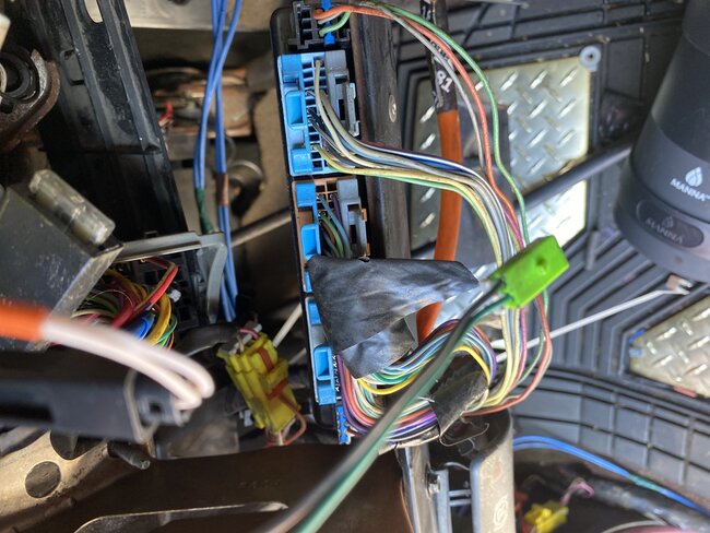

Also, I cannot figure out where this wire goes under by steering column!!

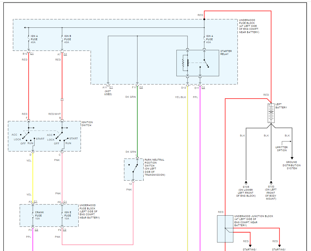

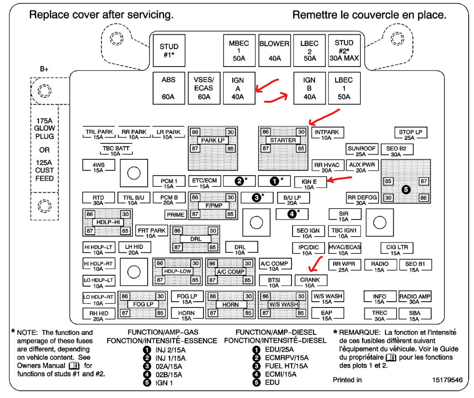

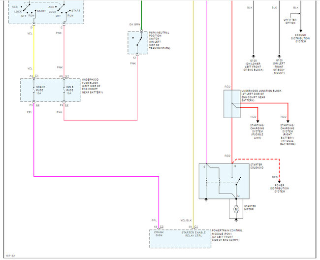

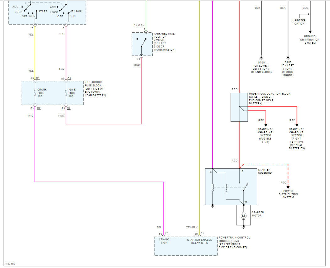

The first thing I would do is lift the hood and check the fuses in the PDC (key on). Here is a guide to help you. Also try cranking the engine over in neutral, this can help test the gear range sensor, (neutral safety switch):
Also please go over this guide can well:
Here are the fuse locations which you should check fuses: IGN a, IGN b, IGN e, and the crank fuse. There is also a starter relay you can try swapping out. I have also included the starter motor wiring diagrams so you can see how the system works. Check out the images (below). Please upload pictures or videos in your response to any problems so we can see what to help you with.

Okay, do you have power at the IGN A, IGN E, IGN B and the crank fuse when the key is in the crank position? This guide can help us test them for power. Also, let's try swapping the starter relay out as well to see if anything changes.
Please go over this guide and get back to us.
Jul 9, 2024 at 2:33 AM
HAILEEGRACE12
  • 35 POSTS
I have power at all the fuses you listed also swapped the starter relay, no changes.

When the key is in the crank position do you have power to the purple wire at the starter?
Jul 11, 2024 at 3:03 AM
HAILEEGRACE12
  • 35 POSTS
It took me a min to be for sure but there is power but not very much. I hooked it up to a secondary power source to make sure and only getting about 2 volts to the purple wire at the starter when the key is in the crank position.
Jul 11, 2024 at 1:16 PM
  • 55,841 POSTS
What happens if you put 12 volts to the starter? Also, is the battery good? I would remove the battery and have it checked at the autoparts store. The starter relay is what powers the solenoid when the key is cranked over.
Jul 12, 2024 at 2:14 AM
HAILEEGRACE12
  • 35 POSTS
I already had the battery check and if I pull the relay and use a jump wire, I can make the starter crank, but it will not start. Cranks really strong but doesn't even try to start up. I even tried it with starter fluid and no change from when I tried without it.
Jul 12, 2024 at 2:18 AM
HAILEEGRACE12
  • 35 POSTS
I have not tried putting 12v to that purple wire, isn't that just a data line?
Jul 12, 2024 at 2:19 AM
  • 55,841 POSTS
If you check the wiring diagrams above, you can see the purple wire goes to the starter solenoid which is the trigger wire.

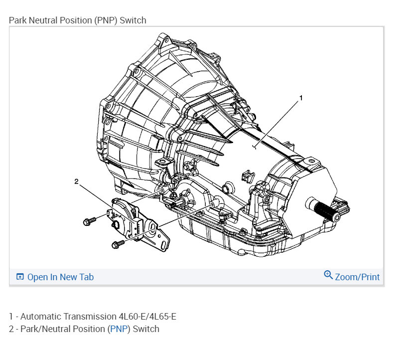

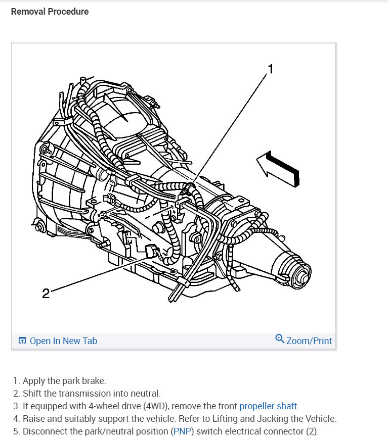

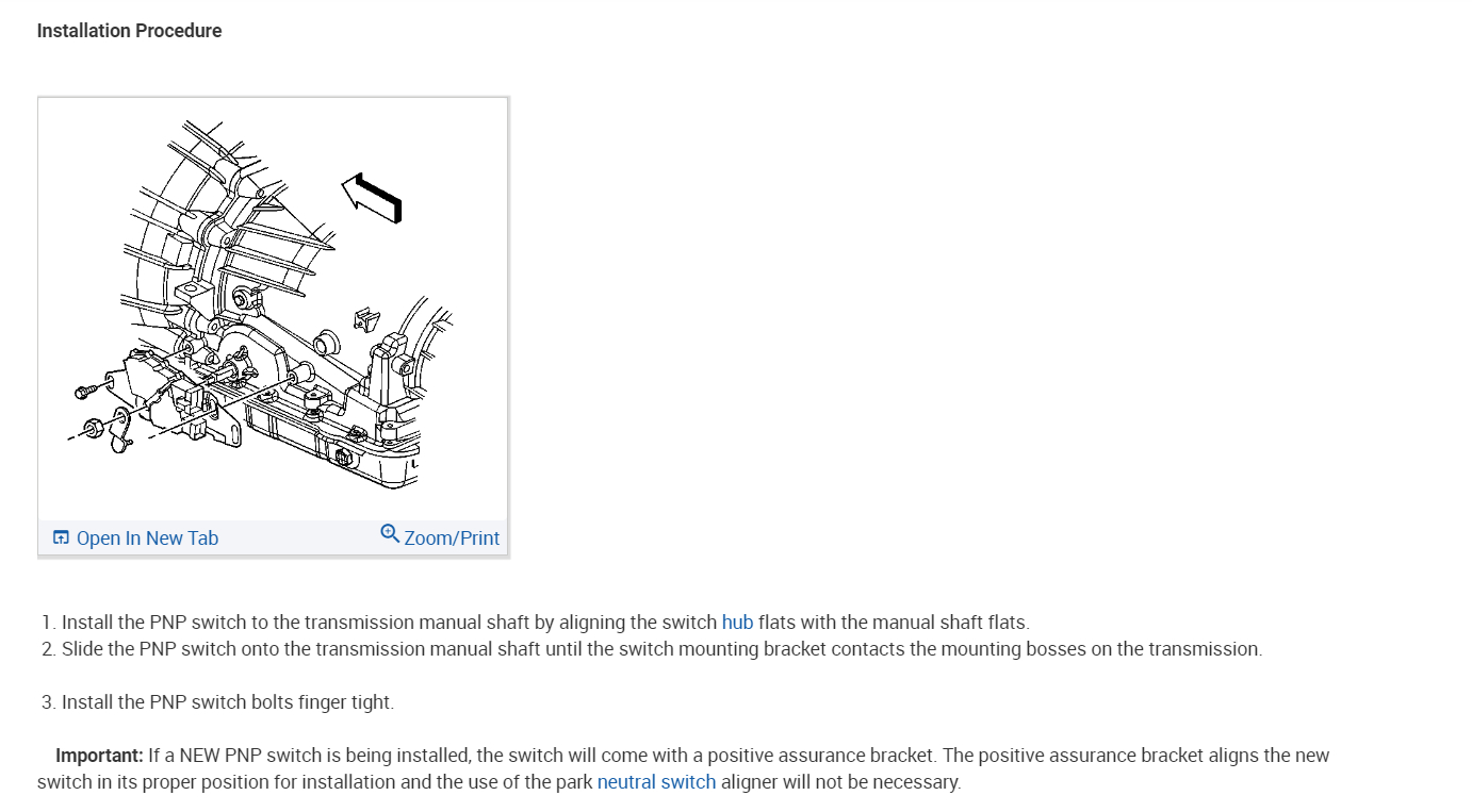

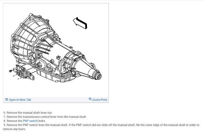

That is a good clue, the gear range sensor could be not working. can you turn the key on without cranking or starting the engine then put the car in reverse to see if the reverse lights come on? Also, with the key on the dark green wire should have power when the car is in park.
Here is the location of the gear range sensor and how to change it out if needed.
Jul 18, 2024 at 3:56 AM

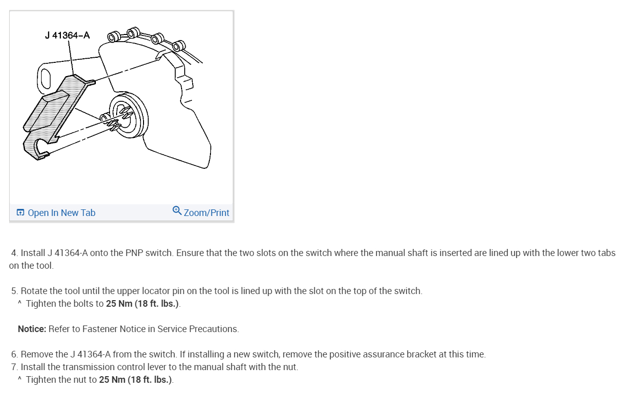

Okay, I checked to see if the reverse lights were coming on and they are now. This range sensor is the neutral safety switch, the first thing I attempted to replace but from the diagrams u sent, I don't think I did it correctly... It's kind of hard to read that diagram and understand exactly what I did or didn't do. Also, you said the dark green wire should be hot when in park . Are you talking about at the end port?
Jul 19, 2024 at 9:41 AM
HAILEEGRACE12
  • 35 POSTS
I'm sorry that meant to say the reverse lights are not coming on.
Jul 20, 2024 at 1:03 AM
  • 55,841 POSTS

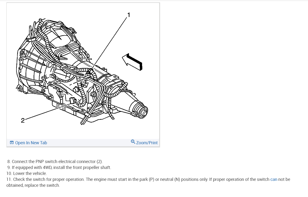

Okay, this means the neutral safety switch is bad or it is not installed correctly. I would check the electrical connector at the switch as well. Yes, the dark green wire should have power when the key is in the crank position. use a test light and probe the wire.
Jul 20, 2024 at 3:21 AM
HAILEEGRACE12
  • 35 POSTS
So, I went and bought a brand new NSS and installed it correctly but with no changes. I'm wondering what else would be the cause of the gear indcater not working and why still have no communication with anything I plug into the obd port. Is there a way I can just bypass this NSS altogether? I know it's not ideal and not the safest thing to do, but no one else will be driving my truck and I don't plan on selling it or anything so if I could just get it back drive able then I could focus on fixing it or anything else for that matter. Unless you have something else better that you think could be the culprit.

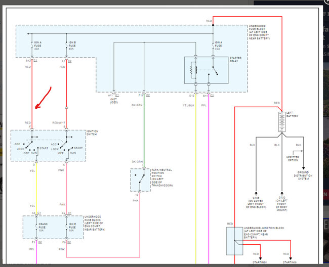

Okay, so, right off I found that the 10A crank fuse is not getting any reading with the key on. I took the fuse out and it's hot on one side, but I put a new fuse in, and that same side isn't hot neither is.
Jul 29, 2024 at 4:29 AM
  • 55,841 POSTS
Good find, it looks like the ignition switch is bad which is what powers the crank fuse. But can you also check the IGN A fuse as well the way you checked the crank fuse?
Jul 29, 2024 at 4:32 AM
HAILEEGRACE12
  • 35 POSTS
Yes, all the other fuses were getting power.
Jul 29, 2024 at 4:46 AM

Can you please check to see if the red wire into the ignition switch has power when in the crank position?
Jul 29, 2024 at 5:00 AM
HAILEEGRACE12
  • 35 POSTS
The red wire is only getting a reading of 5 v.
Jul 29, 2024 at 6:57 AM
  • 55,841 POSTS
You can see by the wiring diagrams it should have 12 volts, please check the voltage at the IGNA fuse.
Jul 30, 2024 at 2:29 AM
HAILEEGRACE12
  • 35 POSTS
Okay, my mistake. yes, the fuse and the red wire are both getting 12 V.

Do you have power when the ignition switch is in crank mode to the yellow and red wire?
Jul 31, 2024 at 4:55 AM
HAILEEGRACE12
  • 35 POSTS
Yes they both have 12v +
Jul 31, 2024 at 5:02 AM
  • 55,841 POSTS
Does the dark green wire coming out of the neutral safety switch had power when in the crank mode?
