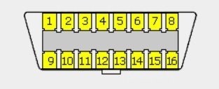

Note the image. You said voltage was detected. In the picture, pin 16 is voltage, hot all the time, you can use a test light to check for voltage. Pins 4 and 5 are grounds, check for ground.
The other thing I know to check for is serial data. A digital logic probe should react to serial data and is safe. The logic probe will make all kinds of weird sounds to let you know there is activity, You will not know what it means, just that there is activity.

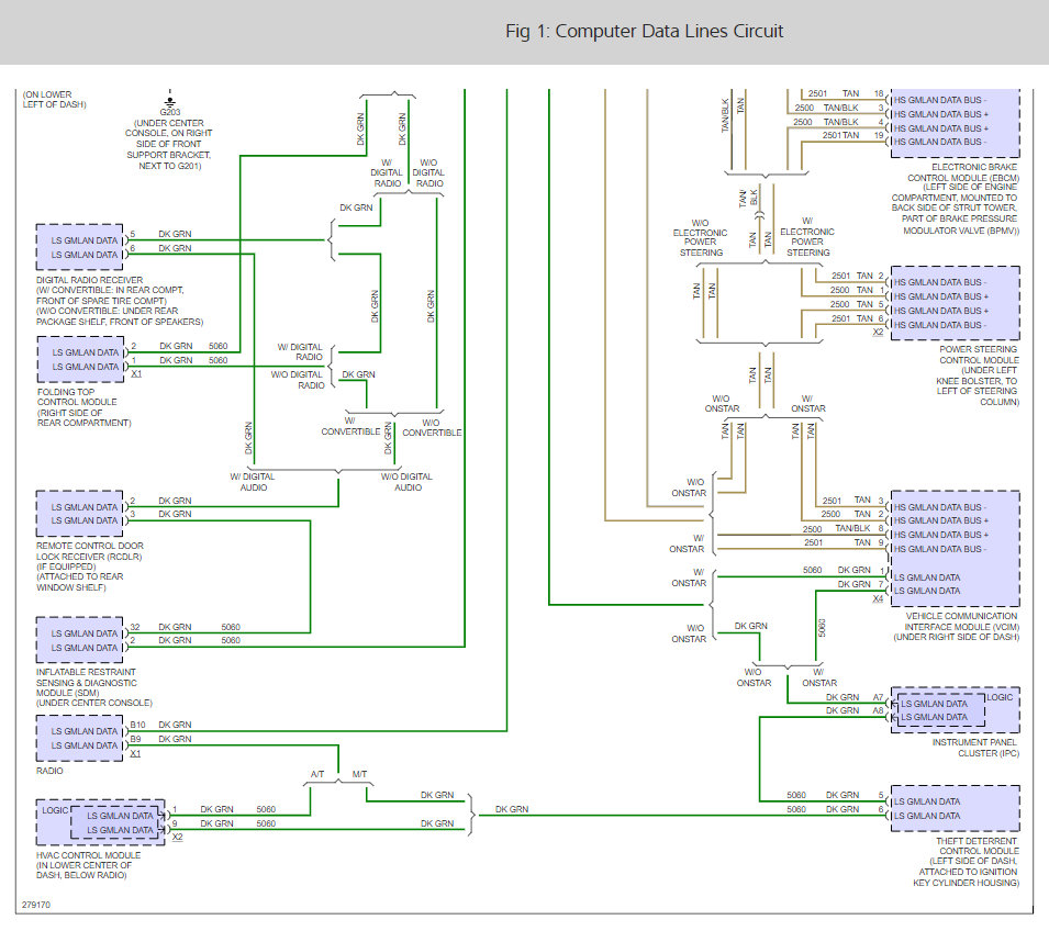

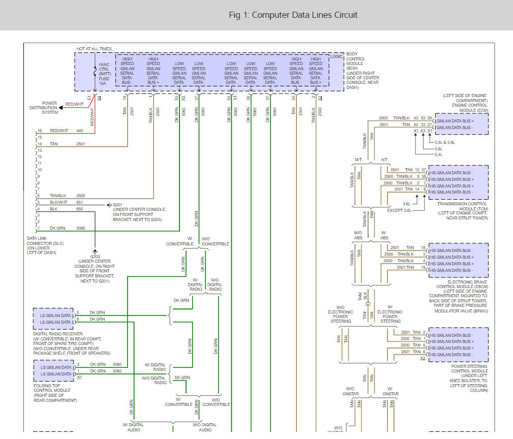

There is a fuse for the HVAC control that can be out not giving power to the ALDL connector.
Here are two guides and some diagrams (below) to help you run some simple tests. Fuse #13 and #16

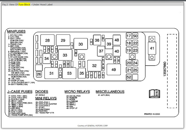

In the under hood fuse box there should be a fuse labeled hvac cont or batt it is 10 amp if that is blown the scan tool won't communicate with the computer.
