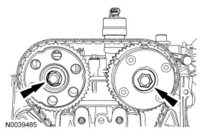

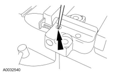

My son's vehicle started running rough and shaking. Checked and replaced plugs. Seemed to help a little but still ran rough. Took the car into the shop. They reported no compression at all in two adjacent cylinders. They were going to check to see if pistons are moving and maybe pull the valve cover. It seems odd there is no compression at all and in two cylinders. They also put oil in the holes but still no reading. Is it worth digging deeper into this problem or find a used motor to replace it?
Jan 30, 2019 at 10:49 AM
  • 110,240 POSTS
If there is no -0- psi compression, either you have open valves or there are holes in the tops of the pistons. If the pistons weren't moving because of damage, you would hear it.
A bad head gasket isn't going to cause no compression. The wet compression test is to check for piston ring condition. Even of there were no piston rings left, you would have some compression. That leaves the valves.
Now, many engines today are called interference engines. What the means is this. If the timing belt or chain breaks or jumps time, most times valve or piston damage is done. However, and this is good news, this engine is not an interference engine. That leads me to my next suspect.
The engine has a timing chain which usually will last the life of the vehicle. However, if a tensioner failed and the chain jumped, the engine will be out of time. In that event, it is possible that a valve is opening when the piston is coming up on a compression stroke. That would render the compression you found, 0.
If this problem happened all at once, that if my first suspect. If a valve failed, the chances of it happening in two cylinders at the same time is really slim.
Before taking the engine apart, I would first check the timing chain and confirm the timing is correct.

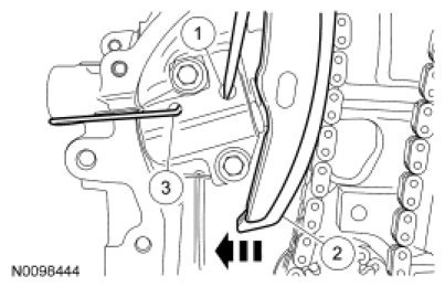

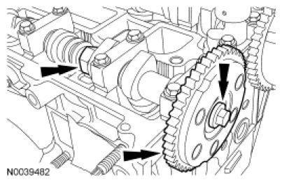

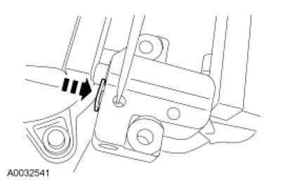

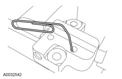

3. Compress the timing chain tensioner in the following sequence.
1. Using a small pick, release and hold the ratchet mechanism.
2. While holding the ratchet mechanism in the released position, compress the tensioner by pushing the timing chain arm toward the tensioner.
3. Insert the paper clip into the hole to retain the tensioner.
Picture 1

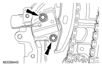

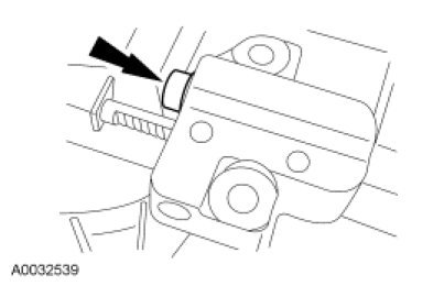

4. Remove the 2 bolts and timing chain tensioner.
Picture 2

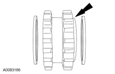

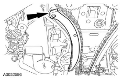

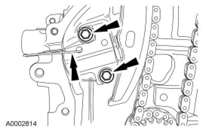

5. Remove the timing chain tensioner arm.
Picture 3

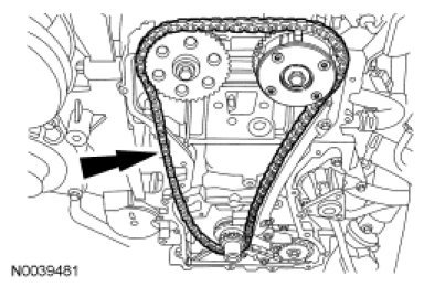

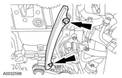

6. Remove the timing chain.
Picture 4

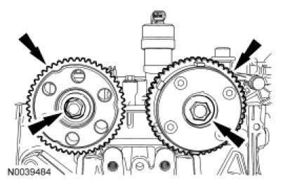

7. Remove the 2 bolts and the timing chain guide.
Picture 5

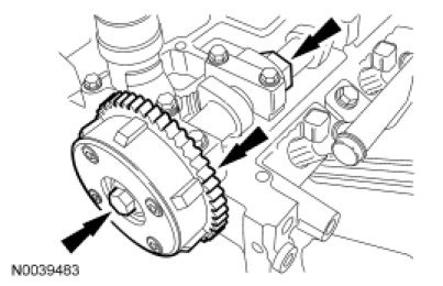

8. NOTICE: The Camshaft Alignment Plate is for camshaft alignment only. Using this tool to prevent engine rotation can result in engine damage.
Using the flats on the camshaft to prevent camshaft rotation, remove the bolt and the exhaust camshaft sprocket.
Picture 6

With all of that being said, I don't feel that the problem is too major. If a cam shaft would have broken (there are two) you would hear it, so I really feel it jumped time.
