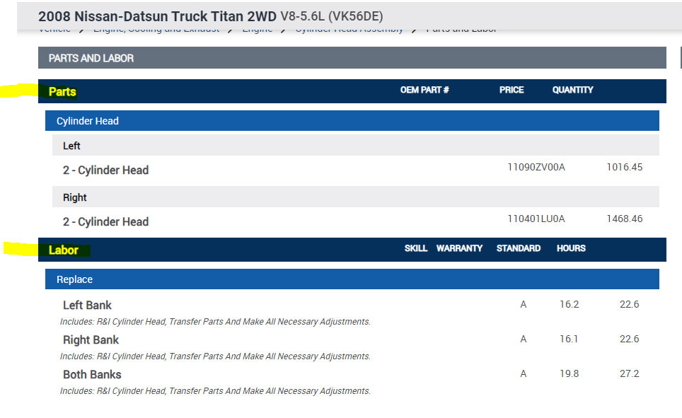

As far as the cylinder head, I attached the parts and labor information below. Note the labor is somewhat high. Multiply that times the shop rate for labor costs.
