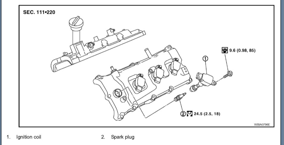

Will not crank over. any common problems with this issue "no crank"?
Oct 18, 2016 at 9:34 AM
There are not any common issues that is the same correction for all most of them. However, there are only a certain things that will cause something like this, so we need to start running through them to find out what we have and don't have.
Here is a guide that will get us started:
The most common cause of this is a fuel pump or pressure issue so that is what I would suggest we start with.
If that is okay, then we need to pull a spark plug and hold it against the block and find out if we have any spark.
I attached the info below to show this, but it is pretty simple on this engine as you just need to remove the coil. So, if you want to see if the coil is sparking to a good ground location on the engine block, then that would be fine.
Please see the info below on this and let us know what you find, and we can go from there.
