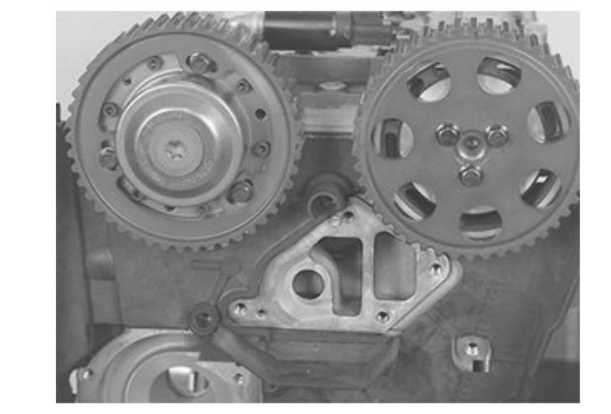

Removing the camshaft variable valve timing unit / timing belt pulley
Camshafts with variable valve timing
Install tool 999 5452 CAMSHAFT ADJUSTMENT TOOL See: Vehicle > Electrical / Mechanical Repair > 999 5452 Camshaft Adjustment Tool at the rear of the camshafts.
Remove the plug at the front edge of the variable valve timing unit (Tx 55).
Remove the center screw from the variable valve timing unit (Tx 55).
Carefully pull out the camshaft pulley with the variable valve timing unit.
Camshafts without variable valve timing
Remove the screws.
Pull off the camshaft pulley.
Remove tool 999 5452.
Remove the inner timing cover.
Caution! The camshafts must not be turned when the timing belt has been removed.

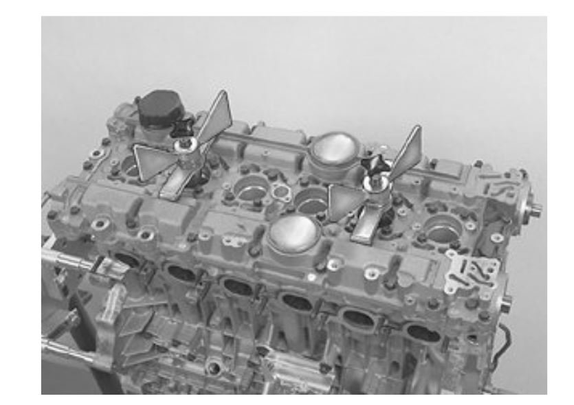

Removing the camshaft cover
Remove the control valve from the variable valve timing unit.
Remove the spark plugs from cylinders 2 and 5.
Install 2 tools . Leave a 2-3 mm gap to the camshaft cover. Ensure that the screw in the spark plug well is tightened as far as it will go.
Remove all the screws securing the camshaft cover to the cylinder head.

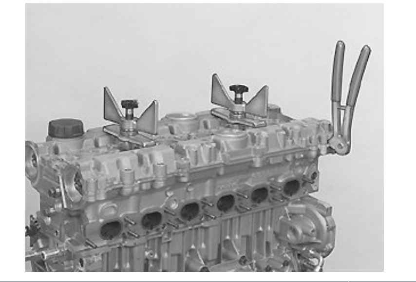

Remove
camshaft cover with pliers 999 5670 Pliers See: Vehicle > Electrical / Mechanical Repair > 999 5670 Pliers at the stop lugs.
Start at cylinder 1 and work alternately backwards
the wing nuts approximately 2 turns.
Repeat the procedure with the pliers.
Remove
tool 999 5454
the camshaft seals at both the front and rear edges
the camshaft cover
the camshafts. Work loose and lift at the same time.
Note! Take care not to damage the thrust washers.

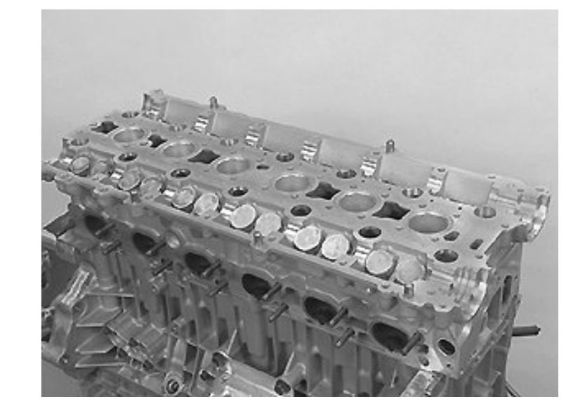

Removing the cylinder head
Remove the pipe screws for the coolant heated crankcase ventilation at the rear edge of the cylinder head (applies only to B6284T).
Slacken off the screwed joint for the cylinder head. Start at the sides and work alternately towards the center.
Lift out the cylinder head.
Note! Take care not to damage the mating surfaces.
