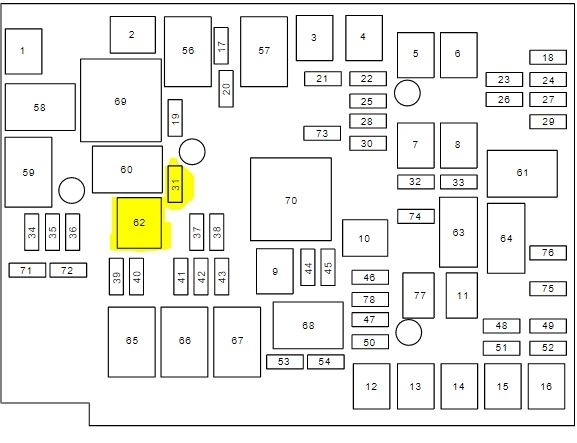

2015 CHEVROLET EQUINOX
30,000 MILES • 2.4L • 4 CYL • 2WD • AUTOMATIC
SEAN HORGAN
I don't think the compressor is turning on. The engine cooling fan also does not turn on. The display inside the car says A/C on but no cold air just heat or air temperature air.

It's a bit odd that this new of a vehicle would have lost enough Freon to prevent the compressor from engaging. However, I don't know the mileage so it is possible. Here is a link that explains the most common cause for an AC not to work:
Lets start with the AC compressor fuse (#31) and the relay (#62). Both are located under the hood in the power distribution box. I have attached a pic of the fuse box and highlighted both the fuse and the relay. If you can find another relay with the same part number, switch the two and see if that makes a difference, but check the fuse first.

If you find the fuse and relay to both be good, then we need to check if it is low on Freon. The best way to do this is with an AC manifold gauge set. I realize that most people don't own one, so I will provide directions for adding Freon. When you do this, the unit you get should have a gauge on it. If you purchase the small cans that require the hose to be attached, make sure you have a hose with a gauge so you will know if the pressure is too low or okay.
