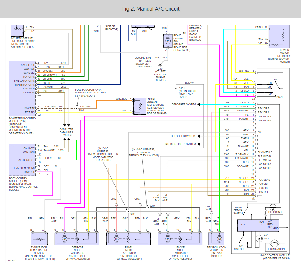

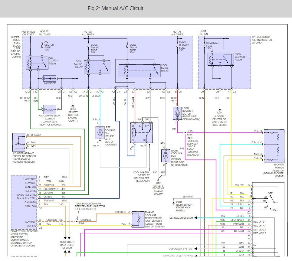

I have a problem trying to get the blower motor for the heater/ac to work. Checked all fuses. Replaced relays, switch, resistor, and even the fan motor. I cant find anyone that has a wiring diagram, even the dealership. Don't know what else to check for and wife not real happy.
Dec 4, 2009 at 4:37 PM
BLUELIGHTNIN6
  • 16,542 POSTS
The diagram is below.. I can send a better view of it if you list your email address. I also have some troubleshooting steps for your inoperative blower motor..would you like those as well?
https://images.2carpros.com/forum/automotive_pictures/261618_Noname_1220.jpg
https://images.2carpros.com/forum/automotive_pictures/261618_Noname2_357.jpg

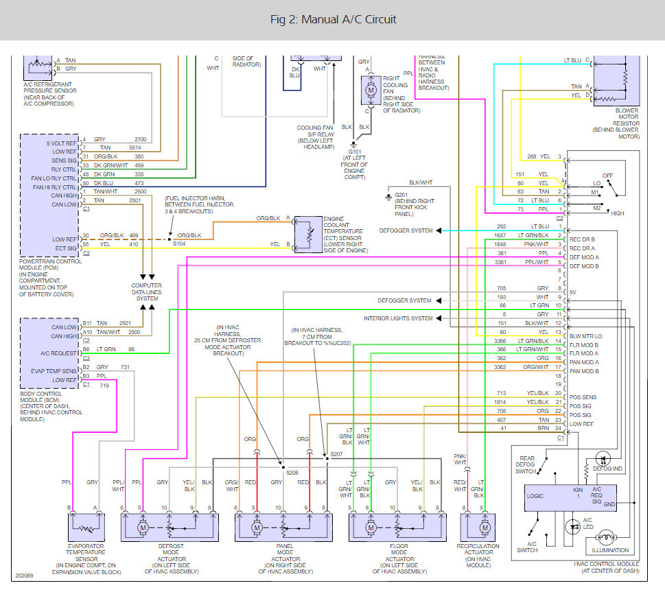

Here are the blower motor wiring diagrams for all to see and use (below)
Guides to check wiring:
and
