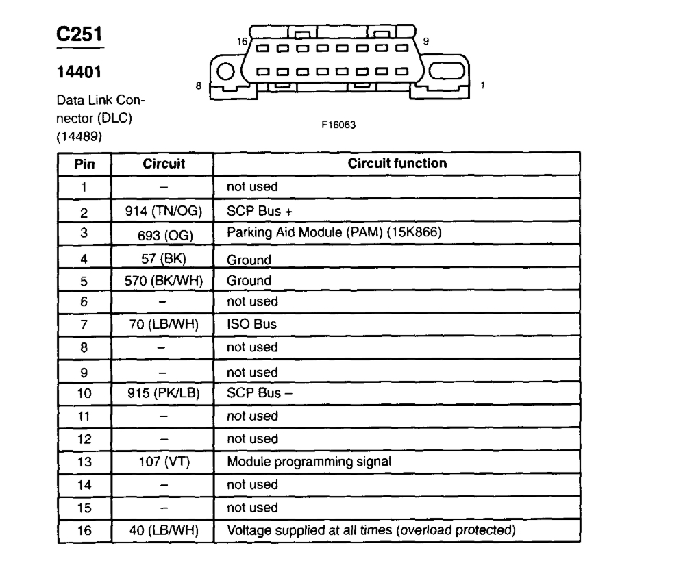

Are you sure it's an OBD 1 system? In the United States law for all vehicle's to be OBD 2 compliant was 1996. If it is an OBD2 system it would have a 16 pin Data Link Connector[DLC]. I have included a diagram of what it would look like with a pin out chart in the diagrams down below.
Thanks,
Alex

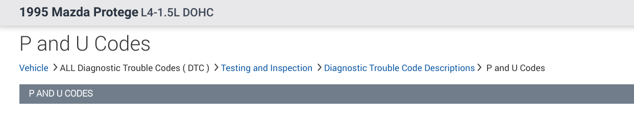

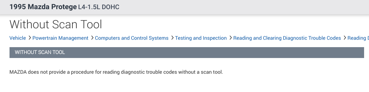

SCGRANTURISMO
  • 4,897 POSTS

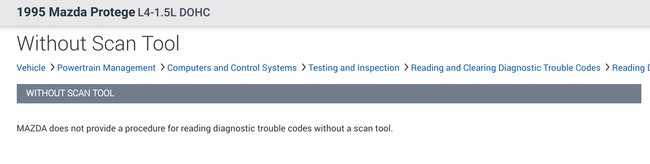

So it looks like you are going to have to get a OBD 1 code reader. I tried to find the instructions for pulling codes from a 1995 Mazda Protege with a 1.5L engine, and this is what I got in the diagrams down below.
Thanks,
Alex

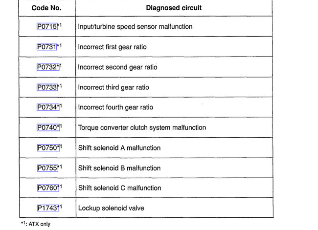

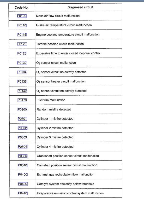

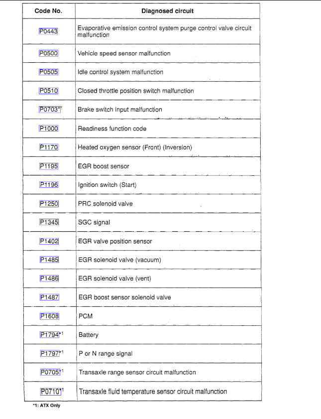

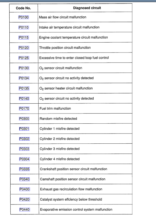

SCGRANTURISMO
  • 4,897 POSTS
Hello again,
Sure, why not. As long as you have the correct adapter. In the diagrams down below I have included the list of P and U codes that the OBD 1 system will store in the Powertrain Control Module[PCM] if there is a problem. Please report back with how everything turns out and I hope that this helps.
Thanks,
Alex
2CarPros
