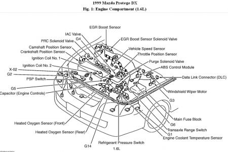

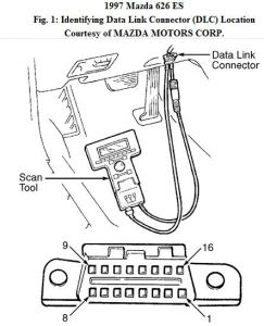

There are 2 DLC, one at left rear of engine compartment and the other (DLC 2) is under lower left side of dash.
Sep 28, 2010 at 9:50 AM
BRYAN DUNFORD
  • 5 POSTS
Bear with me please what is DLC or what does it look like.
thanks Bryan
Sep 29, 2010 at 1:40 PM
KHLOW2008
  • 41,814 POSTS
DLC = Data Link Connector and it is where scanners are plugged in to retrieve for trouble codes or analyse the engine operations. It is a 16 pin connector, 8 pins in 2 rows. It should look something link the one shown in 2nd diagram.
