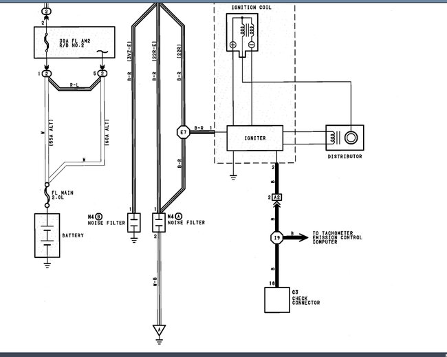

No click , no crank, no start, no dash lights
1990 TOYOTA PICKUP
175,000 MILES • 3.0L • 6 CYL • 2WD • MANUAL
CLIF MORRIS
  • 23 POSTS

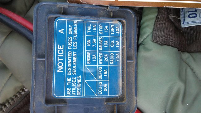

I do have headlights and hazard lights but also no turn signal lights. I have a brand new battery. I put the key into the ignition and nothing, not even the check engine light comes on. Appears no power to the ignition switch. How can I test the fusible link/80 amp fuse coming from the fuse box under the hood? and would this be an option if I am not getting any power to my ignition switch. I have a multi-meter but not certain what to put it on or a test light and also how to test the ignition switch from the switch itself to see if it has gone out. I am also not getting any lights on the test light for the fuse box below.

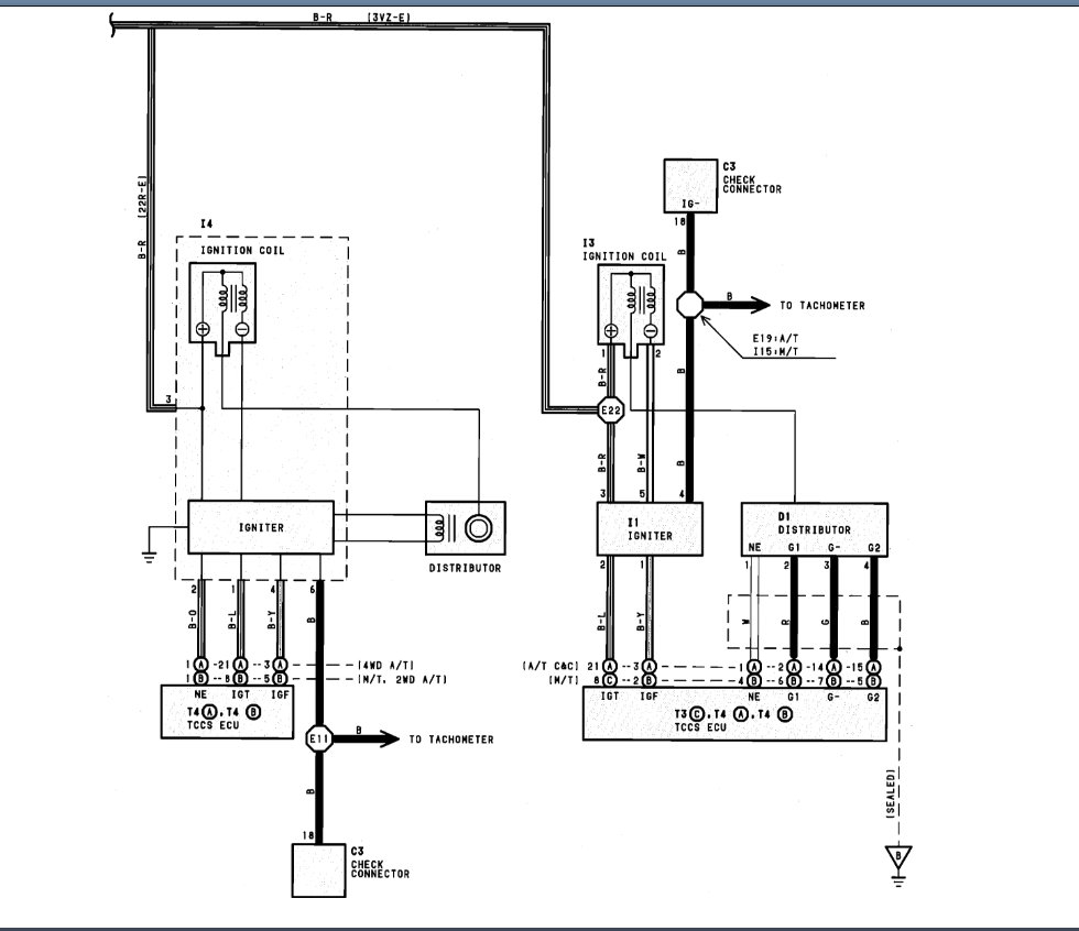

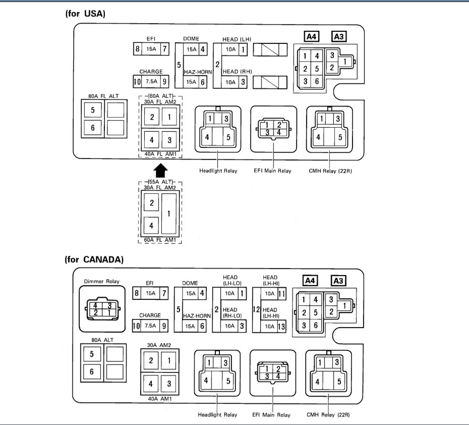

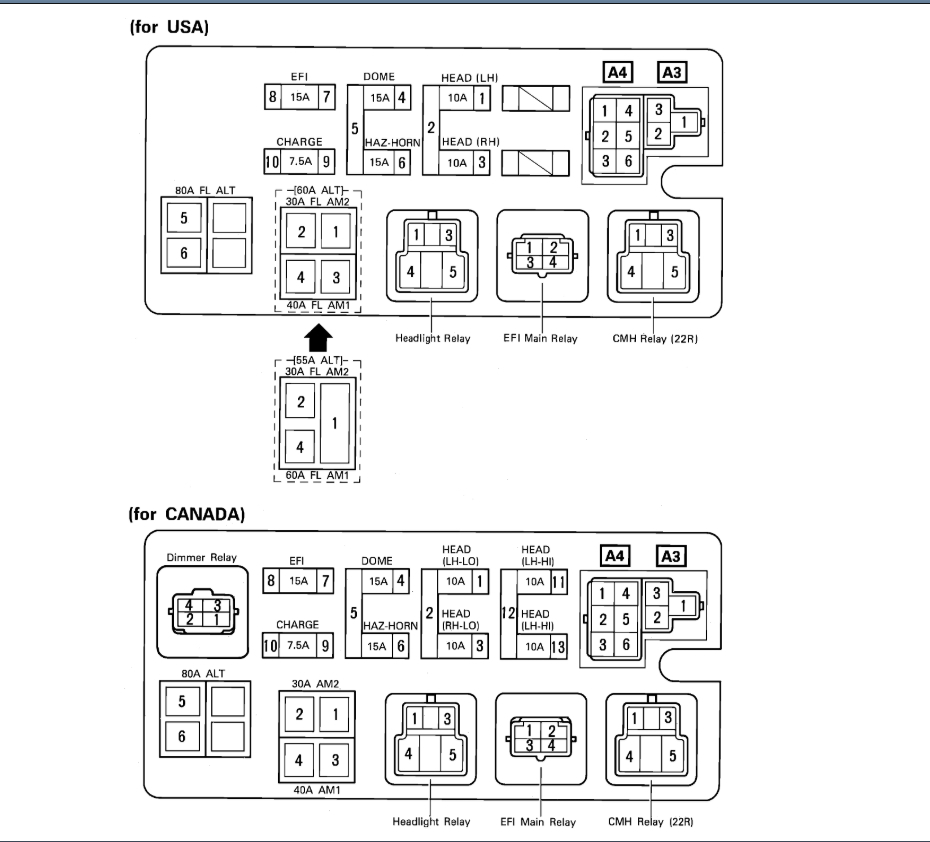

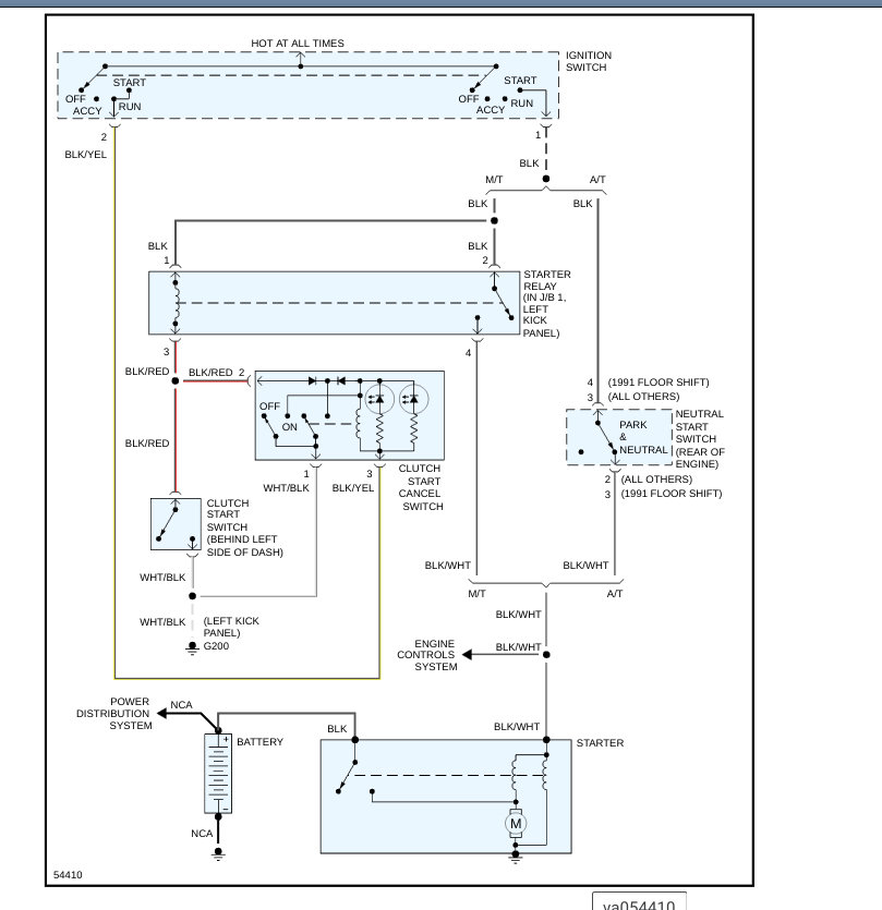

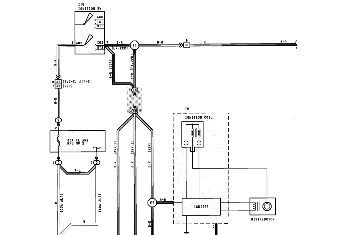

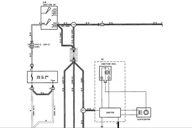

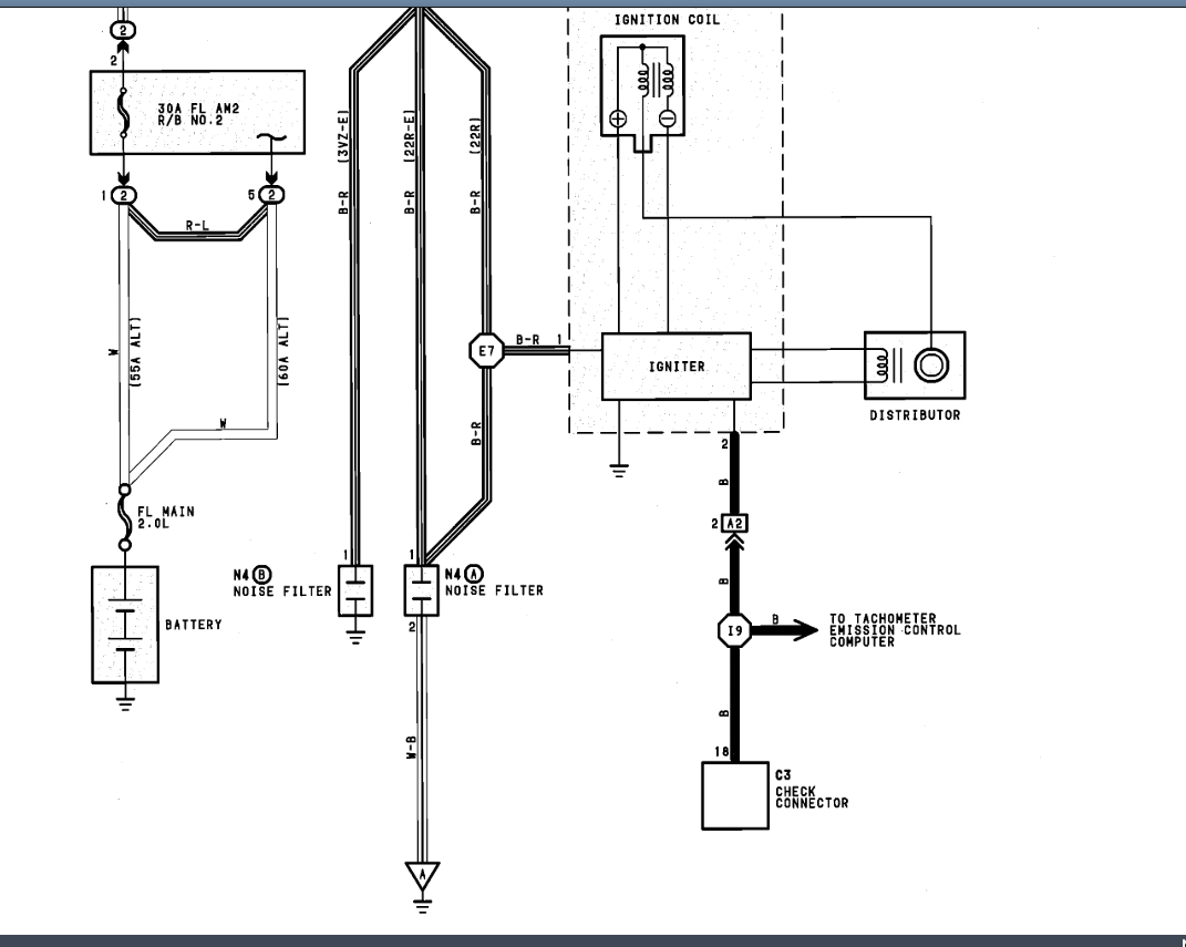

This could be a problem with your AM2[30A] fuse located in R/B 2 Fuse Box on the right hand side of the engine compartment. Here is a link below explaining how to do this:
In the diagrams down below I have included the starting circuit wiring diagrams and the R/B 2 diagrams for your vehicle for reference. Please check this fuse and get back to us with what you find out. We can go from there if needed.
Thanks,
Alex
