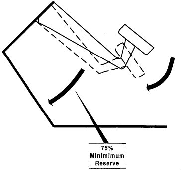

Check Brake Pedal Travel (Non-Antilock Brake Systems Only)
- Fully depress the brake pedal and check for the following:
- The pedal should have a 75% reserve.
Pedal Reserve Checks
- The pedal should be firm and not leak down.
Replace the master cylinder if all of the following conditions exist:
- The brake pedal is not firm with a 75% reserve and -
- There were no problems with any of the related systems and -
- The entire brake system has been bled and -
- The rear brakes are properly adjusted.
