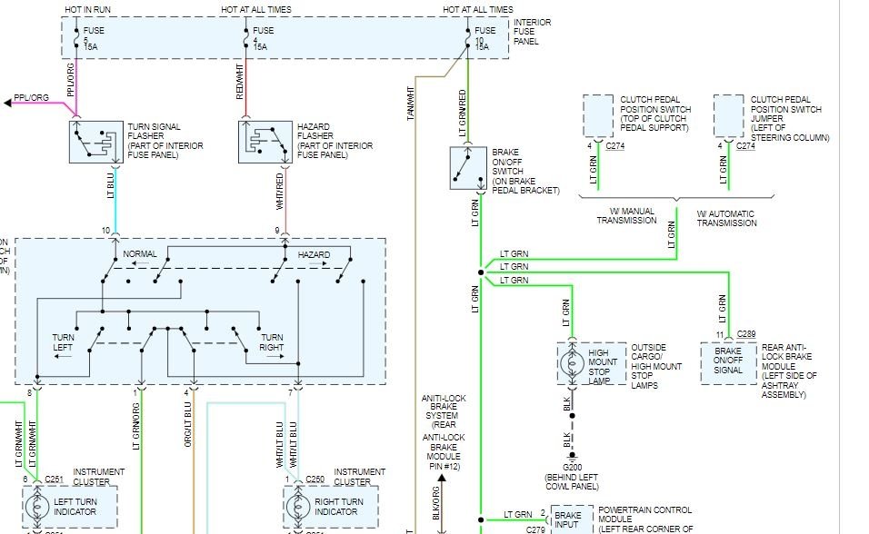

All my other lights works. Even my brake light on the cab, but by brake lights in the bed do not. We checked the fuses and some of the wiring but we cannot figure it out. Any idea? Truly appreciate it.
Sep 20, 2018 at 5:19 PM
Good morning.
If the brake light on the cab works, it seems like the switch is working.
You will need to go the brake light switch and verify power on both sides of the switch with the pedal depressed. Once that is done, then it is wiring to the back bed to the brake light sockets that needs to be checked for an open circuit.
