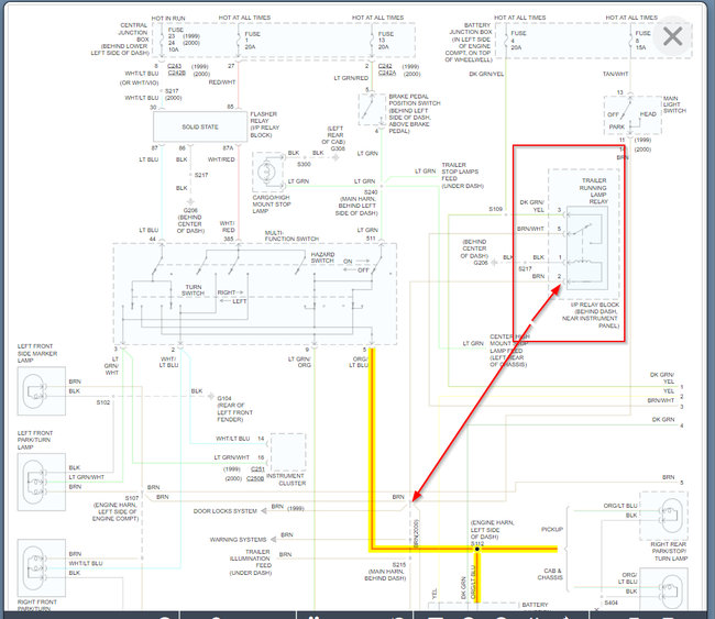

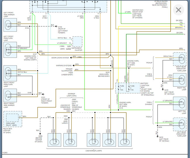

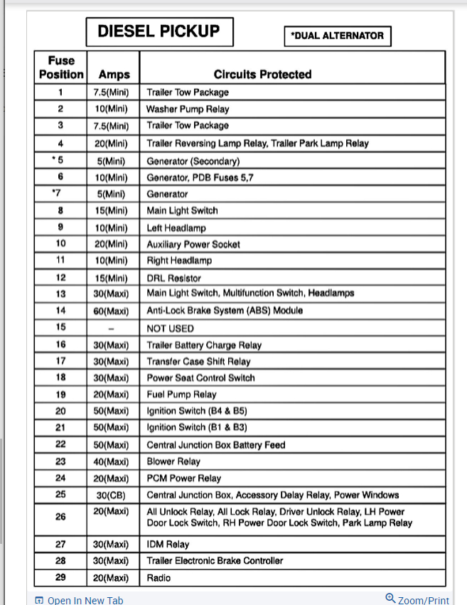

I've changed all the bulbs, checked all the connections and wires for the lights, and any and all fuses possibly related to them. But I still haven't got any back lights what so ever.
Oct 10, 2021 at 12:10 AM
When you say you have no back lights, do you mean you have no lights in the rear at all, including brake lights, backup lights, and turn signals? Or just no back up lamps.
Either way we are going to have to start with checking for voltage through the circuit.
Here are some guides that will help with this:

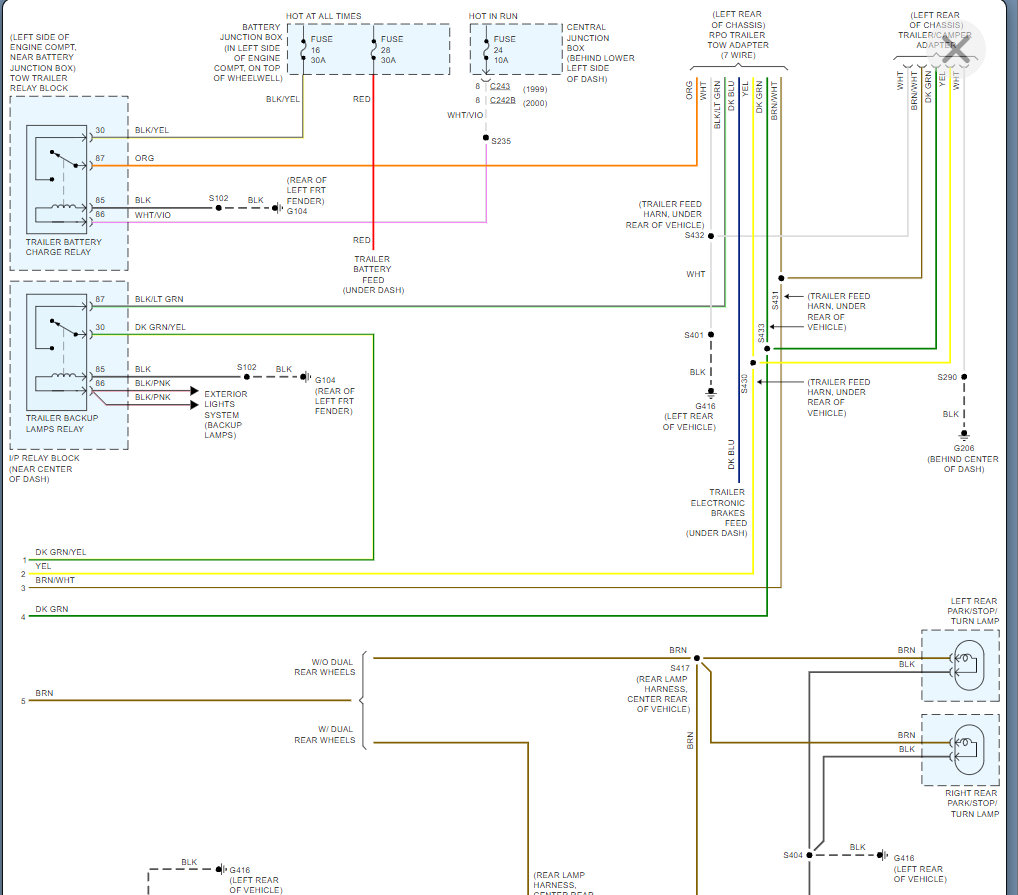

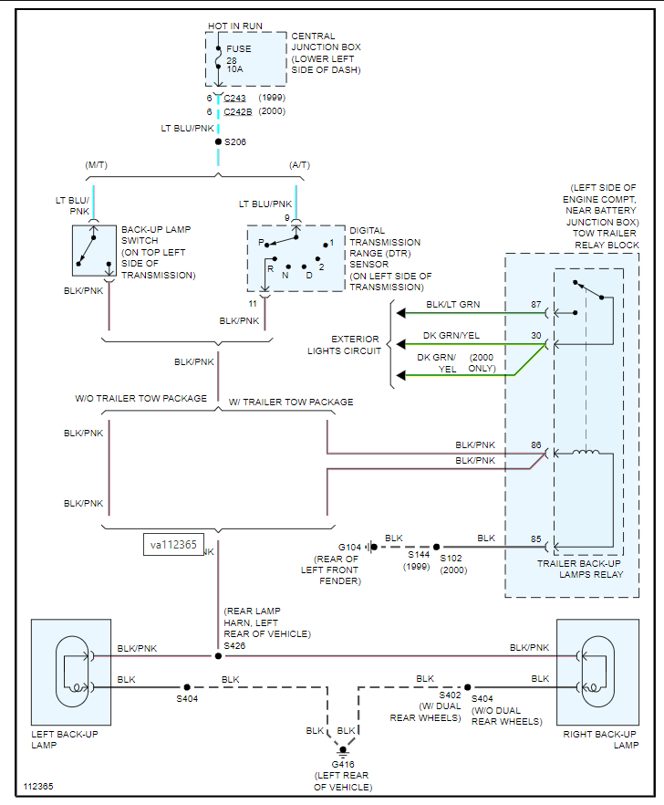

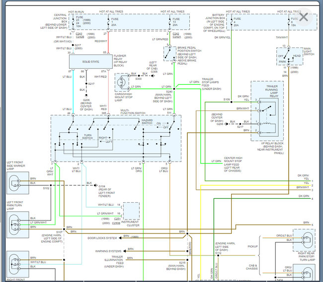

I am attaching the wiring diagrams for the reverse lights and exterior lights.
Since this is a manual transmission and if you are just missing the reverse lights then I suspect the backup lamp switch is the issue.
I would just check the voltage coming out of it or jump it and see if the lights come on.
I attached the info for the exterior lamps as well so let's clarify what is happening and then work through the correct wiring diagram.

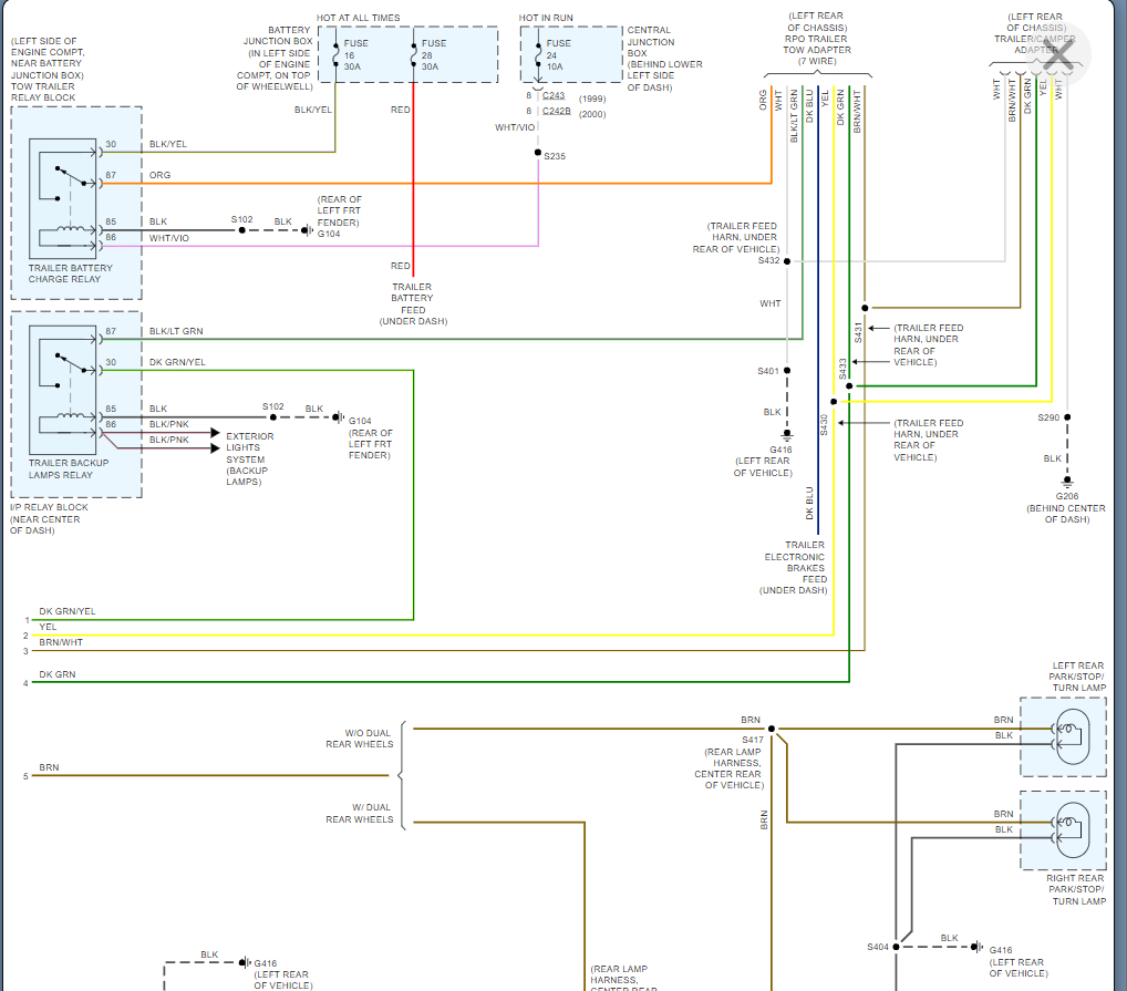

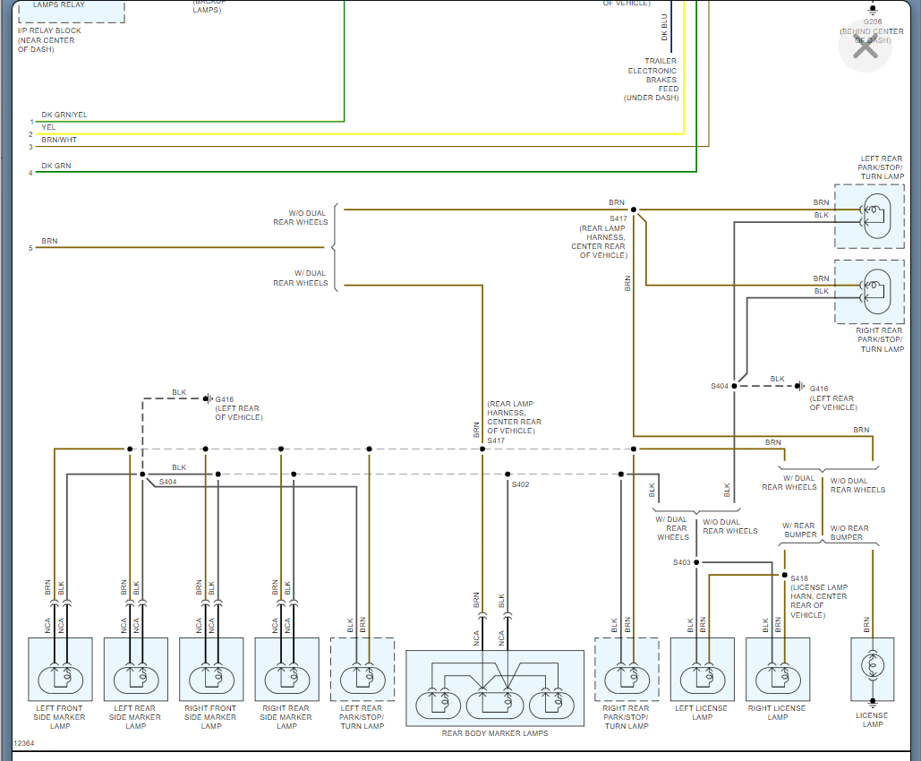

Okay, so everything works except my running lights. But I can hook up a trailer and the running lights work on just the trailer but still not on the truck.
Oct 11, 2021 at 1:01 AM
Okay. If the trailer running lights are working that is because they are run off their own relay and powered by the marker lights not the rear running lights.
More than likely the multifunction switch is failed.

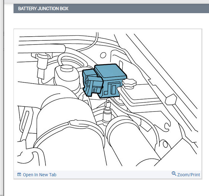

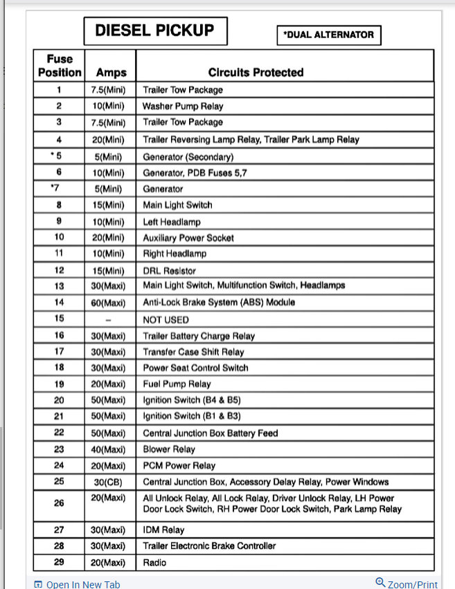

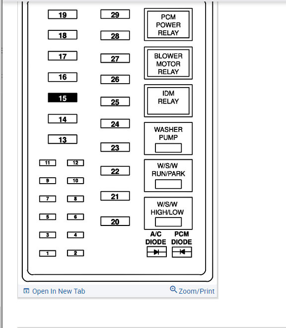

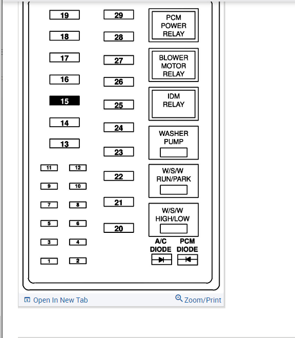

One easy way to check this is go to the battery junction box and check for power on both sides of fuses 1 and 3. These are for trailer tow package but not the running lights.
Basically, if you look at the wiring diagram, you will see the trailer running lamp relay and it is spliced into the marker light circuit on the brown wire.
Then you will see the rear running lamps come directly off the multifunction switch.
There is a splice off these circuits that goes to the fuses listed for the trailer so if we have power on both fuses on both sides of the fuse then the switch is not the issue.
Please let me know what you find. Thanks

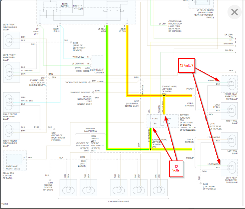

Okay, so I've got power on both fuses on both sides of the fuse. Now what do I do?
Oct 12, 2021 at 5:31 PM

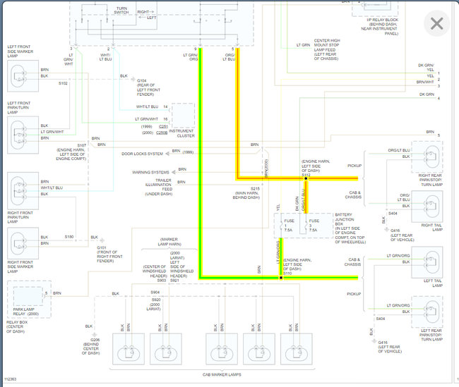

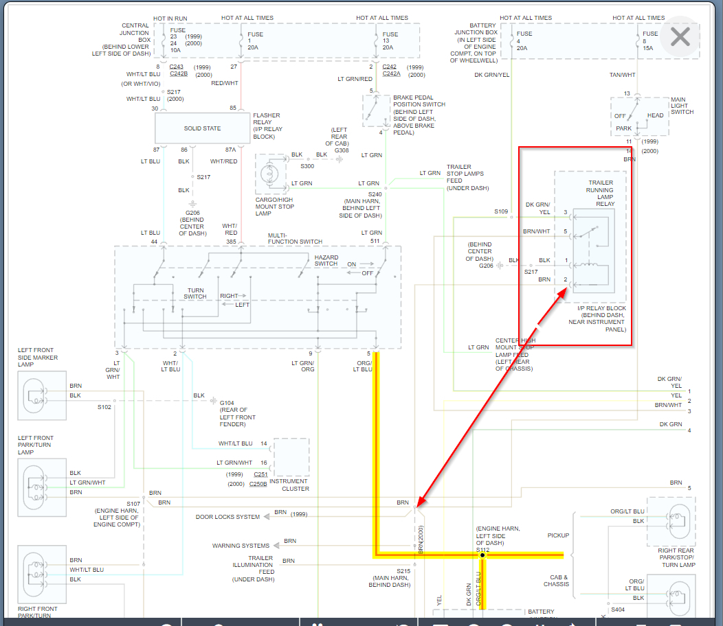

Okay. So, if you have voltage on both sides of these fuses then that means the switch is working sending voltage to the circuit. So now we need to find where it is going.
That means we need to turn the lights on and check voltage at the bulbs.
If we don't have 12-volts there, then we have a wiring issue from the splices to the rear lights.
Take a look at the diagram below. Let me know what you find.
Clearly, we can just run a wire if needed to re-establish the voltage when the switch is on.
