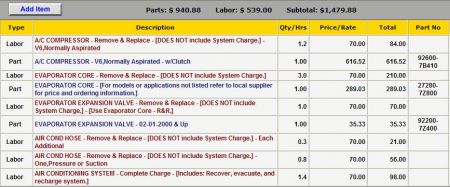

Local repair shop states that my A/C repair is $2300.00 (inc labor) ... they say that the compressor, evaporator, and expansion valve needs to be replaced. This includes a couple of A/C hoses as well, refrigerant, and associated shop costs. The estimate seems very excessive. Thank you in advance for your help. Any info on what the standard labor hours for this repair is would be appreciates as well. thanks! Karl

This price does seem to be an overprice for these repairs. An estimate is below including an average labor charge of $70 / hour. .
https://images.2carpros.com/forum/automotive_pictures/261618_Noname_867.jpg

I sincerely appreciate your quick reply! Now that I am armed with information, I can make a decent argument with the garage.
Thank You,
Karl
