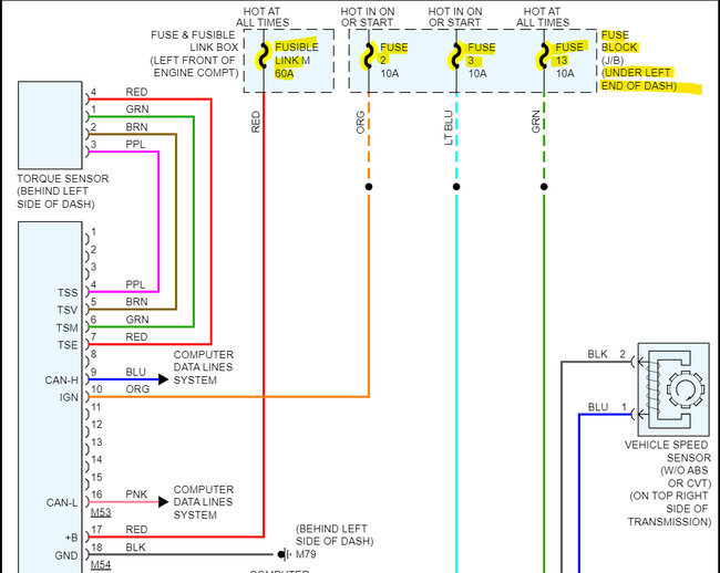

I went to the store last night and my car was just fine. I came out of the store, got in my car, turned on the switch and I saw the PS light on the dashboard and my car would not crank. I had no dash lights or anything. So, I took the battery out and charged it up thinking that would help. Well, that isn't my problem, my battery is fine. Still having the same problem. What is going on with my car??
Jan 16, 2023 at 12:10 AM
AL514
  • 5,641 POSTS

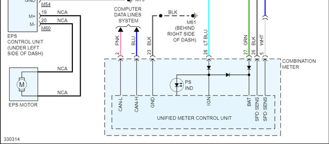

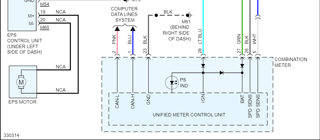

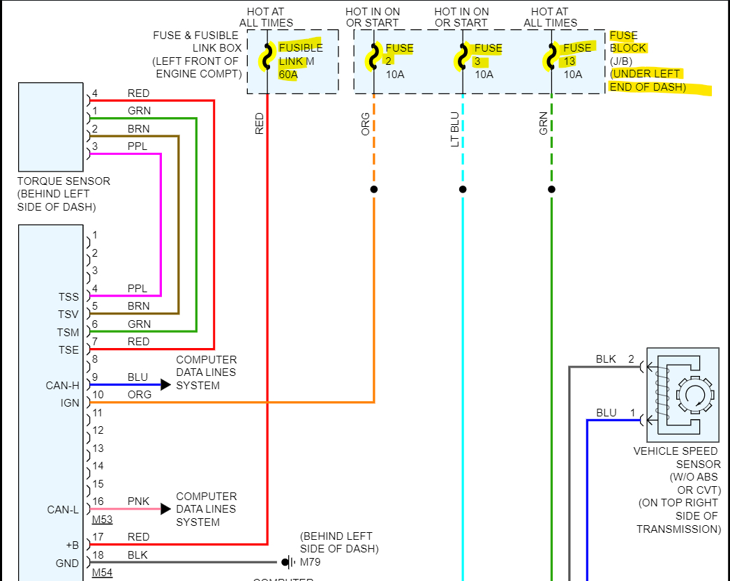

Hello, it sounds like there may be an issue with the electronic power steering or possibly the steering wheel lock solenoid has failed. Have you noticed any issues with the steering wheel lately? Any odd noises or difficult to turn sometimes? There will most likely also be a diagnostic trouble code stored in the power steering control module. So having a full system scan done will help identify any trouble areas. Service information is not very helpful concerning this warning light. But it's something important enough that it's preventing the vehicle from starting. I'll post some fuses you can check, but if they are all okay, it will need to go in to be checked out. The electronic power steering is a pretty complex system. It's on the computer network in the vehicle. It's also a huge load on the electrical system, since it's not a fluid-based power steering anymore. It's an electric motor that assists with steering now. Having a full system scan for any diagnostic trouble codes will turn up something. It will also show any other trouble areas you may not be aware of. But check these fuses first.

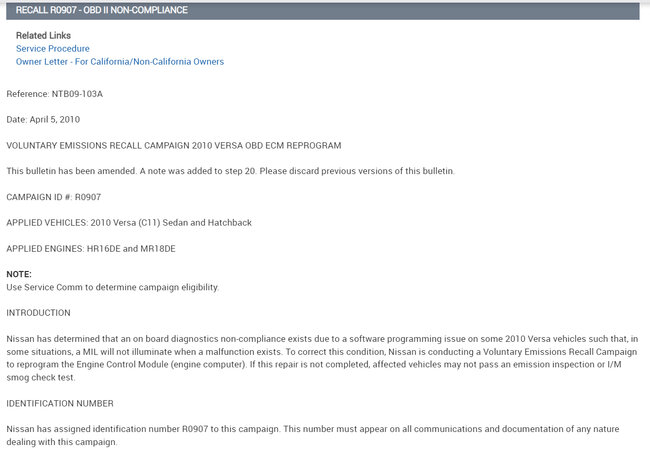

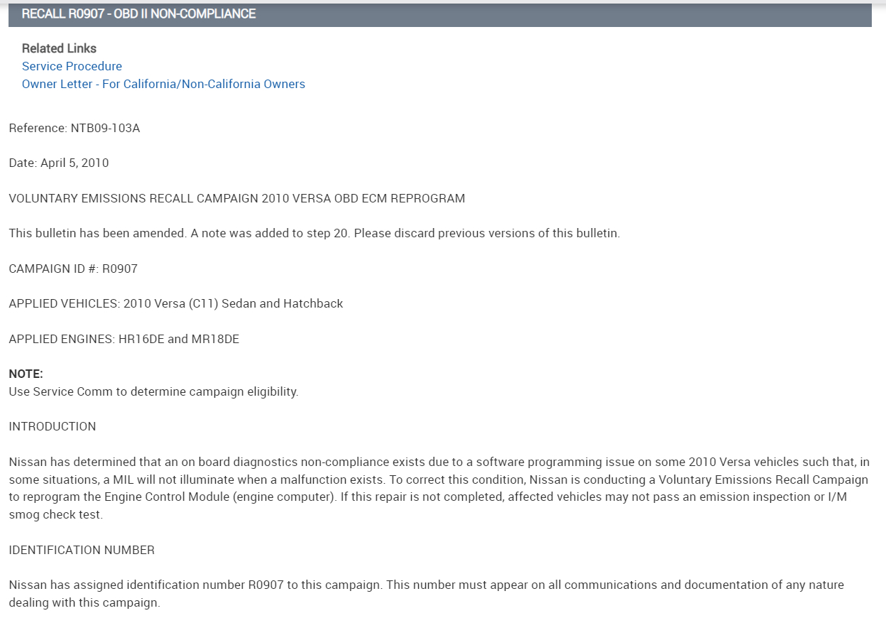

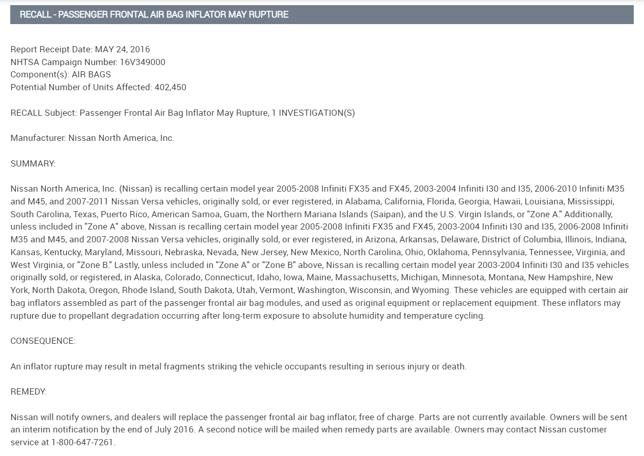

I also see quite a few Recalls and Technical Service Bulletins on the Air bag system (SRS). So that's something else to have checked out when you bring it in. Most recalls are done for free depending on the recall.
There is also a recall on the obd2 system which is responsible for illuminating the check engine light when there is a problem. This recall is a software update to the engine computer to make sure that it's turning on the check engine light when it should. Seems to be a large enough issue to post a Recall for.
