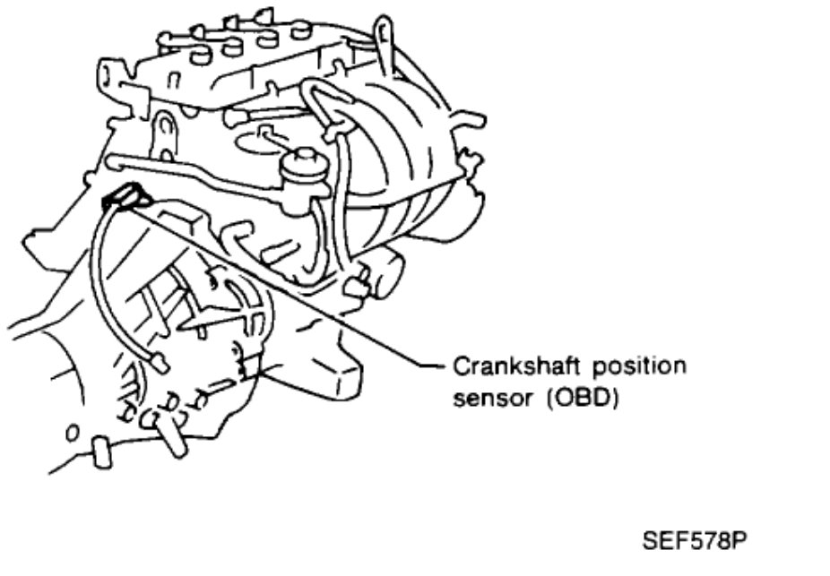

i just failed a smok check because of the crankshaft position sensor A circuit. can you please tell me what that means and how to fix it. thank you
Sep 27, 2008 at 9:21 AM
  • 54,861 POSTS

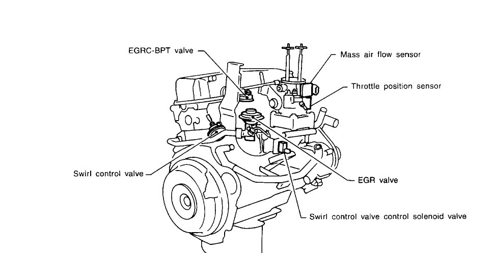

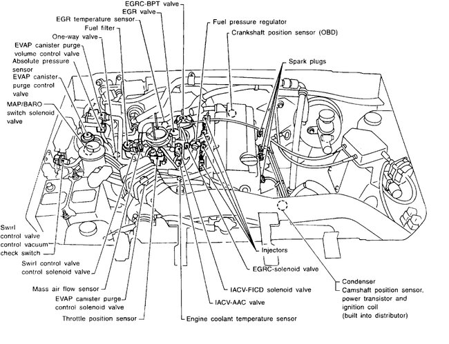

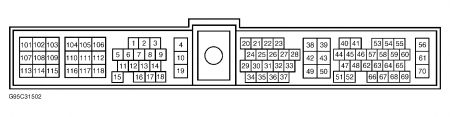

It sounds like one of two things has happened, either the sensor is unplugged or it is shorted. Here is a guide to help you see what you are in for when checking and changing the sensor which is located at the rear of the engine (diagram below). https://www.2carpros.com/articles/crankshaft-angle-sensor-replacement From the book: CRANKSHAFT POSITION (CKP) SENSOR 1. Check Ground Circuit - Turn ignition off. Disconnect CKP sensor harness connector . Using an ohmmeter, check continuity between CKP sensor harness connector terminal No. 2 (Green wire) and ground. If no continuity exists, repair open in Green wire. If continuity exists, go to next step. 2. Check Input Signal Circuit - Leave ignition off. Disconnect ECM harness connector. Using an ohmmeter, check continuity between ECM harness connect or terminal No. 53 and CKP sensor harness connector terminal No. 1 (Red wire). If no continuity exists, repair open in Red wire. If continuity exists, go to next step. 3. Check Component - Verify flywheel gear teeth are not damaged. If chipping or damage is observed, replace flywheel or drive plate. Disconnect and remove CKP sensor. Loosen sensor fixing bolt. With ambient temperature about 68 °F (20 °C), measure resistance between CKP sensor terminals. Resistance should be 167-204 ohms. If resistance is as specified, go to next step. If resistance is not as specified, replace CKP sensor. 4.Disconnect ECM wiring harness connector. Check connector pins for damage or corrosion. Check all circuit connectors for clean, tight fit and service if necessary. If fault is still present, replace CKP sensor.
https://images.2carpros.com/forum/automotive_pictures/62217_nisc_1.jpg
https://images.2carpros.com/forum/automotive_pictures/62217_nisb_2.jpg
Larger diagrams (BELOW) Please let us know what happens so it will help others. Cheers, Ken
