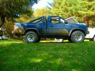

ok heres my question i have and 88 nissan pickup 2.4 nap-z 4x4 5 speed with approx 193000 on the odo, when i put my truck in reverse and disengage the clutch it kicks out of reverse but not before it grinds and like it sounds like the gear it not meshing or something it doesnt do it in any other gear though other than that it doesnt have any problems but i t wont let me back up or very little i dont know what to do to fix it i am very mechanically inclined but it finding the time to do it which is why i would rather know what im looking at to fix any help would be great thanks matt
https://images.2carpros.com/forum/automotive_pictures/77461_dscf1568_1.jpg
Sep 10, 2019 at 9:43 AM (Merged)
KAMO
  • 47 POSTS
Check your fluid, chance are that isnt the problem but, one possibility is your slave cylander is leaking. Another cause is a bad clutch. Check for the leak first, then Id say do a, or have some one do a clutch inspection.
