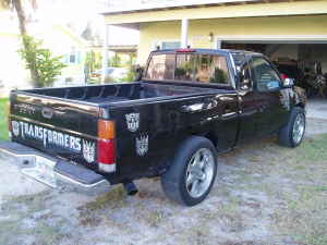

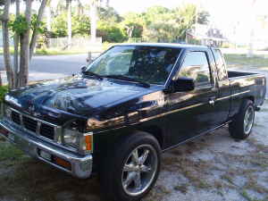

steering wheel is side ways or vertical but drives straight when it should be horizontal like a normal steering wheel. im about to buy this truck but i dont know, it also has rims and tires that look a little too big for it but dont affect its driving, could that be it? or is it something else, plus i see that the cover underneath the steering wheel is missin like it might have been tampered with is that possible too? what do u think tell me your ideas..

you mean it is vertical but the vehicle is still driving straight or you mean when parked it goes to the vertical spot but when driving you have to hold it horizontal to make it go straight? if so then there is big issue with the front end . could be something bent or just misaligned such as tie rods. would definitely have that checked out before buying the vehicle.

the steering wheel is vertical when parked and the wheels are straight at the same time. and when i drive i hold it vertical and it drives straight, basically the only time its horizontal like a normal car is when i take a left turn or a long right turn lol.. ideas?? i mean itr drives smooth, i just think it has too big of. rims and tires for the vehicle.?? either that or something is messed up. but i do wana buy this vehicle and fix it i work at autozone and i can get parts fairly cheap ya know?. ideas please thanks

ok, the steering wheel may have been removed at some point and when it was reinstalled it was not lined up properly. what size wheels is on it?

the steering wheel might have been replaced because now that u mention it, below the steering wheel the plastic cover under neath is missing like some one tampered with it or removed it, but why would someone put it on sideways lol? and if that's the case is it hard to reinstall the steering wheel correctly? or will i have to get a new alignment and everything too? the tires are wide and big for the car i think, also the rims are like 18's pretty sure, but the tires are definitely wider than normal nissan pickup tires. heres a picture of what im getting, i definitely want this truck too its what ive been looking for, and your the best man your helping me out a lot and i appreciate it. i will make a donation soon i promise.

those aftermarket wheels/tires will effect the ride but shouldn't effect the steering any. you will want to have the front end aligned before trying the steering wheel removal, because if the wheel is on correct but it's just misaligned then removing and replacing it can actually do more damage than good. front end alignments usually don't cost that much, probably $30 or $40. I wouldn't let this stop you from buying truck if you like it. It's not that big of an issue, really just a misalignment problem in one area or another.

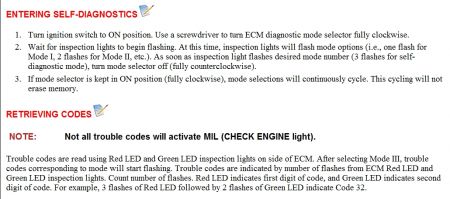

i cant get an obd1 there expensive and -95-below is obd1 and i would have to go to a mechanic to get obd1 checked, unless u think since the plastic steering column dash underneath the steering wheel is gone that someone could have disconnected the obd1 completely and tuned off the check engine light completely??? that would explain why i dont see a check engine light.. if thats true. ideas once again lol. ohh by the way the body and everything else is great on this truck, its a little project but thats okay i think. what u think??

so when you first turn key you don't see the engine light on? if not then the bulb is either blown or maybe even taken out by a previous owner. it will have to be replaced before you can retrieve trouble codes. you don't need scan tool to retrieve the codes either. just follow the steps below to get the codes..
