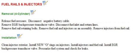

Were is the fuel injector found? so I can replace it with new one? and how many injectors are there?

One per clyinder..
https://images.2carpros.com/forum/automotive_pictures/261618_Noname_1613.jpg
