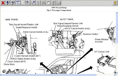

have a flasher for the truck . i look in the book for the truck can't find were i put in the new flasher
Aug 3, 2008 at 11:27 AM
  • 75,992 POSTS
Sir, its located under left side of dash see below
https://images.2carpros.com/forum/automotive_pictures/12900_flasher_18.jpg

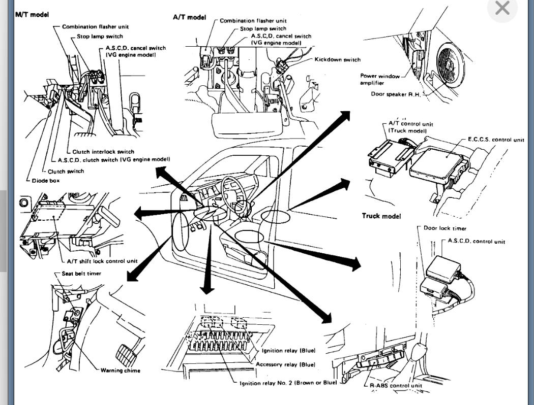

Where the heck is the turn signal relay located in my 1991 Nissan basic 4-cyl pickup truck? Can't use my truck without turn signals (Can't afford a police ticket) but I need transportation direly! Anyone with an answer for me? The sooner the better, PLEASE!!!
Aug 27, 2019 at 11:25 AM (Merged)
  • 75,992 POSTS
[quote:0c10b2431c="Guy1969"]Help PLEASE!
Where the heck is the turn signal relay located in my 1991 Nissan basic 4-cyl pickup truck? Can't use my truck without turn signals (Can't afford a police ticket) but I need transportation direly! Anyone with an answer for me? The sooner the better, PLEASE!!![/quote:0c10b2431c]
Under the left side of dash-right besides the brake/stop light switch.
Good Luck

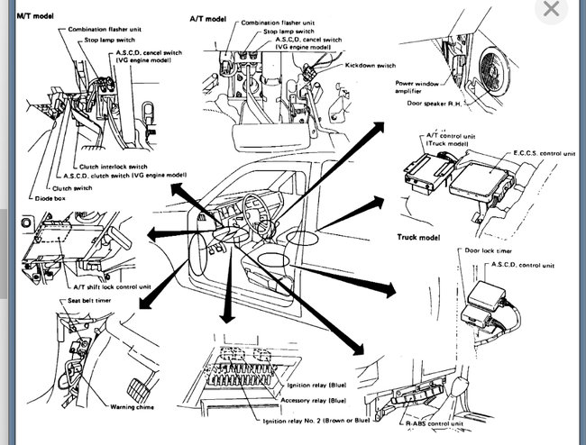

This relay is on the fuse block on the left side of the dash as everyone is stating. However, here are a couple more pieces of info on this.
Here is a guide that will help testing fuses and relays:
Plus, I am attaching the location of this below. Please run through this and let us know if you have other issues.
