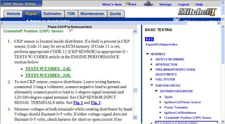

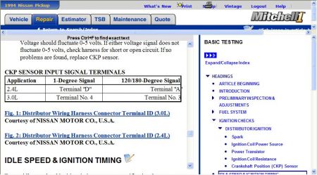

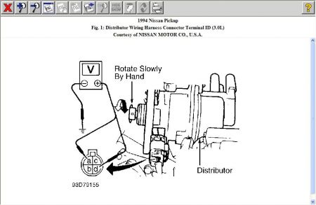

about 2 months ago i had a failure to start after brief stop. I tapped on coil and it started and did this 3 times. new coil has been fine for 4 wks, then again it does this, tap coil starts, coil tests well as does the IC unit .I'm a former electronic tech and a decent mechanic, all wiring and voltages are fine and clean, my haynes manual is a little confusing . do i next go through the ecu flashes routine. i'm praying its not in that as i am broke, thank you ken and a donation will be on its way in short order if you can help me out thanks again.
May 2, 2008 at 1:55 PM
  • 75,992 POSTS
Check for battery voltage at black and white wire at coil and the blue wire at the power transistor. Also test the crankshaft position sensor see below
