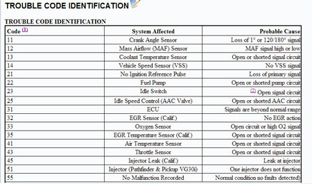

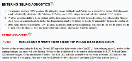

I was not getting any fire to the spark plugs. I was not even getting any fire from the coil. I ended up replacing the plugs, plug wires, distributor, distributor cap, rotor, coil, and coil module. I still am not getting any fire. What do I do?
Feb 19, 2008 at 2:42 PM
MERLIN2021
  • 17,250 POSTS
Locate the ECCS unit under the passenger seat and perform code reading as specified here: Write codes down and post here, I will get the appropriate tests for the results!
https://images.2carpros.com/forum/automotive_pictures/62217_Code_Reading_2.jpg
https://images.2carpros.com/forum/automotive_pictures/62217_Code_Reading1_2.jpg
