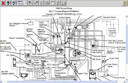

I'm looking for a diagram of the vacuum lines for this engine. Upon inspection, some vacuum lines are attached and some are'nt. Do you have such a diagram ? Right now the engine does not idle smoothly. It goes to fast idle to almost dyng but manages to keep running. Thank you for your help!!

https://images.2carpros.com/forum/automotive_pictures/12900_nissan_vac_hose_diagram_1.jpg
