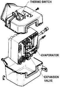

how can i get to the heater coil from under hood or through the dash
Feb 29, 2008 at 8:25 AM
FAIRRACING31
  • 150 POSTS
Remove the heater core hose's from under the hood at firewall. Heater core is removed from under the dash Remove the heater core assembly Remove the screws and clips and separate the heater case halves Slide out the heater core Install the heater core in the heater case and close the two halves. Install the clips Install the heater assembly
