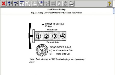

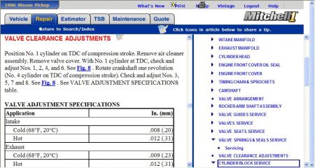

iam not gettin it right the clearance .i am doing it with cold engine.how much is the clearance with cold engine.i have 8 plugswire ,which is # one wire intake or exhaust and the firing order> thank you.
Mar 28, 2008 at 11:20 AM
  • CAR REPAIR CONTRIBUTOR
  • 75,992 POSTS
Today is your lucky day-here it is
https://images.2carpros.com/forum/automotive_pictures/12900_v1_1.jpg
https://images.2carpros.com/forum/automotive_pictures/12900_v2_1.jpg
