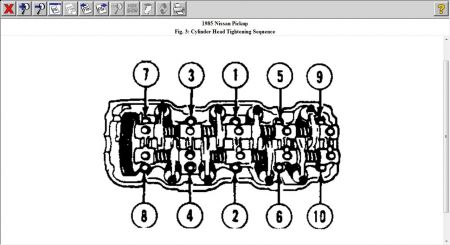

I bought a 1985 nissan truck that needs the head replaced I have a rebuilt head I was wondering if you could tell me the torque specks on the head and sequience
Apr 11, 2009 at 6:37 AM
  • 75,992 POSTS
Torque 58-65ft lbs
https://images.2carpros.com/forum/automotive_pictures/12900_head_4.jpg
