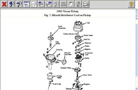

HOW DO YOU KNOW THE DIFFERENCE IN AN INTAKE IGNITION MODULE AND A EXHAUST IGNITION MODULE? THE ONE I NEED TO REPAIR IS CLOSE TO THE DISTRIBUTOR CAP.

Is this the Napz Z24?
If you're referring this module as intake/exhaust the proper name for it is ignition rotor- it only has 1 ignition control module also called the IC ignition unit. The outside close to the cap is the intake side.

NapZ 24 Distributor
