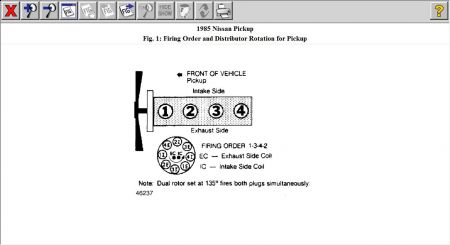

I would like to know the firing order?
May 19, 2010 at 12:54 PM
  • 75,992 POSTS
https://images.2carpros.com/forum/automotive_pictures/12900_fo_121.jpg
May 19, 2010 at 1:55 PM
2CP-ARCHIVES
  • 4,540 POSTS

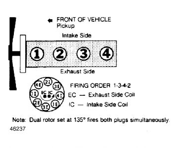

1985 Nissan, pickup. While changing my spark plug wires, I accidentally knocked off the wires on the distributor cap and do not have a wire diagram to replace them. Although it is a 4 cyl., it has 8 wires. Can you help me find the right sequence?
Jun 5, 2019 at 12:22 PM (Merged)
2CP-ARCHIVES
  • 4,540 POSTS
The distributor rotates counter clockwise. There is a reference to intake side and exhaust side: 2i for cylinder #2 intake side and 2e for exhaust side. Starting from the top and going counter clockwise: 2i, 4e 1i, 2e, 3i, 1e, 4i, and 3e.
