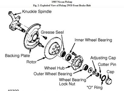

1985 Nissan Truck changing rotors / wheel bearings front
1985 NISSAN TRUCK
NDNZ
Brakes problem
1985 Nissan Truck 4 cyl Two Wheel Drive Manual 180.00 miles
i`m goin 2 change my front brakes/rotors and wheel bearings saw video but didnt include whell bearing nor was it the kind of rotors that i hav {not seperate from a hub] all 1 peice,,,any video on that kind and ur help is nery appreciated thk u and its my 1st time here not sure wat "minimum" donation would b

Hi ndnz, Thank you for the donation. Whatever amount is appreciate. Is your front hub as shown in the diagram?
https://images.2carpros.com/forum/automotive_pictures/192750_BrakeFrtHub85Pickup_1.jpg
The bearing cones would have to be punched out and when installing, it has to be adjusted and not overtightened.
