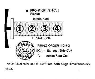

Engine Performance problem
1985 Nissan Truck 4 cyl Two Wheel Drive Automatic
i have 1985 nissan king cab truck with a nissan "Z" 4 cylinder engine, i need to the firing order, and when looking at the distribter which wirer should i start from?

https://images.2carpros.com/forum/automotive_pictures/12900_fo1_18.jpg
