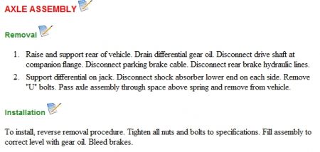

1984 Nissan Truck 4 cyl Two Wheel Drive Manual
i am trying to remove the rear axles so i can inspect the diff head. can you please tell me how to remove them. thank you

https://images.2carpros.com/forum/automotive_pictures/261618_Noname_2377.jpg
