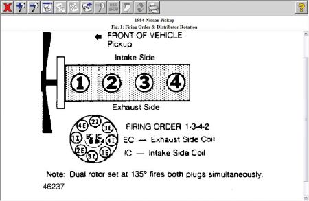

I need a diagram of the cylinder location and distributor rotation Please.
Sunday, December 23rd, 2007 AT 1:22 PM
MECHANIC
75,992 POSTS
See below
