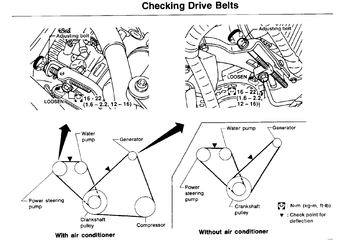

I have a 97 nissan sentra GXE. I recently had starter replaced. Then the car was at the auto body shop for three days for repair to front right bumper. When acceleration is applied, there is a squeaking noise coming from the engine. All belts are at least 1yr old.
Can you please tell me what's wrong? thank you

So this engine does not have a spring loaded tensioner so the belts need to be tightened. Here is how the job is done. Check out the images (below). Please upload pictures or videos in your response of any problems so we can see what to help you with.
