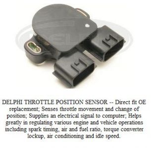

Once in a great while, after starting my engine, I put it in drive and pressing the gas pedal does nothing. The engine does not move, only idles, its like the throttle is not working. My yellow light SERVICE ENGINE SOON (something like that) was on. My mechanic ran the diagnostic, which says P2135 code, something about T/P sensor. But because it doesn't happen during diagnostic, hard to determine cause. Appreciate any advice on whats wrong as its a little scary to drive my car now. Regards, sags

If you are getting this TPI fault indication, there is a problem with the TPI, I would be getting it changed before it lets you down and strands you somewhere.

The TPI is the sensor that tell the ECU what throttle percentage is applied, this is vital information required for the ECU to establish correct air. Fuel parameters for any given throttle position, as for cost, the it will only take about 1/2hr to fit and a s for cost of the item, that I can't help you with as I am in Australia any my pricing will not be any good for you.

Hi there,
A TPI should cost around $130. US retail, see pic as well.
https://www.2carpros.com/forum/automotive_pictures/61395_TPI_1.jpg
