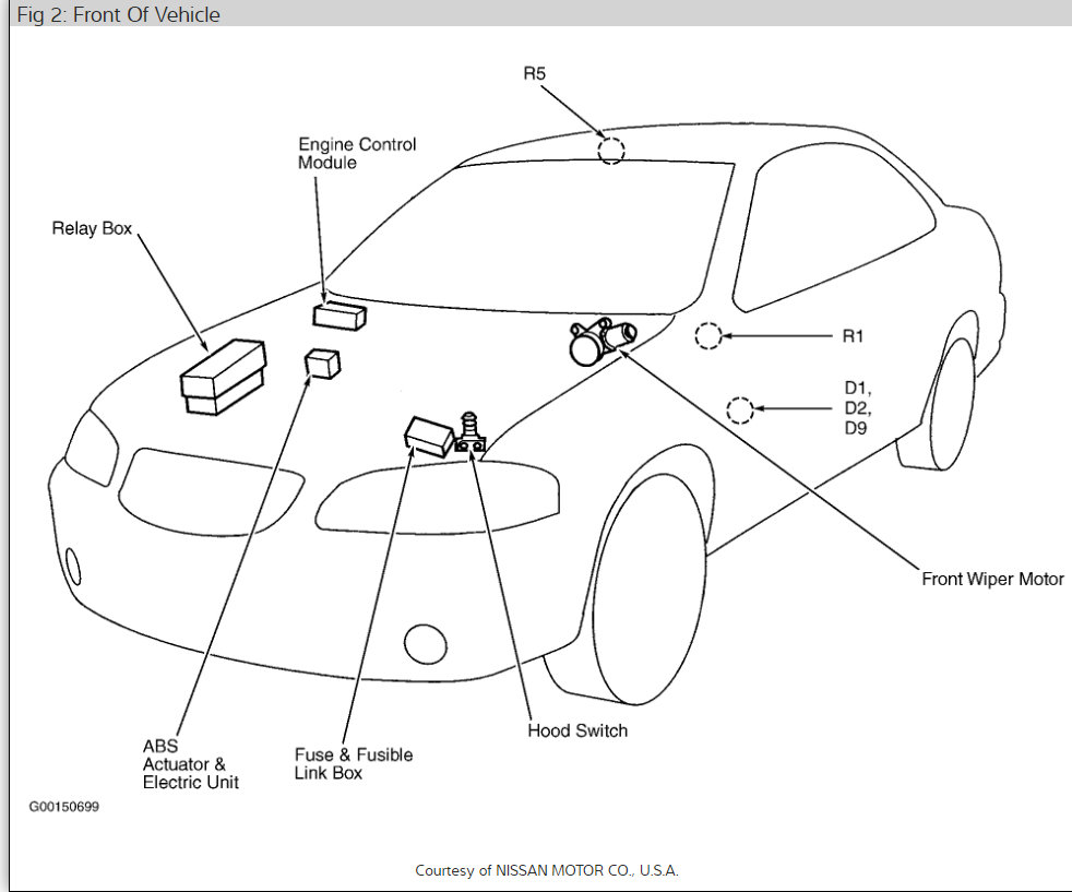

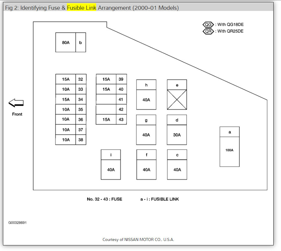

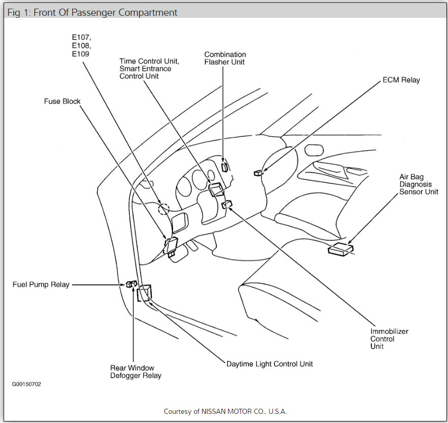

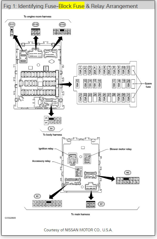

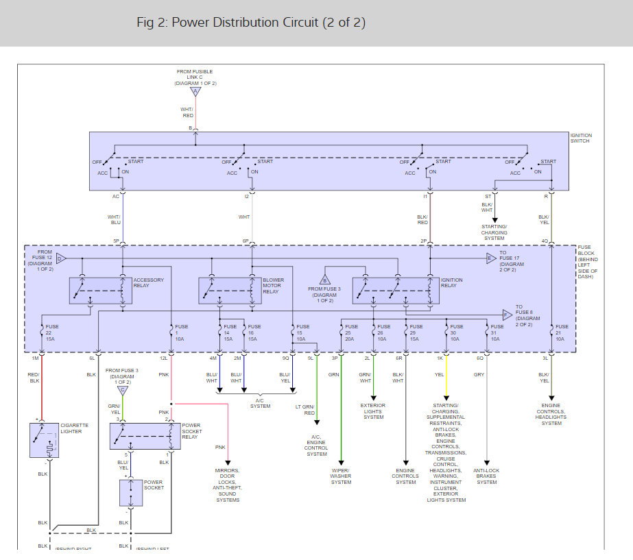

I just bought this car and am looking to get fuse and relay diagrams as the cover is missing off the fuse box and the owner's manual I downloaded today has no mention of where and what amperage the fuses should be and where they should be. I have searched the internet all day. I tried automotive search engines, automotive forums, every little trick I could think of. To no avail. I found a couple of pics but either wrong Nissan model or wrong year. I don't have any credit/debit bank cards (my choice) so I can't get answers unless I pay. Boy whatever happened to just helping people out like the good ole days. Everythings about money now even advice.
Well thank anyone who can help me. If I can be of any help to you I will gladly give it free.
girlrocker
Apr 16, 2010 at 11:49 AM
BLUELIGHTNIN6
  • 16,542 POSTS

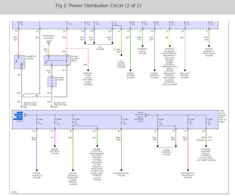

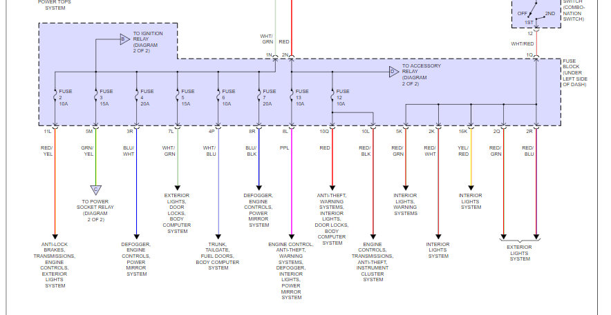

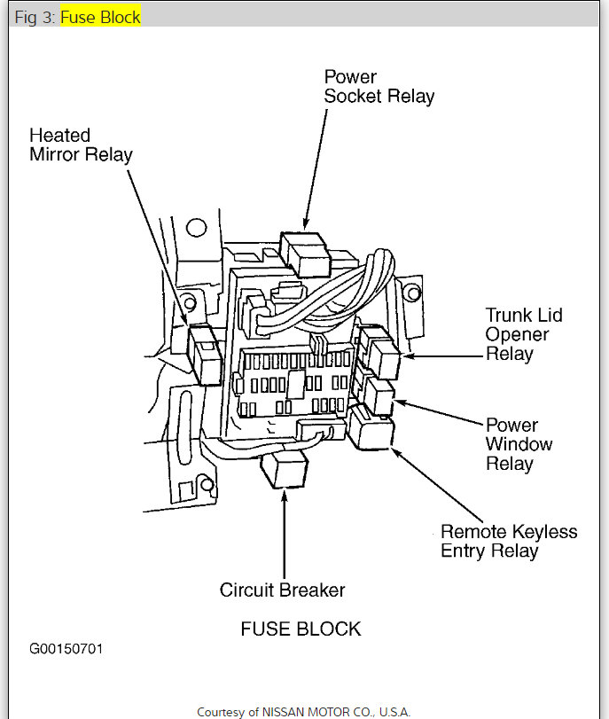

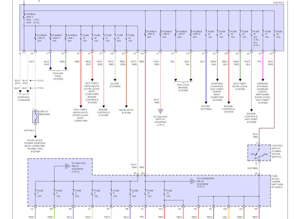

Here are two guides to help you test the relay and fuses of the fuse panel. Also there are diagrams below that show all the fuse and relay locations. You will need to look at the power distribution diagrams to see what fuse does what.
and
Cheers
