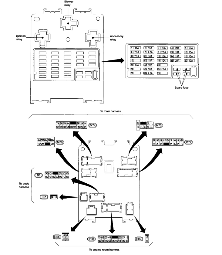

1999 NISSAN SENTRA
BECCIRAHEN

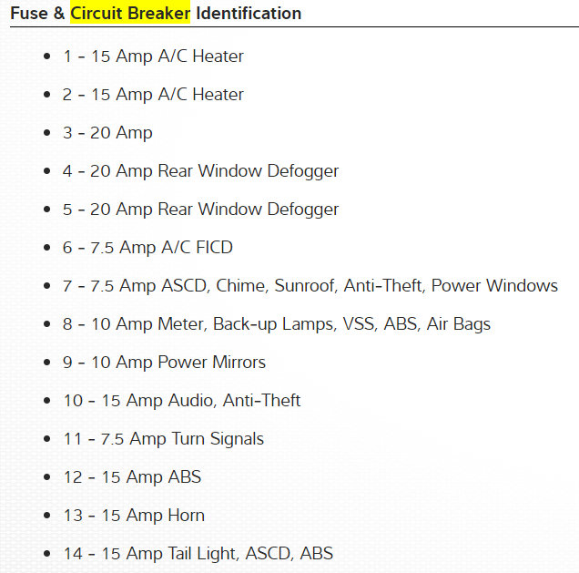

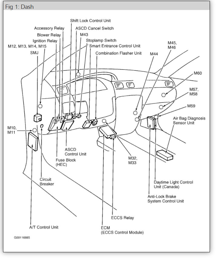

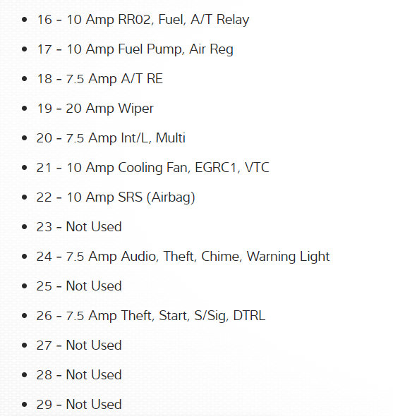

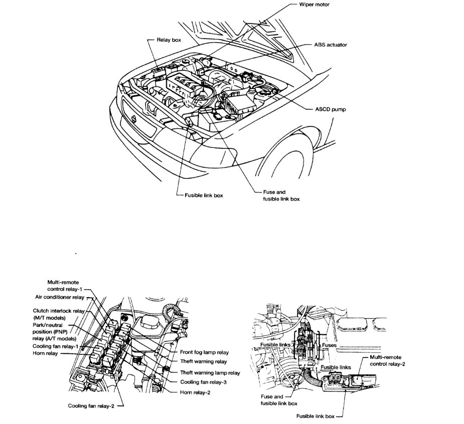

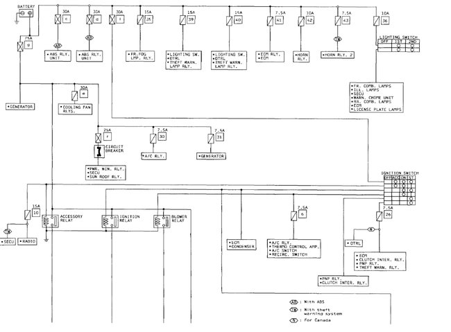

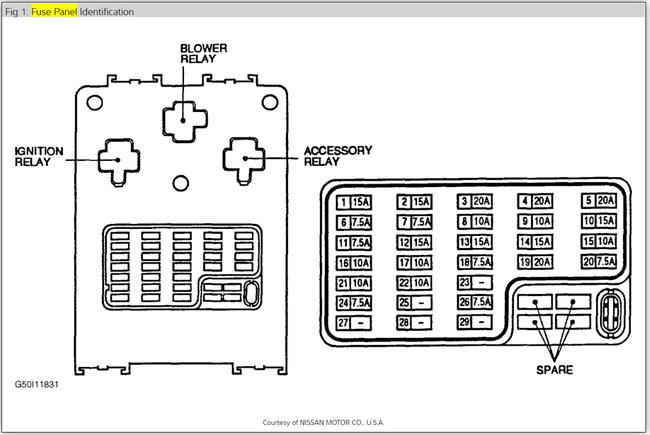

I have lost the cover for my interior fuse panel and I am in need of the information that is on the cover for the fuses. i need to know what and where the fuses go PLEASE anyone with that info PLEASE help me. THANK YOU VERY MUCH
Jun 24, 2009 at 12:54 PM
BLUELIGHTNIN6
  • 16,542 POSTS
Here is a guide to help you check the fuses with the fuse panel location and identification in the diagrams below.
Check out the diagrams (Below). Please let us know if you need anything else to get the problem fixed

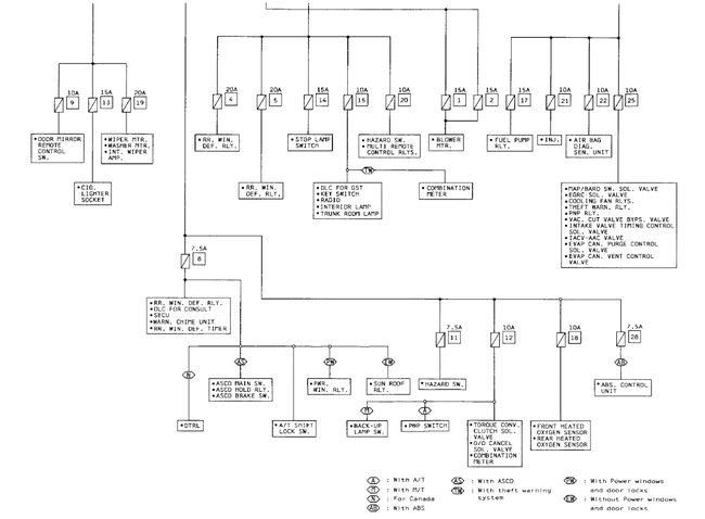

need help locating the radio fuse on a nissan sentra 95
Sep 5, 2019 at 11:02 AM (Merged)
  • 75,992 POSTS
Here is a guide to help you check for power at the fuse and the fuse location and specifications below. Check at no24 -7.5 amps
