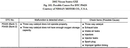

My sentra has very big problem starting. It has a code of p0430, p0300, and I just recently got a code of p0174. I need help. I don't really know where to start and check. I've been told that the cat doesn't usually go bad. I want to check my o2 sensors but don't know how. Please help! What can I check or what can be the problem?

The chart shows possible causes for all the 3 codes and they are most likely to be related. The MAF is known to cause such codes and difficult starting, I would suggest checking/testing that first.
https://www.2carpros.com/forum/automotive_pictures/192750_DTCP0171_174_02SentraFig58_1.jpg
https://www.2carpros.com/forum/automotive_pictures/192750_DTCP0300_02SentraFig75_1.jpg
https://www.2carpros.com/forum/automotive_pictures/192750_DTCP0420_430_02SentraFig101_1.jpg
