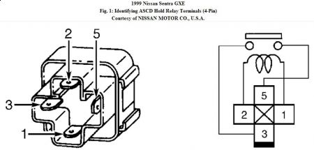

https://images.2carpros.com/forum/automotive_pictures/192750_ASCDHoldRelay99Sentra4pinFig01_1.jpg

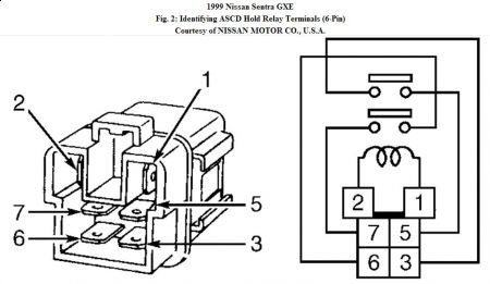

2. Ensure continuity is not present between relay terminals No. 3 and 5. Replace relay if continuity is present. If continuity is not present, go to next step. 3. Energize relay by connecting 12-volt source across relay terminals No. 1 and 2. With relay energized, ensure continuity is present between relay terminals No. 3 and 5. Replace relay if continuity is not as specified. ASCD Hold Relay (6-Pin) 1. Remove relay. Using DVOM, ensure continuity is present between relay terminals No. 1 and 2. See Fig. 2 . Replace relay if continuity is not present. If continuity is present, go to next step.
https://images.2carpros.com/forum/automotive_pictures/192750_ASCDHoldRelay99Sentra6pinFig02_1.jpg
2. Ensure continuity is not present between relay terminals No. 3 and 5, and between terminals No. 6 and 7. Replace relay if continuity is present. If continuity is not present, go to next step. 3. Energize relay by connecting 12-volt source across relay terminals No. 1 and 2. With relay energized, ensure continuity is present between relay terminals No. 3 and 5, and between terminals No. 6 and 7. Replace relay if continuity is not as specified. We shalll start with this. If there is anything else that you require, let me know.

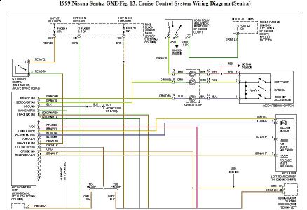

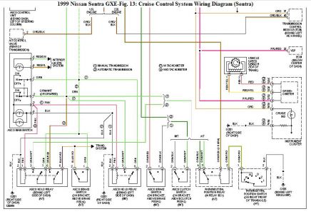

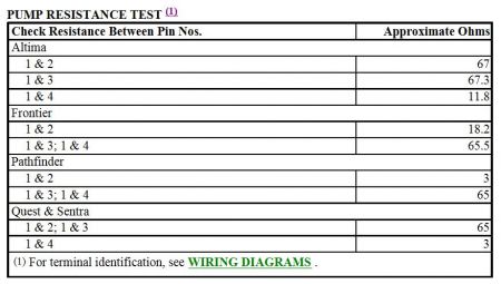

Hi LeAnn, Sorry I am not able to recommed any scanner for cruise control checks. Most scanners would handle engine checks but cruise control, transmission and ABS are another caetgory so the scanners might be rather pricey. I have the testing procedures for the Pump circuit and VSS checks here for you. PUMP CIRCUIT CHECK Disconnect ASCD pump harness connector. Using DVOM, measure resistance between specified pump terminals. See PUMP RESISTANCE TEST table. Replace pump if resistance is not as specified. If resistance is as specified, check for open or short in wiring harness between pump and ASCD control unit. See WIRING DIAGRAMS . Repair as necessary.
https://images.2carpros.com/forum/automotive_pictures/192750_PumpCircuitTest99Sentra_1.jpg
https://images.2carpros.com/forum/automotive_pictures/192750_CruiseControlSchematicSentraFig13a_1.jpg
https://images.2carpros.com/forum/automotive_pictures/192750_CruiseControlSchematicSentraFig13b_1.jpg
